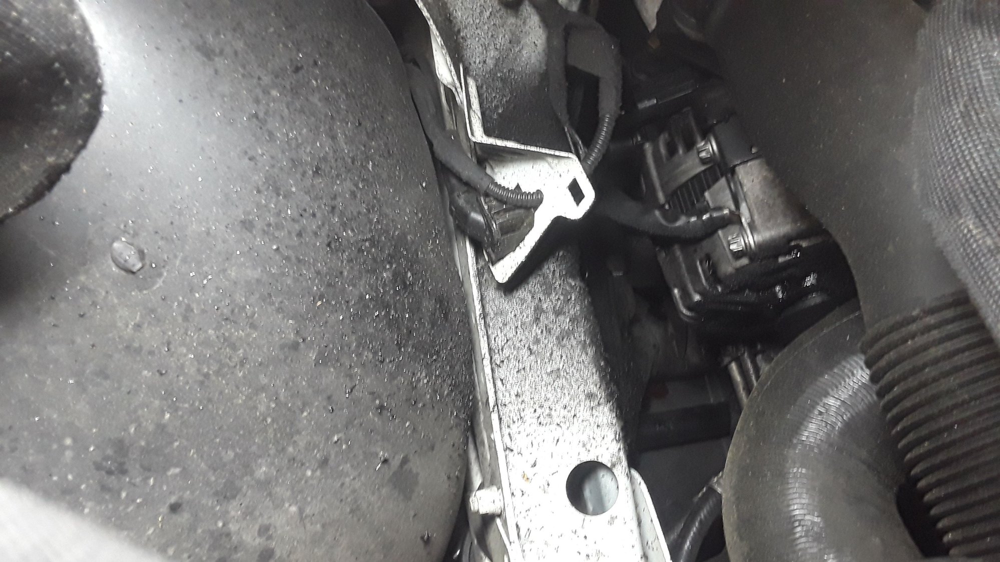

I wanted to change the engine oil on my 12, GL350 and when I removed the engine cover I found a lot of oil on the front of the engine. The bottom half of the engine is covered with oil. Also the serpentine belt is worn out and there is rubber all over the place from the belt. I purchased the vehicle not too long a go and I know the engine did not look like this when I got it. Currently there are no codes that would indicate that there is a problem, the oil is low but there is no indication that the engine ran without oil. I was slightly on an incline when I checked it. I will check it tomorrow in level surface. I have attached a few pictures. Please let me know if this is a common problem with the engine or am I the lucky one. I can do the work my self I just need to know what am I getting my self into.

That is not normal. The front should be dry. Clean with wd40 or other suitable solvent and apply dye to oil. Drive for a bit and observe with black light the source of the leak.
First place to look is oil filter housing seals

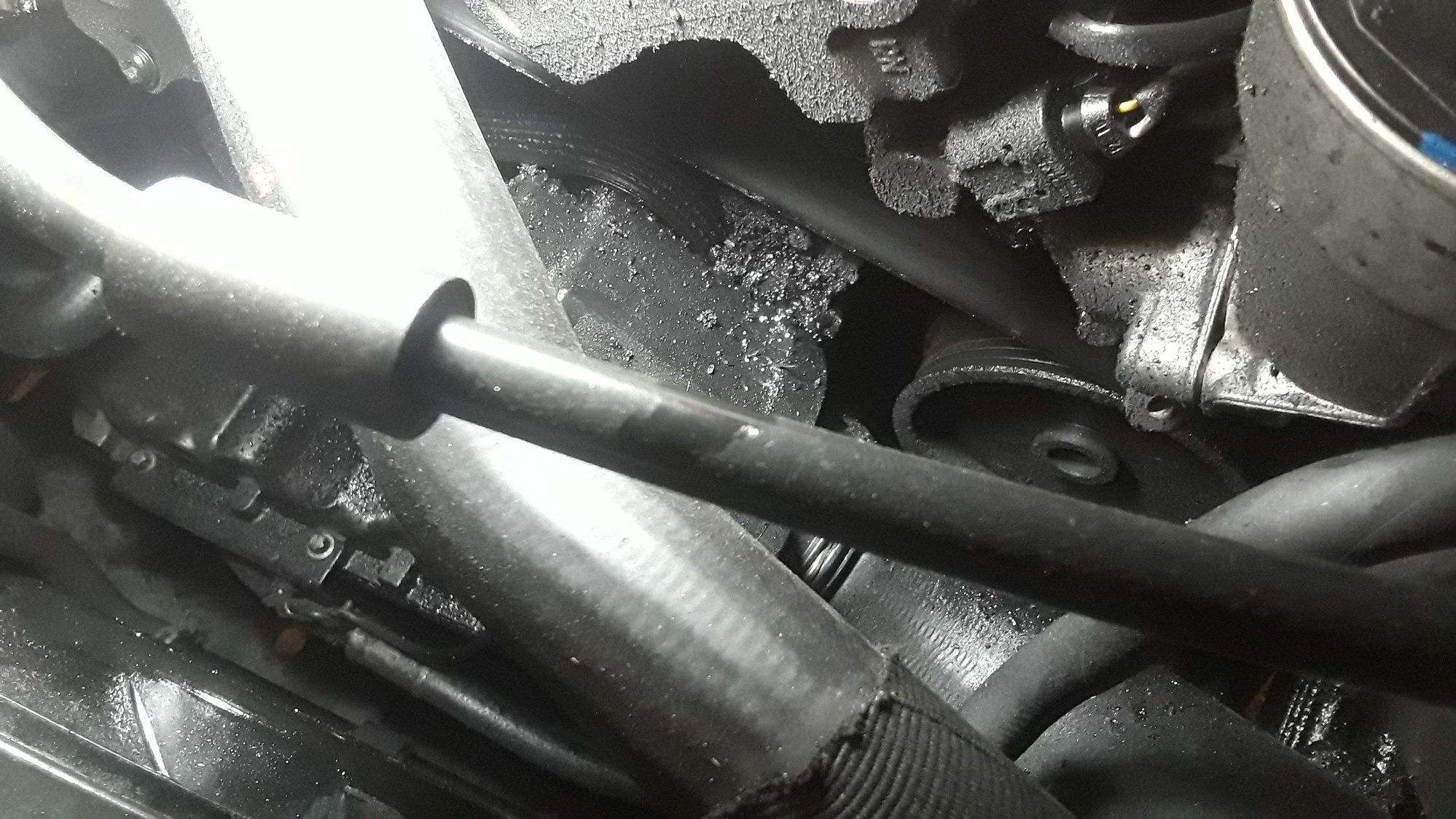

I looked at the engine diagram and the oil cooler is located on the top of the engine about half way on the engine. It seems to me that the problem is lower on the front of the engine. How likely is it that the oil filter gasket that goes between the housing and the block would cause the leak?

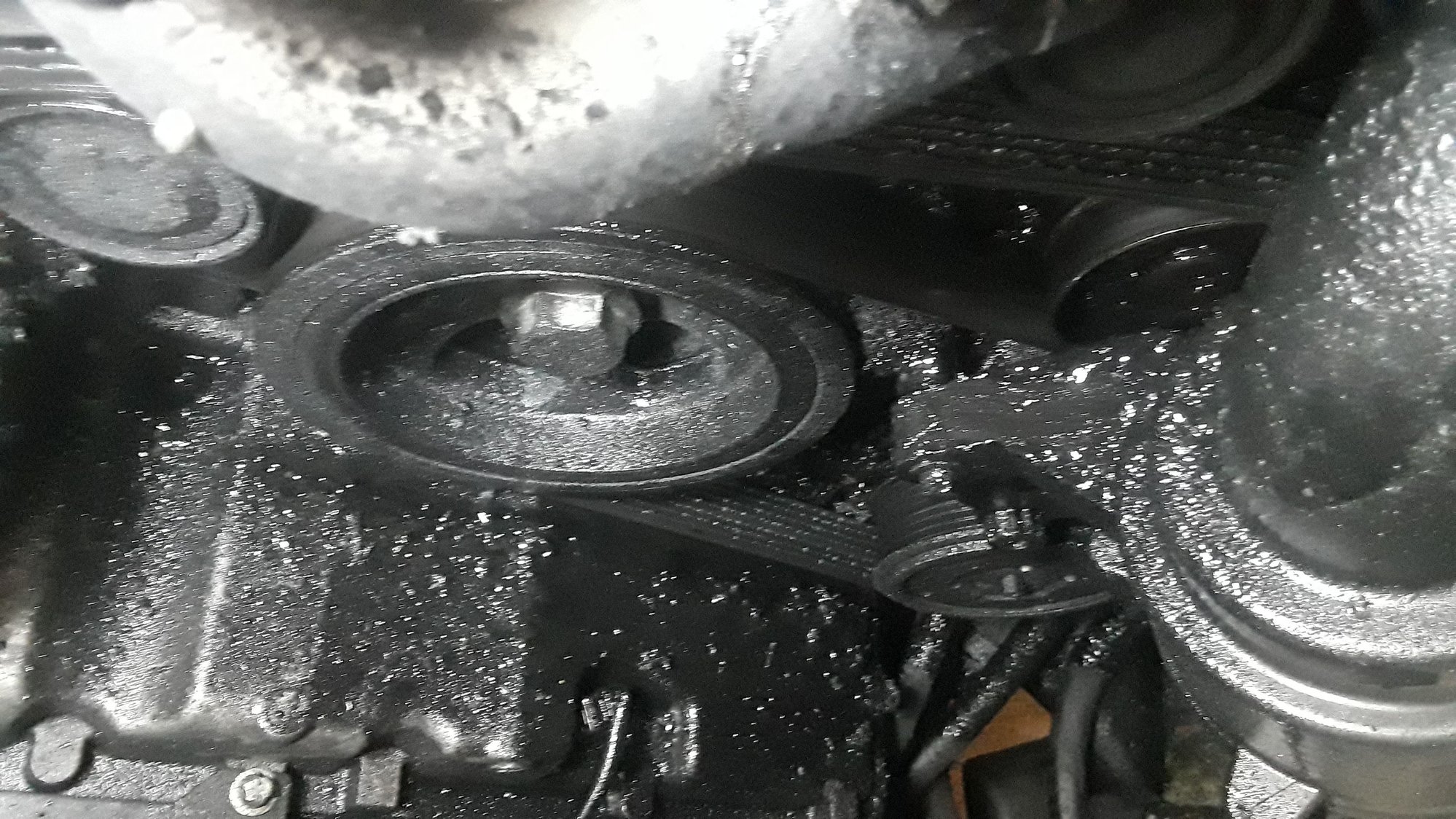

Last night I started cleaning the front of the engine and worked on it about 1.5h made some progress. I used engine degreaser. it was removing it slowly. This morning I went and purchased some WD40 along with some oil and some dye.
I also checked the oil and there was none showing on the dip stick (has me concerned). If the oil level was too low should the oil level sensor detect the low oil level and send a warning? I looked online to see if I can find some information about the oil level needed to activate the oil message but could not find anything. If you have any info I would appreciate it.

If the engine had a chronic low oil condition the oil level sensor might be sludged and essentially non- operational and showing always presence of oil. Add oil asap.
The engine valley in which which the oil cooler is located has the drains in the back thus oil cooler leaks always show in the back.

You are correct. If the sensor was slugged up it would not register the low oil condition. Thinking the same thing, I drained the oil and used a borescope to inspect the crank case. Could not see a lot of things. The camera was not that powerful. I did see several shinny areas. The oil was dirty but normal for a diesel and ended up draining about 5 quarts.
Over the past week I have been scrubbing the front of the engine so I can see what is what.
I used a small paint brush with a lot of engine degreaser and managed to clean the front of the engine. I also changed the oil. I was concerned about the quantity of oil left in the engine , but I think the engine is okay.
Yesterday I took the drive belt off and the top idler pulley was rough looking. It had grooves in it from the belt. This brings me to another questions. As I was taking the belt off, I noticed that it goes over the pulley, but the pully is smooth. Shouldn't the pulley it be groove? Looking at the belt diagram, the belt goes over the pulley and it seems that the pulley should have groves in it to coincide with the belt. How is yours? I will call the dealer and see what they say.
After I cleaned the front of the engine, I took it for a ride. I will let my wife drive it to work for a few days and see what happens.

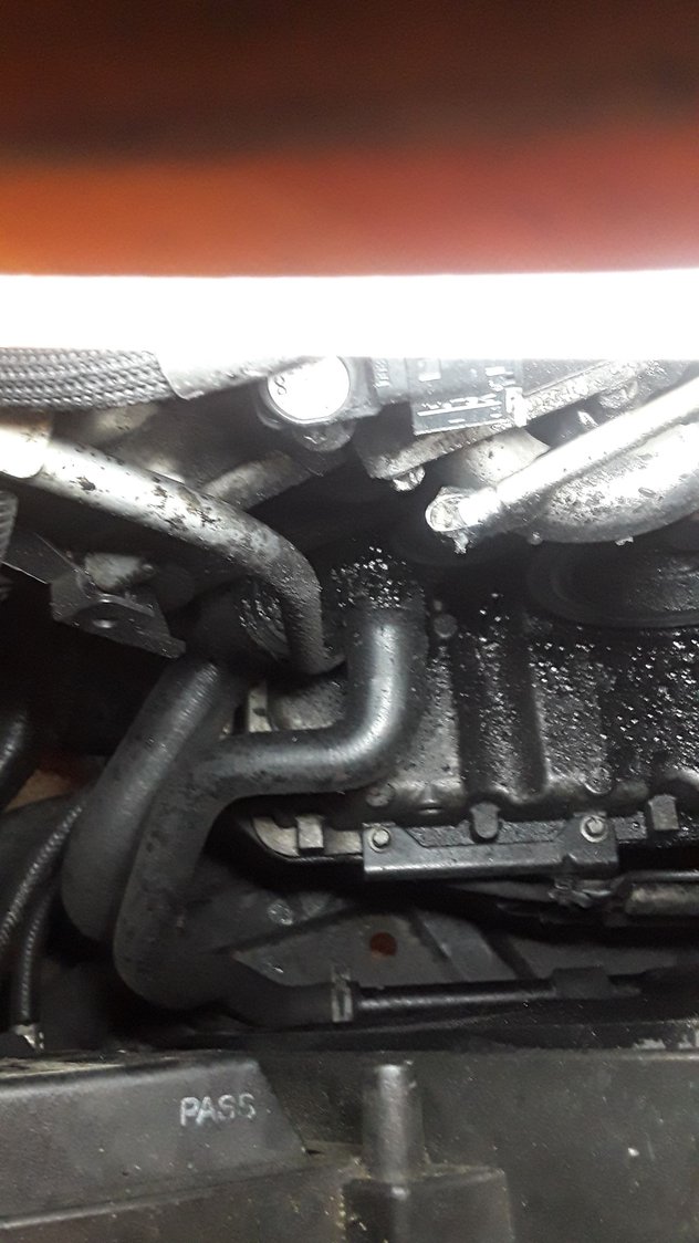

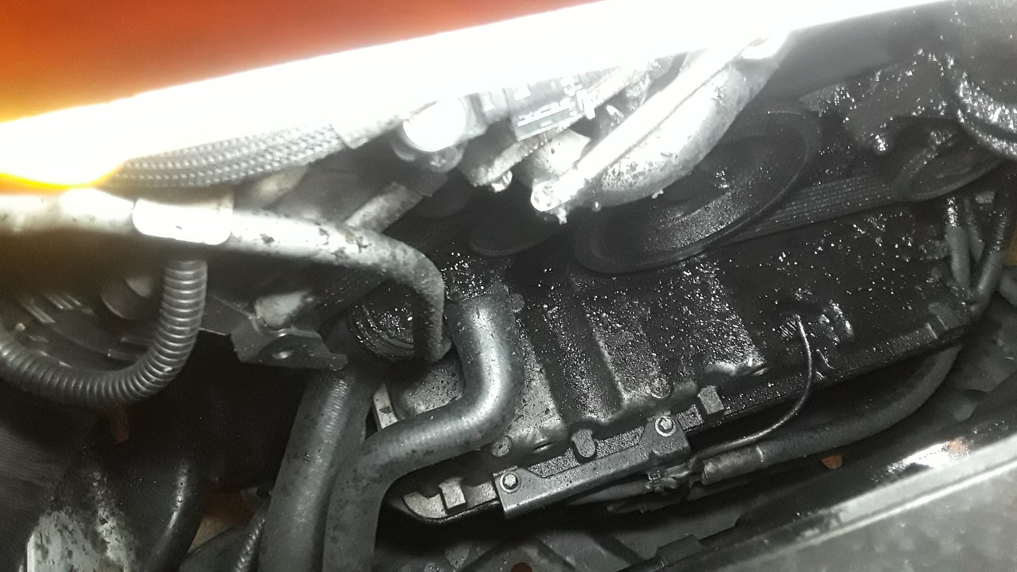

Initially that is what I did. I cleaned the engine as well as I could and looked for leaks. I also replaced the serpentine belt and told my wife to drive the car. Which she did until the belt broke. Your commend about throwing a low boost pressure code makes sense.
As she was driving I checked the leak regularly and even added some dye to the oil. I still cannot find where it is coming from. After the belt broke I cleaned the front of the engine for a second time. This time, since a lot of the plumbing's are off, I cleaned the front even better. I still have to clean the alternator some. It must be a small leak that lands on one of the pulleys, then it is slung around the front cover and all over the place. I am not sure which one. I do not think it is big leak, but enough to make a mess.

check the back of your intercooler for holes... under boost a hole in the intercooler (some times hard to see) will mist a bit oil and spray it in the pattern you showed on your photos. the hole is small enough to not trip underboost codes
otherwise, as i told you before your only chance is clean it up nicely and hope the dye shows somewhere

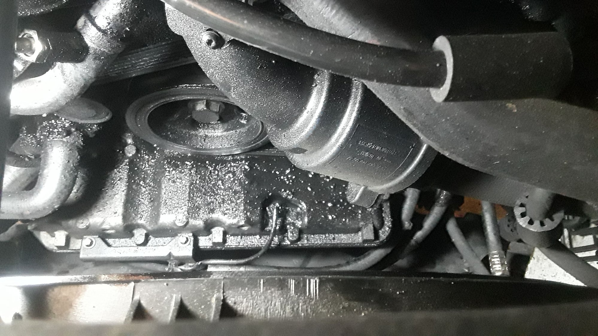

I believe I found where the oil comes from. There is a steel ring at the "engine charge air duct upstream of charge air cooler" … not my definition. It is what the manual calls it. I will take some pics and post them. The steel ring was not pressed all the way down inside the plastic housing and the O ring was not seated properly. I cleaned the engine last night again and I drove it around the house and no leaks. I will monitor and see how it goes. Now on to the breaking belt problem. Over the weekend installed a new belt and went out of town for the afternoon. I stopped to fuel up and the belt started to shred on one side. Purchased another belt in the event that it broke. But it did not. I will post more details soon.

check all pulleys if they spin freely. you might have a seized or in the process of seizing pulley. look at the diagram and locate them all- some of them are not in plain sight.

As I was cleaning all the mess from the oil leak I checked all the pulleys for radial and axial play and inspected them for nicks burrs... anything that would cause the belt to break. None of the pulleys are spinning hard and or see anything out of the ordinary. I was careful to make sure that the belt was installed properly and was routed properly, engaging the grooves of each pulleys as it should. I did not replace the tensioner yet. As I was driving the car over the weekend it started to shred the belt on the back side (the side close to the engine). See included pic. Also I am attaching the picture of where the oil was leaking from. Drove the car to work yesterday and checked there. Also checked it last night when I got home. So far no leaks.
