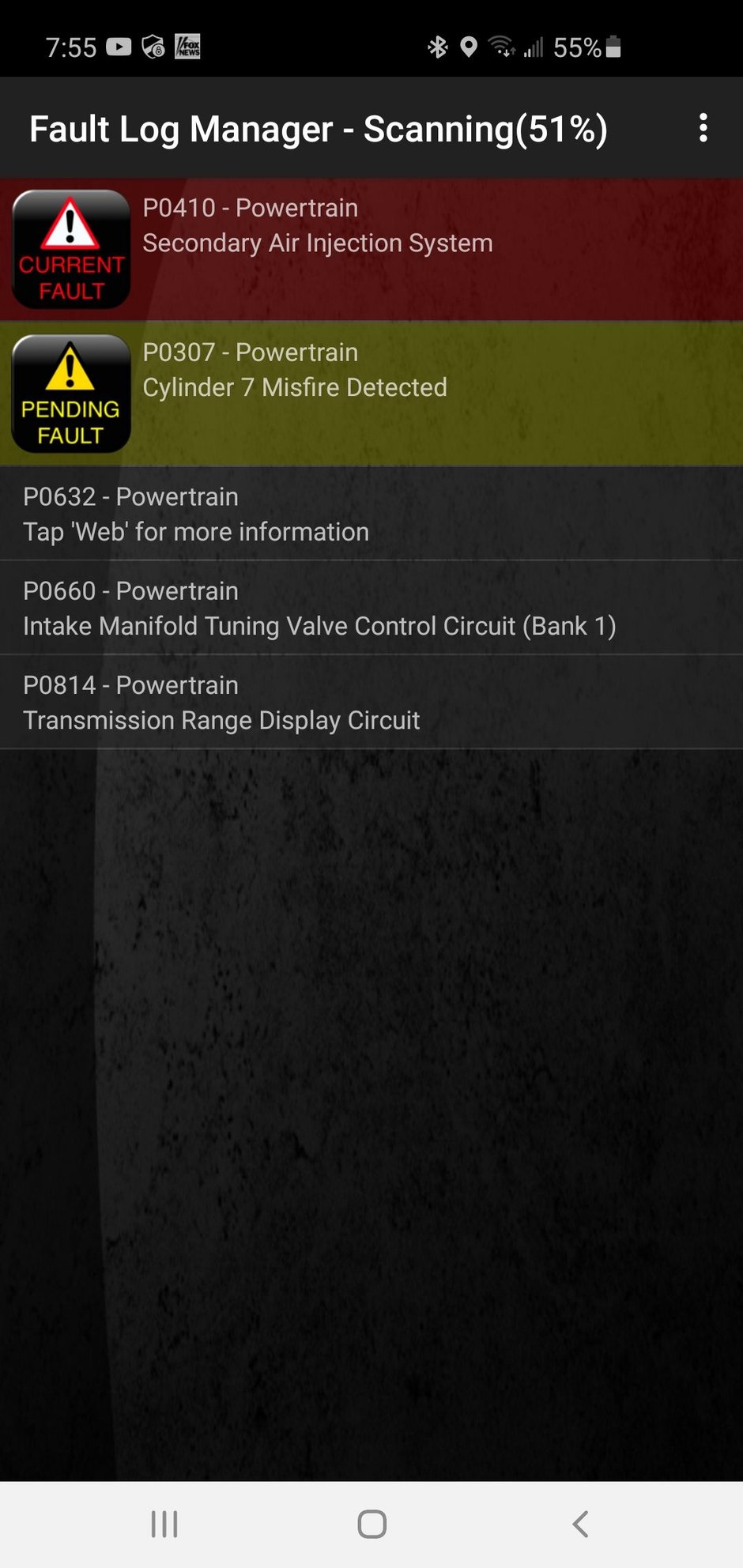

I do not know the history of the vehicle. I know all too well how many problems can arise from 170000 miles. I have attached the a screen shot of the faults I had when my scanner was connected. The vehicle runs ok I was just hoping to be able clean up the check engine light. The coil installed was a new coil. I will probably swap it with another cylinder and see if the problem moves.
Screen shot from my code reader.

The problem is, you are seeing the ghosts in the machine. Now, it's possible these are some weird historical codes, maybe due to some electrical work, but you have to clear them completely in order to be sure. Two of them, as I noted, have to do with the ECU and indicate some significant problems or changes that have not been addressed.
The 410 error means almost nothing. I'd address that last.
The misfire error is a very high-level indicator. It only means that there is an interruption in torque when cylinder 7 is supposed to be producing power. Whether this is due to lack of spark, a bad fuel injector, a leaky valve, messed up piston rings, there is no good way of knowing. If the error isn't bad enough to make it go into limp mode, I wouldn't stress about it right away.
I strongly recommend you start by getting a scan tool. You have an OBD tool; next step is something that reads modules specific to the MB. Icarsoft makes pretty good read tools; guys here get decent results with the MBII. However, it only reads, and cannot send instructions; for that you will need to go to a more advanced tool like Autel, which will set you back $800. You will want at least the Icarsoft MBII to troubleshoot your misfire error; you will need such a tool to clear the errors associated with the ECU to figure out if they are real and current. If your OBD tool can clear pending or historical codes, then be my guest.
The tumble flap is a known problem in the intake manifold. Fixes range from very cheap to ouch. Do your homework on that one.
Since the 0410 is just for emissions, and you changed the pump, I'd worry about that last. It's very strange there was water in the check valves, though. This truck didn't get flooded, did it? I've never investigated the secondary air system, but off the top of my head I can't imagine how water would get in there.
In summary: You need to establish exactly what the current issues are. The bottom three codes are probably the most significant. You have to figure out if they are genuine or from the distant past. The tumble flap can cause problems,which might be the cause of your misfire error. And if the ECU is not matched to the vehicle, you will have to go to MB or a top tier indy to get that straightened out. It is generally risky to leave the system with glitches like that left hanging.
