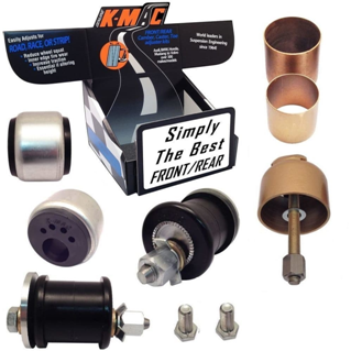

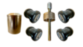

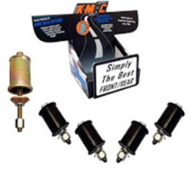

For the W164X (and every model Mercedes Benz 1968 to 2021) we manufacture both Front and Rear kits allowing to adjust “tire contact angles” - spread load more evenly !
This need was brought about to cater for other then showroom height conditions - high cambered roads, altered height through load carrying or lowering, fitting wide profile tires (or curb knock damage).
Front KMAC kit provides both “Camber and Caster” adjustment for the 1st. time and also replaces the 4 front highest wearing suspension bushes at the same time which are subject to premature failure and OEM are very expensive to replace.
While the KMAC rear (Camber and Toe) “doubles the existing adjustment range”. Like front are also precise single wrench adjustable. Bush extraction tool is included allowing to be fitted without need for arm removal.
W164/X Front kit CAMBER & CASTER #503716 P $695
Also alternative “upper wishbone inner bush adjuster, also CAMBER & CASTER #504016-2K $480
REAR KIT CAMBER & TOE #504026K $480
Delivery Worldwide $40 one kit ($60 Front & Rear)
