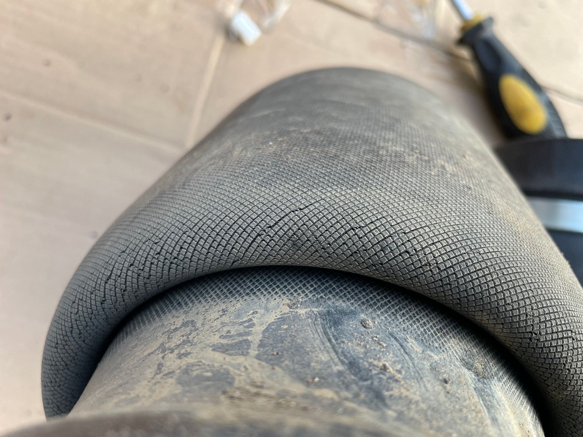

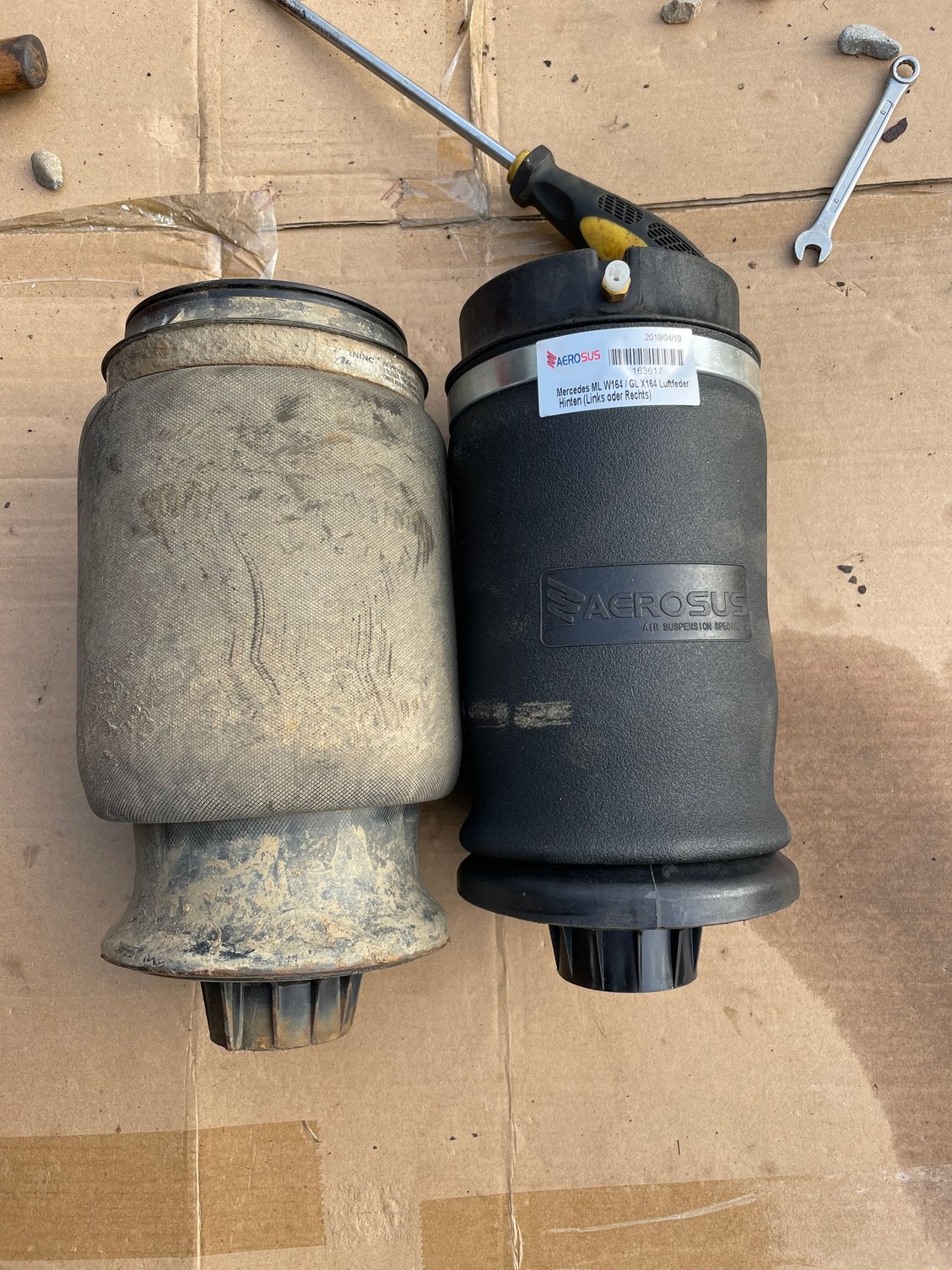

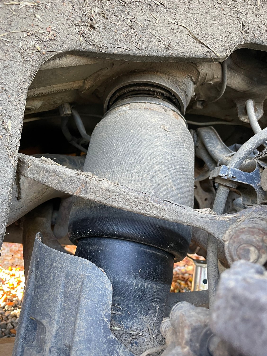

Right, I finally got around to doing the rear airbags today pretty much a doddle needing only a 10mm spanner, a jack & axle stand, take the wheel off, an to pull the 40amp fuses in the engine bay. The bag compressed enough to pull it out from above, rather than some vids online doing it from below (requiring removal of the level sensor).
The “saggy bag” looked to have perished a bit (see pic). The other left side bag, which I also replaced, wasn’t even sat in true top alignment.

Old rear left bag top mount not aligned.
New Aerosus bag v old oem bag.
