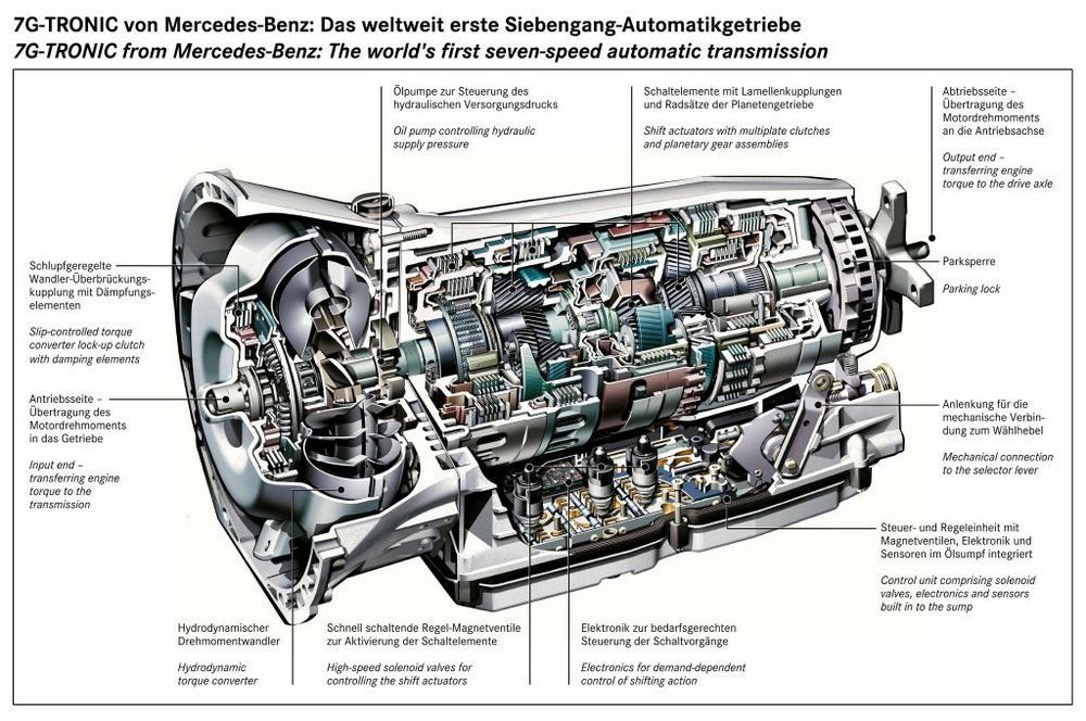

You can hear that it goes into gear in the video.
shifts from Park to reverse fine
grrrrr in reverse
shift into drive, the pitch of the grrr changes.
so it is shifting. The indicator wouldn’t move out of park if it wasn’t.
2nd forward and 1st reverse are two different ratios iirc.
also check for rusty splines on input and output shafts from tranny on out. Also that park pawl isn’t holding the vehicle indicates failure of it or some component downstream of it.

I like your logic of downstream of park lock
