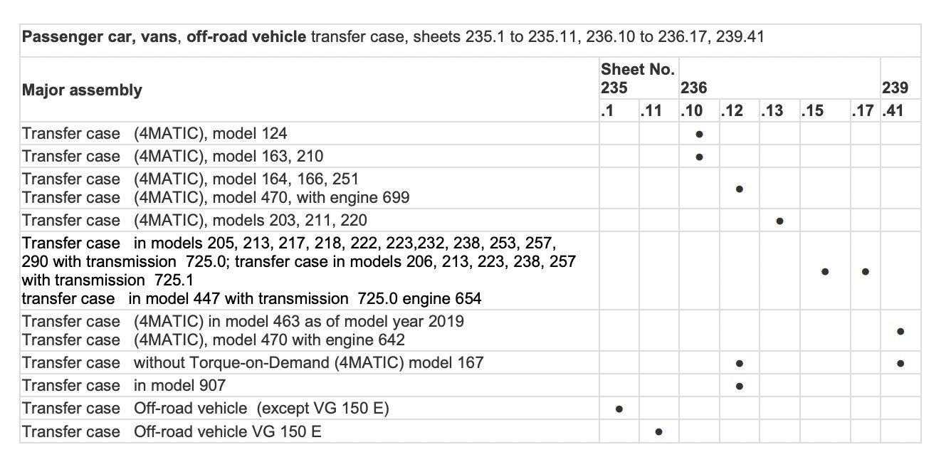

I think the rationale for it being the same fluid is in case the seal between the transmission and TC leaks, you want the same fluid in the TC as in the trans.
No.
236.15 is for the 7G-Tronic. Fuchs 7134.
236.12 is for the transfer case on 164 and 166. Fuchs 3353.
ML/GL/GLE/GLS have hang-on transfer cases and do not share fluid with the transmission. Sedan and GLC (I think also GLK) have shared lubricant transmission+transfer cases.

Ok so I`m a bit lost here, I have a 12 GL550, majority of online suppliers shows 3353 as the correct fluid but some shows its not compatible.
Which one should I use?
Any help would be appreciated.

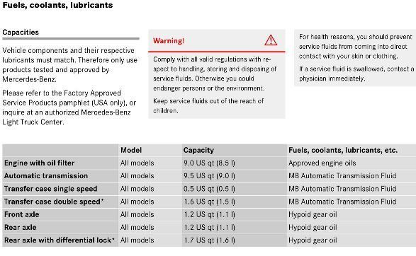

Just going to do an oil service on a freshly purchased GL500 with code 0430 "offroad package"
Table you provided is supercool - I'm just wondering what doeas the "*" sign means, and accidentally is just by the options I'm interested about - so the dual speed transfer case and rear axle with difflock.
Could you please provide any info as it seems that the explanation was there - it was just lost when you cropped the image
It only means that applies to the vehicles with the Enhanced Off-Road Package option.
Typical of MB, the option is listed even though the fluids are the same.
