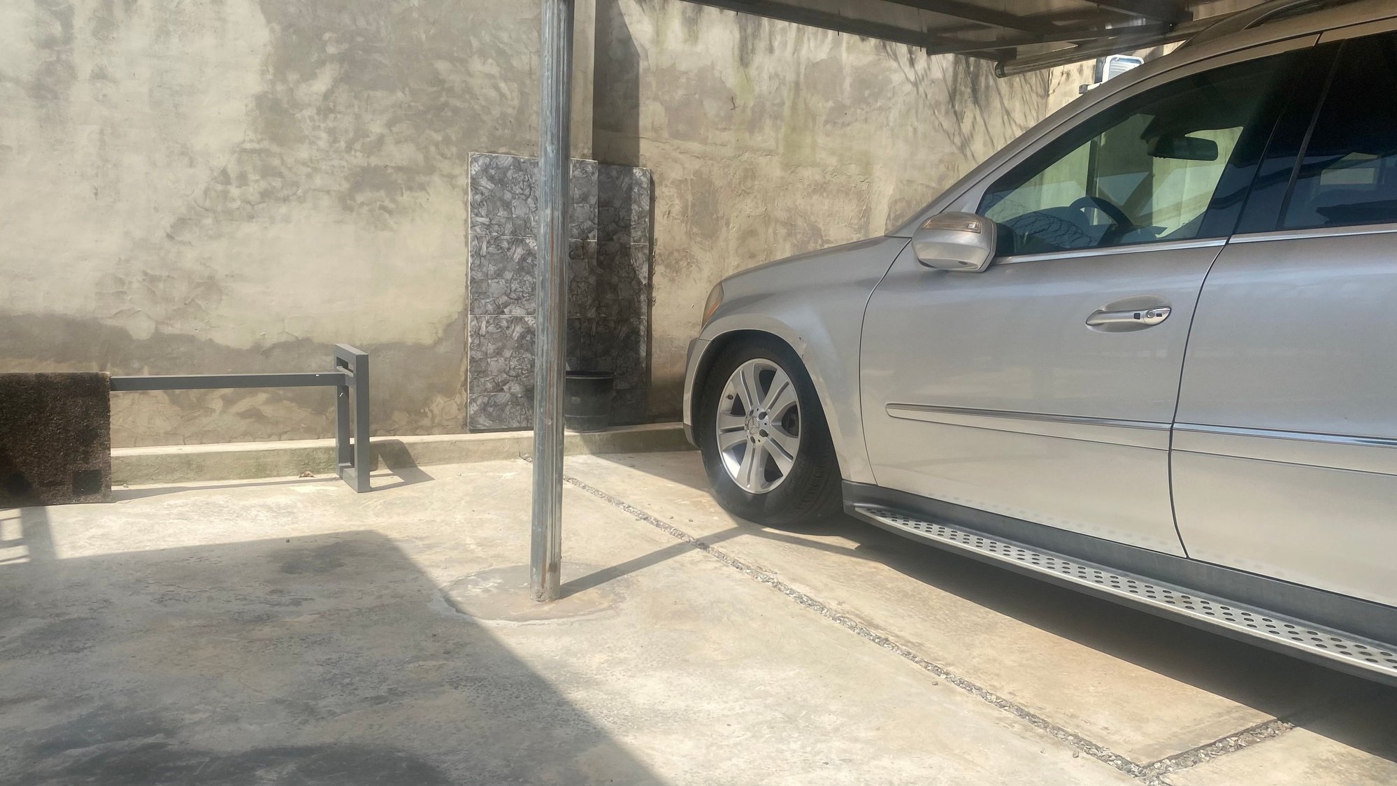

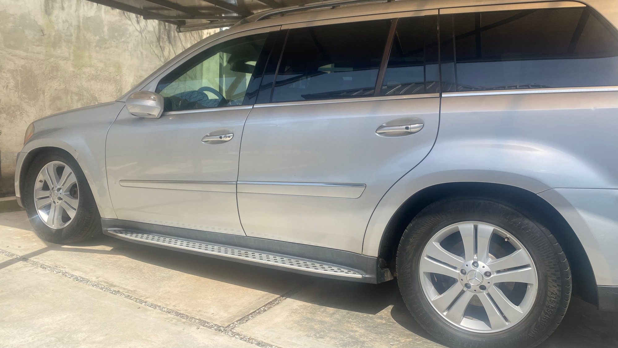

After installing the front air springs, the car rose, stayed up for two days, did a road trip of about 200 miles. A day after getting back it’s on the ground again.
Will rise when car starts but goes down again.
I’m temporarily in a wheelchair so can’t do much troubleshooting.
What do you good people think?
Old Feb 22, 2023 | 02:28 AM
Max Blast's Avatar
Joined: Jan 2010
Posts: 3,077
Likes: 770
NGL450 w/EORP, S550
Can you give us a rundown of the age and wear level of the other components in the System?
rear air springs
compressor
valve block
have you had a leak check done?
Old Feb 22, 2023 | 02:54 AM
Prince Somorin's Avatar
Joined: Dec 2021
Posts: 114
Likes: 21
From: Ibadan, Nigeria
2009 GL450
The truck is new to me so I’m not sure of the age of the components. The rear springs are still holding air but I have new Strutmaster replacement on hand.
I was told that the mechanic that replaced the fronts did not check for leaks.
Thanks.

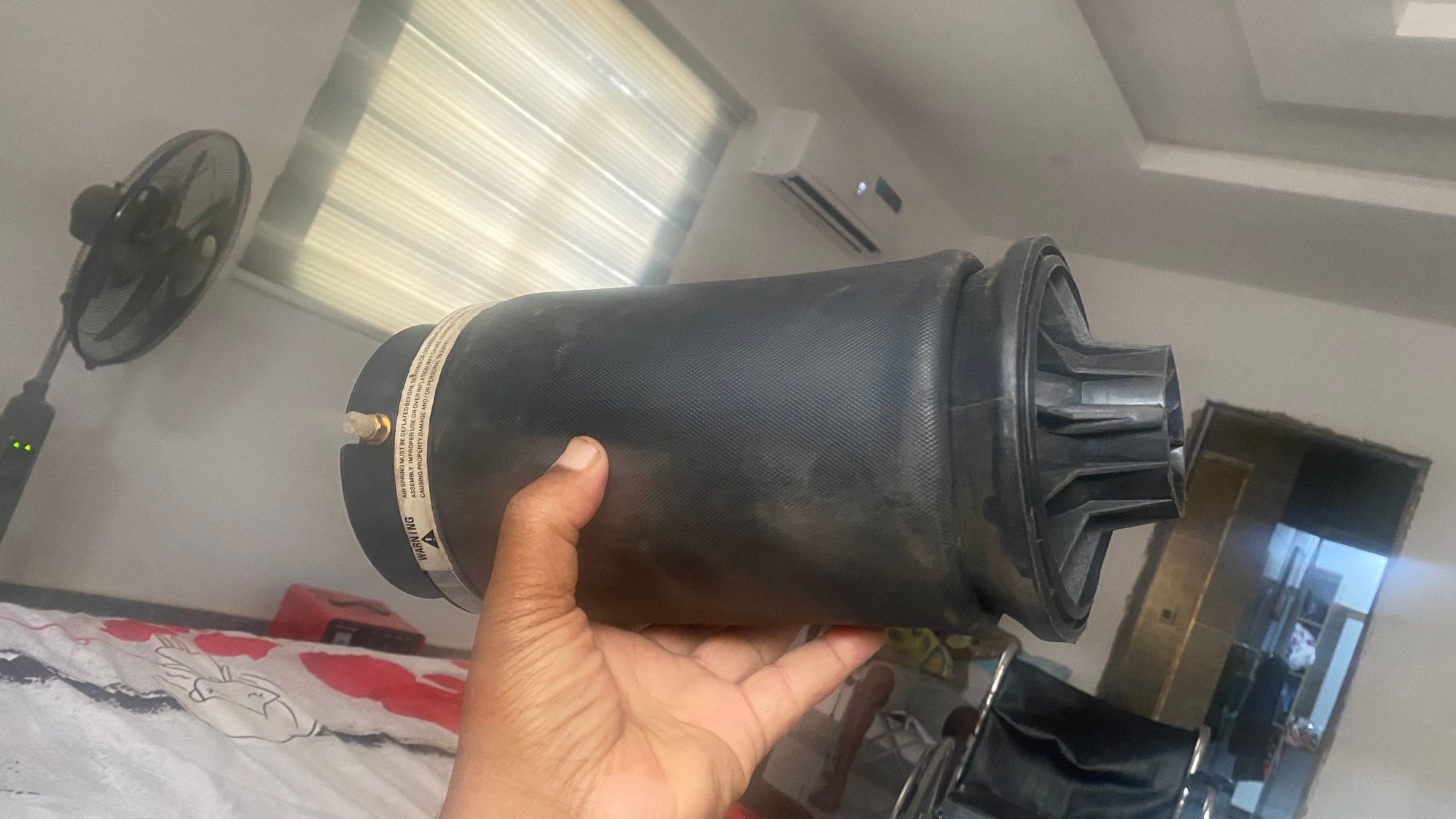

Old Feb 24, 2023 | 01:08 PM
Joined: Dec 2021
Posts: 114
Likes: 21
2009 GL450
One of the rear springs that Strutmaster sent to me has the nipple hole in the wrong location
