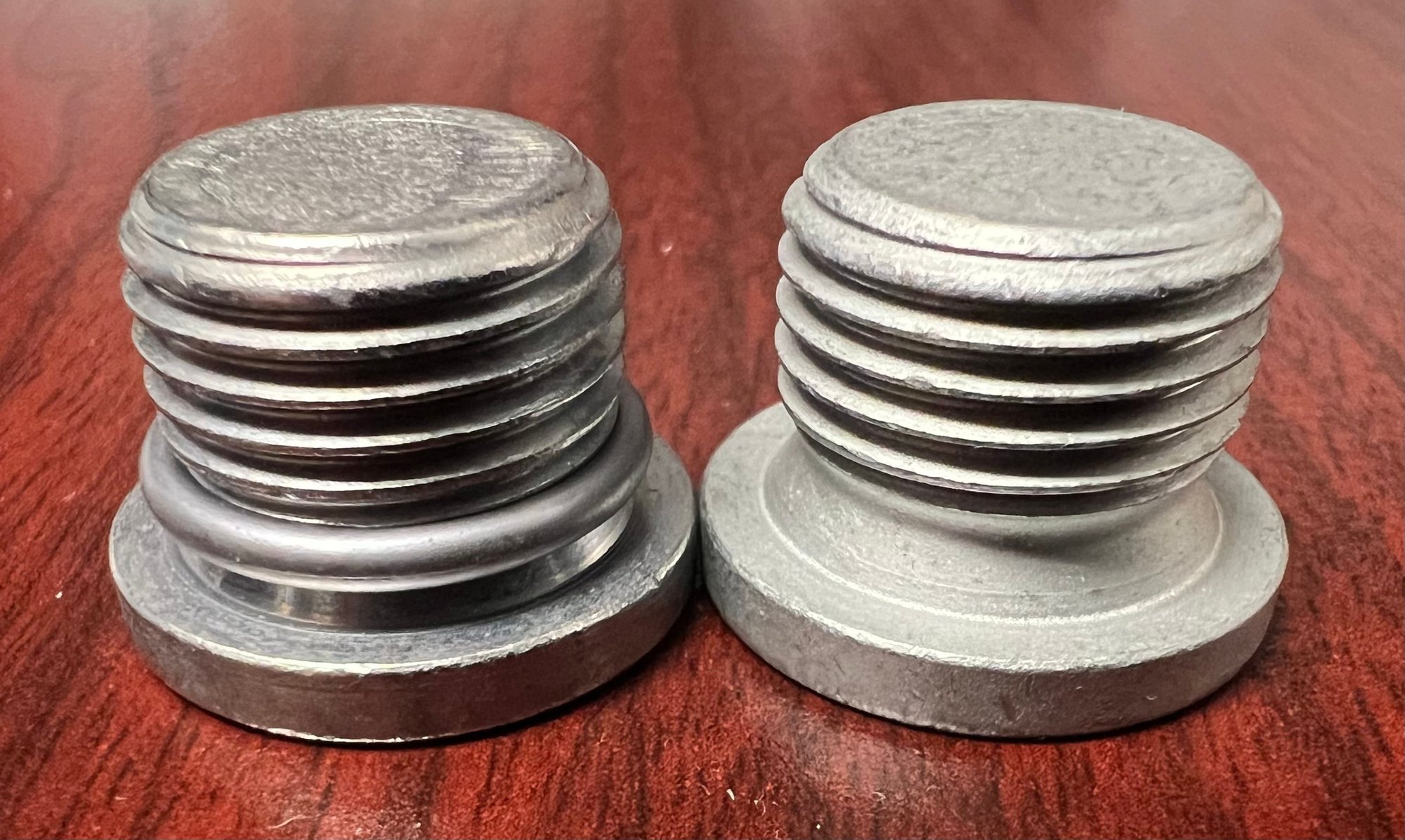

Apr 21, 2023 | 09:56 AM
TC plug and dif plug side by side. They are almost identical. Just different material finish. The dif plug comes with oring on it.
Reply 2
Apr 21, 2023 | 10:03 AM
Quote: TC plug and dif plug side by side. They are almost identical. Just different material finish. The dif plug comes with oring on it.
Not identical. Look at the machined shoulder on the axle screw vs a relief cut on the tcase screw. No one should attempt to use these interchangeably.
Reply 3
Apr 21, 2023 | 10:07 AM
That’s correct. They have different part numbers.
Reply 1

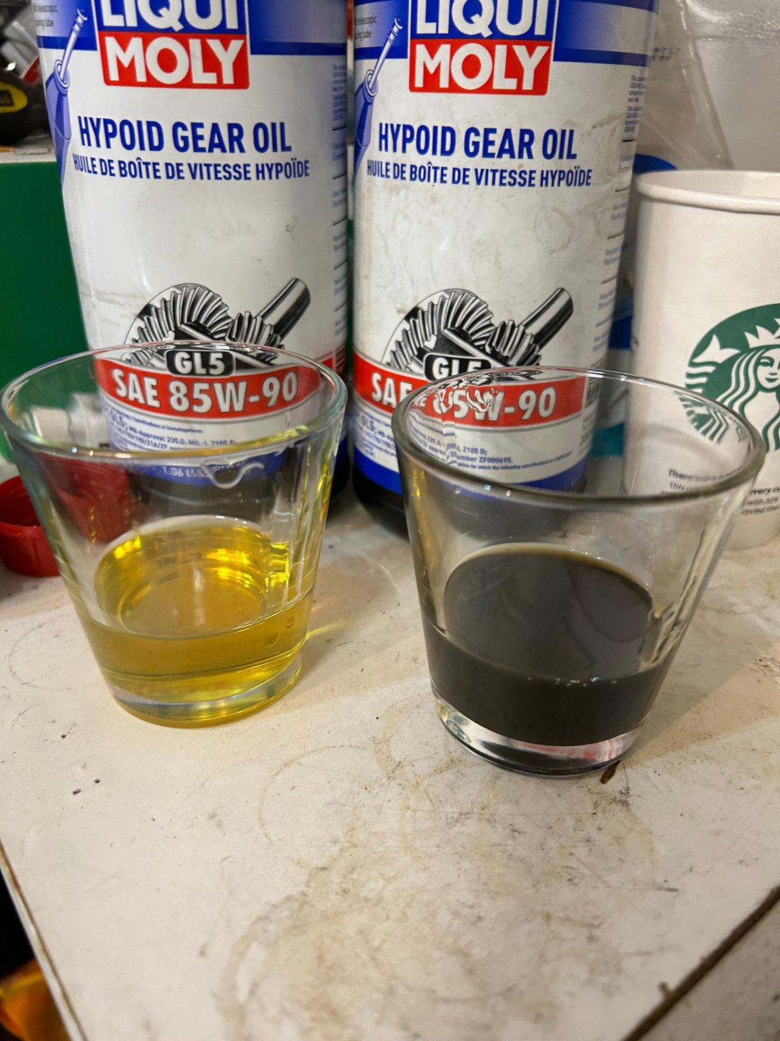

May 15, 2023 | 02:16 AM
Was able to change the front diff today.
Used LiquiMoly 85-90 as replacement.
It was a little more than a liter. Used Permatex Gray on the same plugs.
Cleaned the area well, I’ll keep an eye on it this week.
Will do the rear one next weekend.
Reply 0

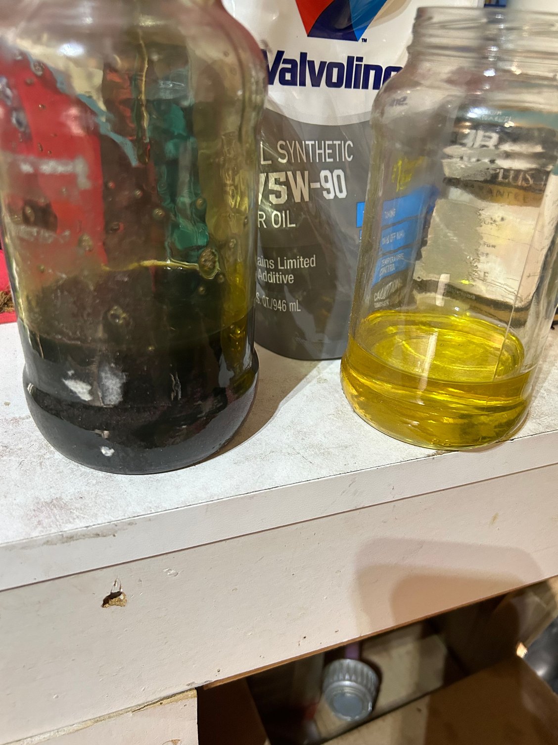

May 19, 2023 | 12:45 AM
This from the rear, I used Valvoline 75W90 for the rear. Used Permatex gray again on the plugs and torqued them to spec. Front plugs are so far so good, about 5 days now.
