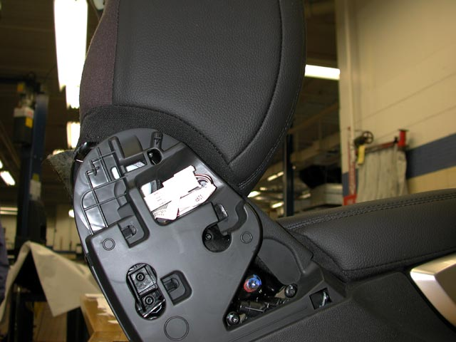

You are looking for a black/white and brown/white wires. These are the two wires going to the motor.
Apparently you can gain access to the wires from the side of the seat:
Apparently it's the white connector or thereabouts. There should be a white connector you can access the wires from.
