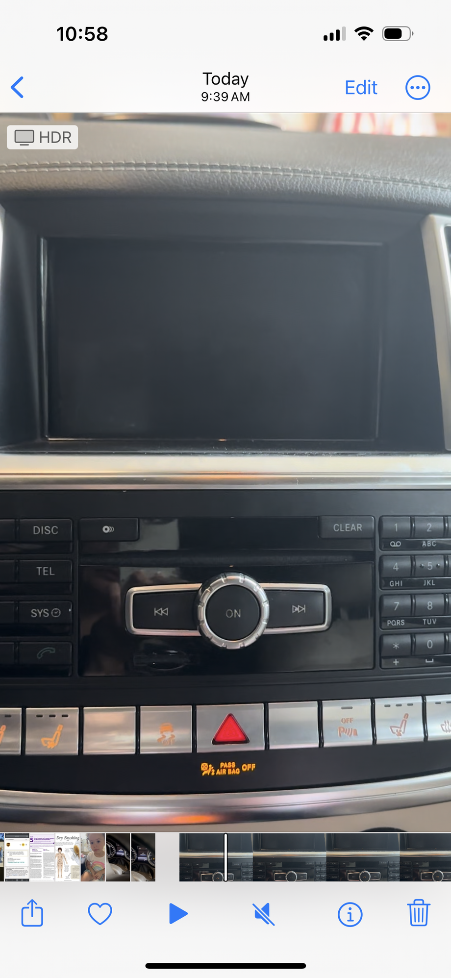

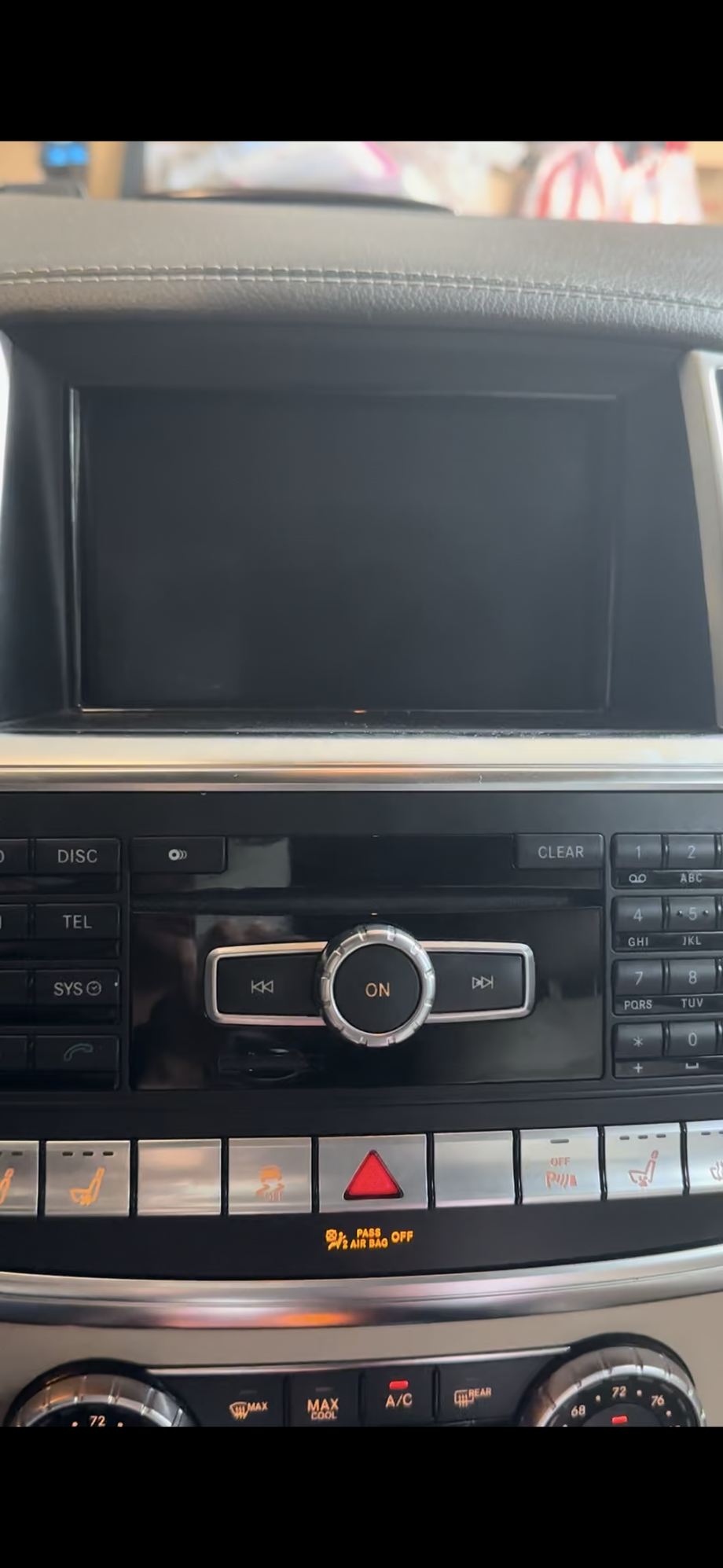

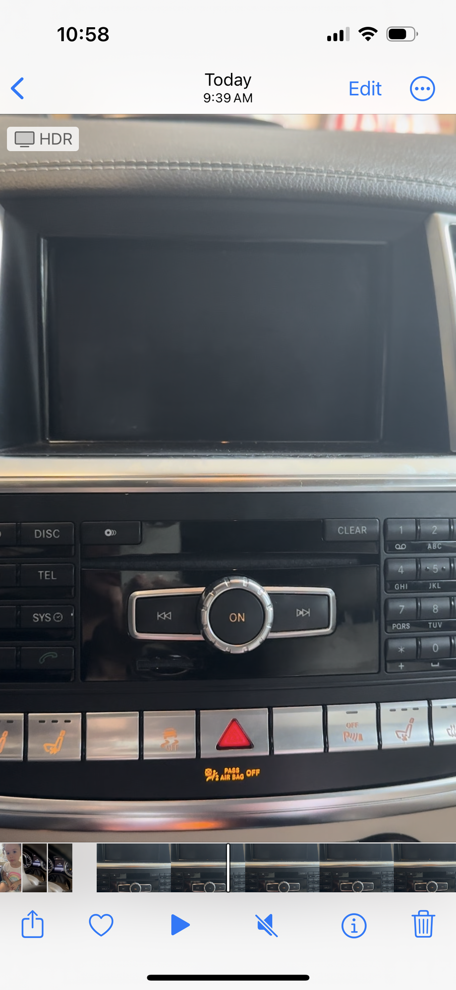

Any advice on the 2014 GL550 head unit replacement, i think it is x166
screen no longer comes on , on button just flashes orange

x-164 not X-166
You are in the wrong forum.
