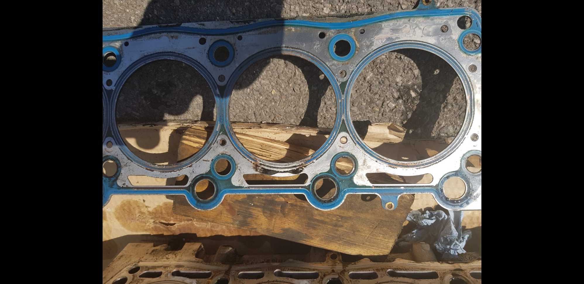

After removing the second head, we see this :

there is no way you were not losing coolant through that gap
Old Jun 26, 2019 | 01:13 PM
Said Ridan's Avatar
Joined: Jun 2019
Posts: 10
W203 C320 cdi
True.
I guess the pressure made it difficult to spot, but I couldn't see noticeable difference in water level.
Thanks a lot for your help !
I think the Mercedes dealership where I went is a scammer. A friend warned me about him but I didn't listen. There should have been exhaust gas residue in my water. I should have bought a tester kit and tested it myself.
