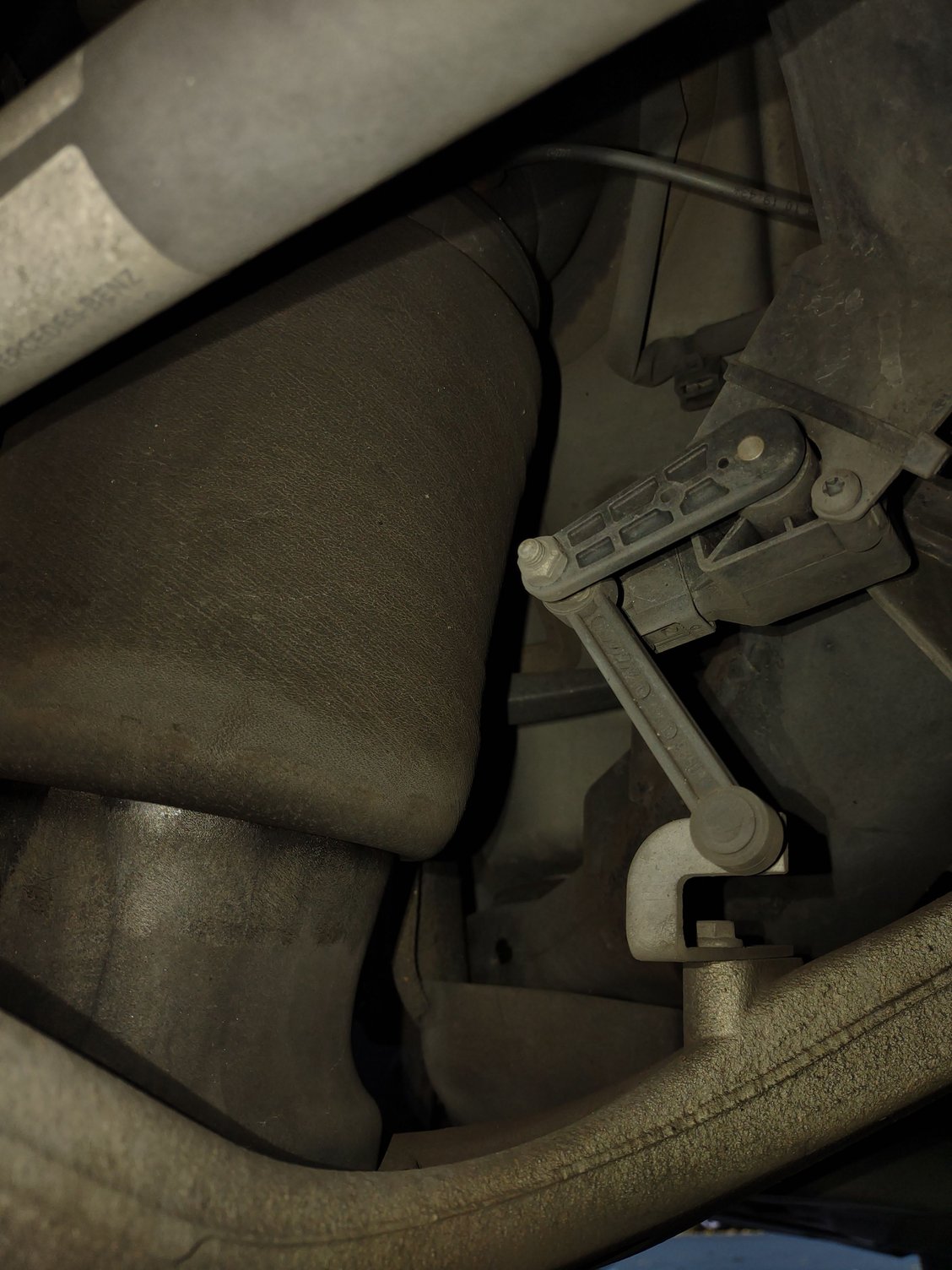

Started the truck up shortly after taking the pictures. I could hear very loud hissing on passenger rear and a low hiss on the driver side. I jacked the rear up and found a massive hole in my passenger rear air spring!
The driver side rear is hissing too. There was no hiss before on the driver rear. But it must have blown out too.
Could a bad valve block cause this too? These are NEW air springs.
Passenger rear
Driver rear doesn't show damage but it hisses.

Still don't get why both rear air springs would fail. Could the ride height sensors be the culprit too?
If you see in the pictures, the arms are intact on both sides, but how do these sensors fail?

See if the arms move easily by hand - disconnect them and move them.
Maybe someone else will chime in, but I don't see how height sensors would cause the bags to pop - I mean, if they were way out of whack, you'd notice that. You can read the sensors with some code readers.
Could just be a bad set of bags - hopefully they'll stand behind their product.

Well, some thing overinflated them, and I just possible that the sensor arm have been reversed or over traveled so that the inputs to the system are out of whack and the compressor is trying to inflate a bag that’s already inflated.
I would as blownV8 said, examine the sensors for smooth travel, and that they are all bending the same way
But yeah, when you have hissing from the back of the vehicle, there is absolutely a hole there, excess pressure is normally vented off in the passenger front wheel Arch by the intake.
