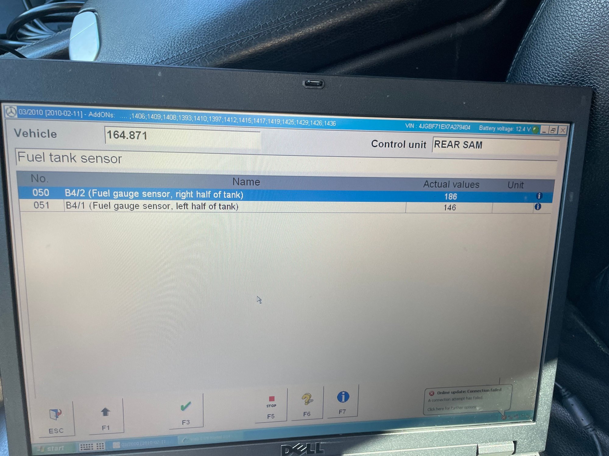

So, it happened again. Brand new MB pump and filter.
i had another soft power loss with 1/4 tankful showing, but I’m not sure I had 1/4 tank and we will get to that later.
I opened up the pump lid and tapped on the tank from below. All while on the side of the road. No change.
i called a rescue and put in 2 gallons and it fired right up. Drove to the nearest gas station and filled it until it clicked off - 21 gal it took. So let’s do some math here:
at 1/4 tank should have 26.3/4 = 6.6 gal remaining. Plus the two added in, 8.6 total it should have have only took 17.7.
21 gal filled minus 17.7 it should have taken if the gauge weee accurate that leaves a delta of 3.3 gal which incidentally is the capacity of the emergency reserve part of tank.
so I think that I installed the filter so that it is unable to access the last 3.3 gal in the tank, and that the float on it is hung up on one of the tubes/wires and lying to me by saying I have more gas than I really do.
and I really don’t wanna open up the driver side again to check this…
I ran a short test and there were no codes for implausible mismatch between the two floats, and I’m not even sure it measures that, also ran a fuel tank pressure test, which passed, but again it’s so darn hard to troubleshoot fuel pump in this car. The only thing you can do is turn it off and on to make sure that it turns off. Which is marginally useful.
throwing this one to you guys to throw peanuts at my math in public, and see if there’s any particular way, the filter needed to be rotated, and the tube ran towards the front of the tank…
but until that day, I’m just gonna keep it over half full and curse myself a little bit.

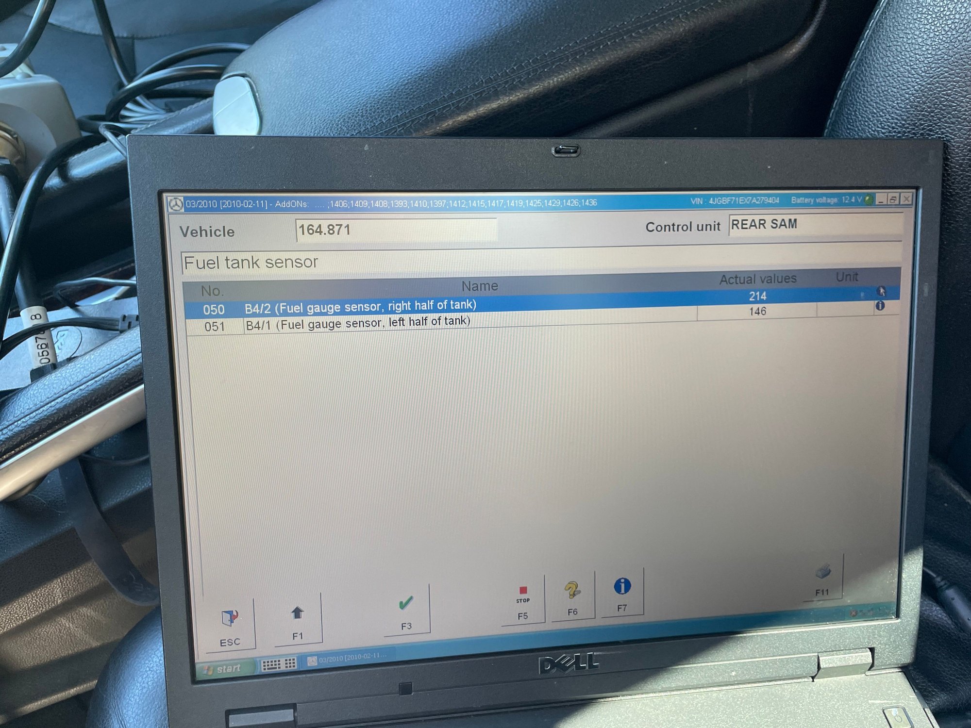

I read out the individual float levels by interrogating the rear SAM with gas at known close to empty (gauge still showing 1/4).
not shown, but Wis states That each float level ranges from 10 to 214 ohms, 10 full and 214 empty. The reading above was taken with the tank completely empty after having pumped all of it out the fuel rail using the fuel pump..
The second reading is after adding 5 gallons… As you can see the b4/2 passenger side reading moves up accordingly, but b4/1 (drivers side) one does not so it is just hanging there in mid air stuck.
I so don’t want to do this again, but I seem to have no choice other than to dig in under the 60 portion of the backseat and get the lid off that I so tightly cemented in with permatex.
ugh.
But from what I gather, the emergency reserve capacity is basically the bottom 3 gallons of the entire tank… There’s no way that the crossfeed from the filter unit hose can reach into the deep pockets on either side. So that is actually picked up by the b4/1 filter side through the strainer sock that is pressed against the bottom bottom of the tank.
It gets to the fuel delivery side by motive flow that is created by the b4/2 pump on the other side… Crafty.

Originally Posted by Max Blast
yep, the driver side float is stuck.
ugh.

Based on what you saw when filling, it seems very much like the float is hung up on something.
I noticed the arm swings up and down in a slot in the plastic. If the arm got bent, it might be rubbing on the plastic and got stuck.
If the gauge mechanism is damaged, you could probably transfer the old one onto the new filter.
