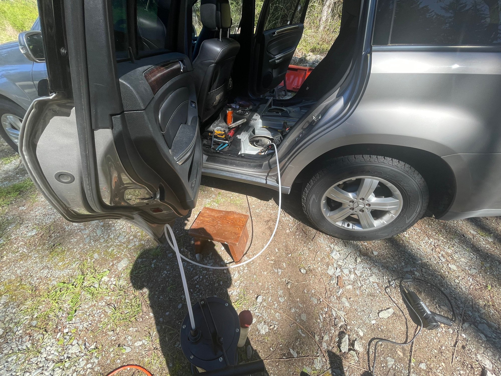

So folks, she’s down for the count.
I had a late night return from a work trip where I pulled into my usual gas station with 2 gallons left and reserve light on. Filled the tank full of 87 and proceeded home.
2 miles later I have a soft power loss and the car just coasts to a stop and crank no start after that.
I got towed Home, and read codes - the only active and stored ones were both catalytic converters not meeting threshold. No misfires, no fuel pressure no nothing other codes.
When I try to try to test the fuel pump under ME 9.7 and the test one of the pre-Reqs is the engine running so how do I test the fuel pump?
Other clues I have is that there’s no pressure released in the fuel rail after cranking
I do not hear an audible anything with the fuel pump actuated under ME 9.7 actuations (but remember the pre-req for this is an engine temperature above 67 and the engine running)
so working off the theory that I got bad gas that shut off the fuel pressure sensor or if there is in fact, a fuel quality sensor that could trip the pump off-line… Either way I’ve only been able to suck out the right passenger saddlebag gas and I will need to remove the pump lid to get at the driver side saddlebag to get those additional 50 L out.
first sample had the tiniest bit of water in it and everything else came out pretty clean. I’ve ran it through my mower and my truck with no adverse effects.
sample 1
the rest of them fine
We’ll see what the 50 L coming out of the driver’s side or what’s in the filter looks like but… That’s all I got from now just waiting on parts from auto house. I’ve got MB original relay, pump and filter unit on the way just in case.

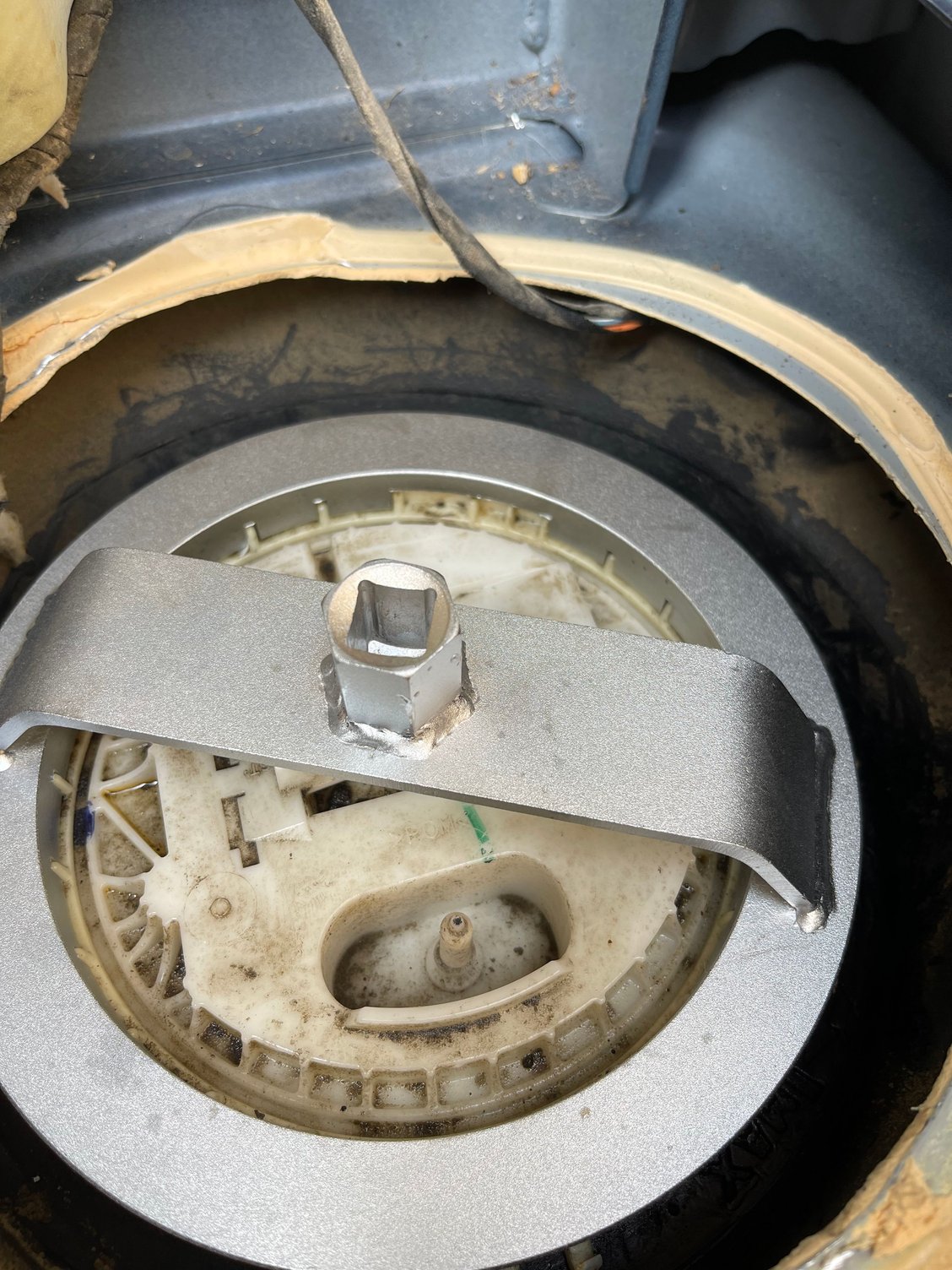

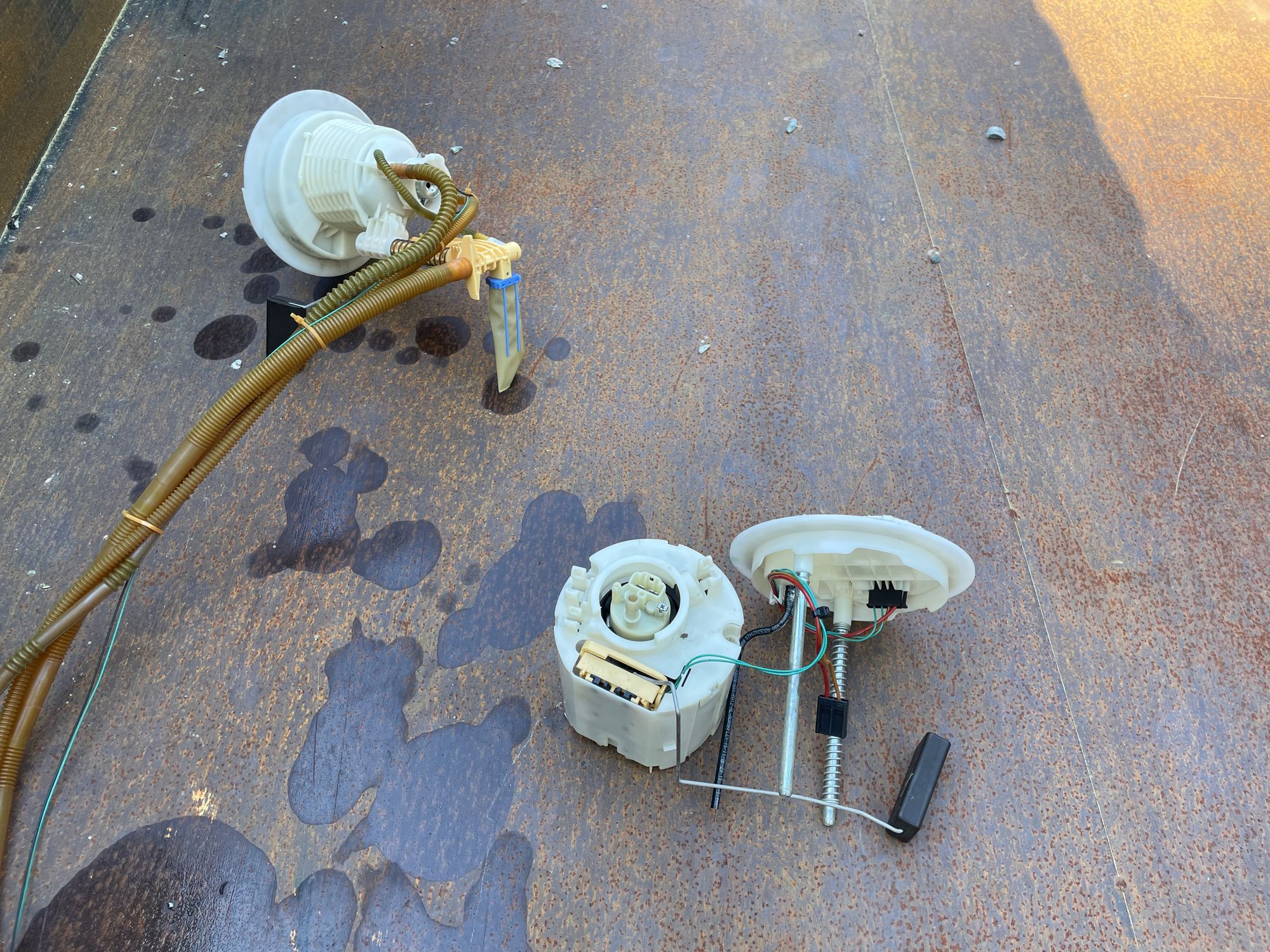

Yep, it’s definitely the pump.
Application at 12 V resulted in silence, with a wrap on the pump it started running again. So I’ll consider that one done.
the gas I’m extracting is as pure as the driven snow, and I’m impressed with how clean the tank and components are. Well, of course, they’re bathed in solvent… I have introduced more dirt to the tank system by opening it up, then was previously present, but we will see a new pump and filter this Friday.
And also do not use the cheapo two prong Amazon pump lock ring extractor tool it is only good for destroying the lock ring.
I tried very hard to tell everyone don’t waste time or money on the two prong pos. The full circle is so simple and works perfect.
Good for you changing the filter as well while you're in there. My parts are still sitting on the shelf. The check valve still is intermittent.
I will be most interested to see if I can remove the locking rings with the two prong tool

Update - done.
I ended up swapping both pump and filter with MB branded Delphi units, and using one new URO ring assembly while reusing one of the factory ones. The gaskets were softer than the supplied Uro one so I reused one. I tightened down the covers with the cta tool which is now mine to keep.
the worst part of the job was really lifting the rear bench out and in, pretty straightforward really to get at the pump. Just make sure you mark where each torx head screw goes be use I was left with two that did not fit in the last two holes I had to cover!
also, must reset the SRS codes for the rear seat airbags. And: these cars are so well put together.
and bonus - since it sat with no power for a while all adaptations have cleared and I dare say that I no longer have that driveline clunk I was attributing to a worn transfer case (two speed EORP) chain - it’s either a bad adaptation leading to clunk on the 2nd gear takeoff or I now have a smooth adaptation covering up a slack chain…but I’m inclined to believe it was all an adaptive thing, and annoying as hell.

I destroyed one ring assembly with the cheapo two prong tool from the jungle website. Ended up chiseling it out just to get the pump out to verify it was done.
I used the gasket maker aka gorilla snot to re-create the sealing lid over the tank, it now smells while it is curing but no other ill effects. That OEM sealant was tough but came off with a heat gun and a razor.
Old Apr 22, 2024 | 02:06 PM
eric_in_sd's Avatar
Joined: Jun 2010
Posts: 2,757
Likes: 629
From: Emmett, ID, USA
2007 GL450
Okay, thanks. I ordered this one from ebay. $33bux.
Now I have to hurry up and do the r&r so I test the tool. I'll be honest, I wasn't thrilled with $66 for a one-time use tool, but half that ain't bad. Yours is galvanized; I hope they're the same dimensions etc.
I still wonder if the two prong tool wouldn't work well with an impact wrench, anything to ensure the vertical force is pure vertical, and the torque isn't twisting the tool sideways, like how you basically have to use a two handle tool to drive a tap.
As far as I know, the caulk does nothing besides seal the cabin from the outside world, so you could use just about anything. Painter's caulk (latex) is cheap.
