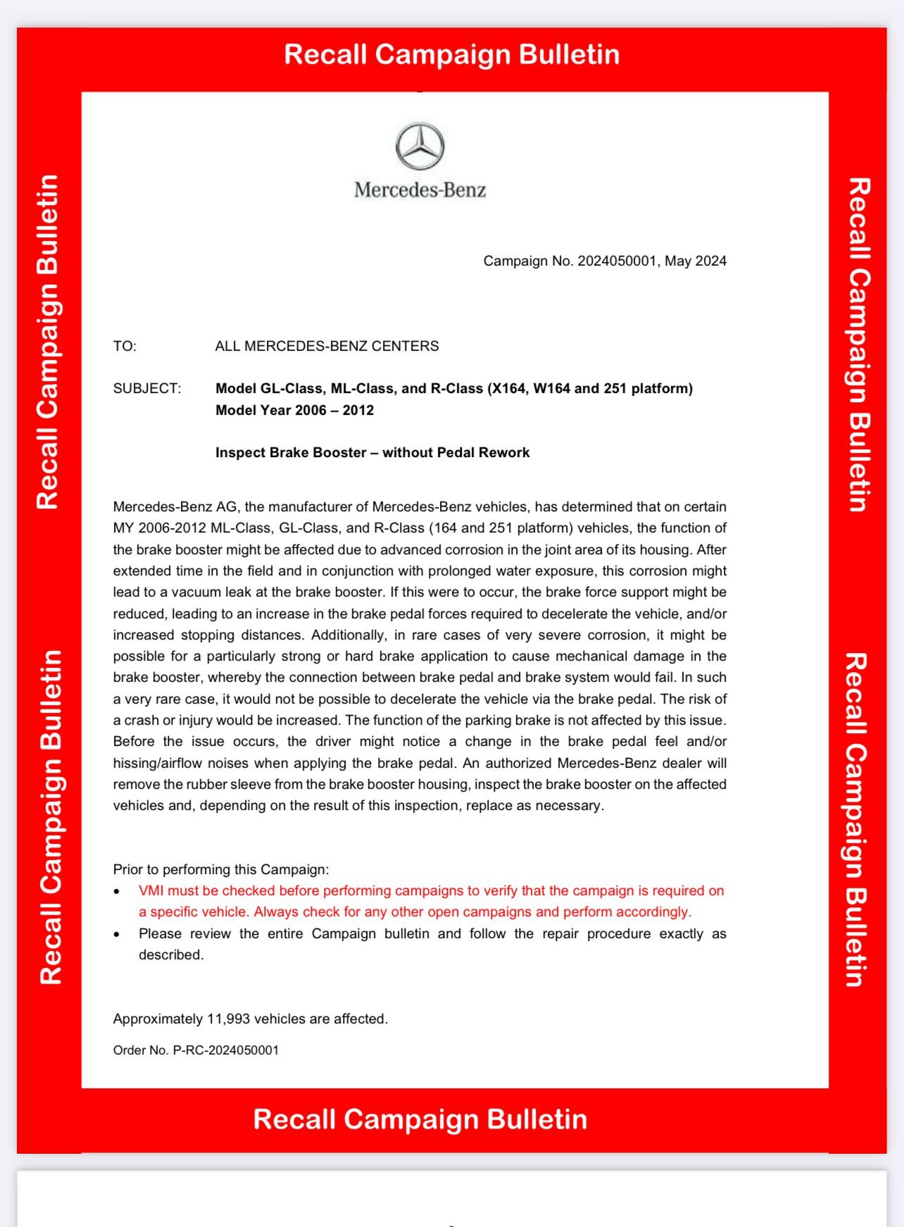

So the rust can cause a vacuum leak which would lead to needing more pressure on the pedal and in really rusted cars possibly mechanical failure because of the hard hitting of the pedal. It’s all in the recall info .
For the complete recall
https://static.nhtsa.gov/odi/rcl/202...4V298-0919.pdf

The reason for sidelining the vehicle was that MB did not have an updated part number to install, nor did they want to install the non-updated part for liability reasons. So you would effectively be waiting for MB to update the part.
glad to hear some dealers have updated boosters or are installing the existing part number subject to periodic inspection. As I recall the main issue was that the rubber band around the seal of the two halves was retaining moisture and causing rust. The recall involved removing the rubber band.
