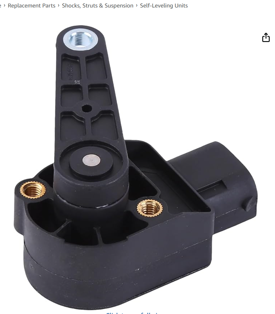

Are your level sensors ok?

I believe the ride height sensors are doing their job--when the vehicle is mysteriously in a raised position, as soon as it is started, it checks the ride height sensors, perceives that the vehicle is elevated, and immediately goes into "lowering" mode until it is back at normal ride height.

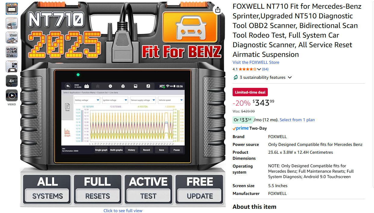

I just got a Foxwell NT710 from Amazon.
It was pretty cheap for a tool that is bi-directional with a Benz. (I've been looking for something "cheapish" for a while)
I read the Airmatic system, recalibrated the height sensors and set a new ride height. Did this a few hours ago, I'll see if the settings stay saved in the ECU over the next few days.

Nice. I would be interested in your review of the scanner overall for the Benz.
can you send us some screenshots?
I'll post them in this thread, so not to thread jack this one.
ODB Scanner thread
