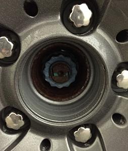

Anyone know the exact specs and where to buy this wheel lug bolt nut socket so I can do wheel swaps at home?
I'm reading online that it's 17mm flower shaped? Can anyone confirm? A link to a website to purchase would be great.
I am using OEM lug bolts with OEM wheels. Car is a 2013 GL550.
Just put my new winters on (painted himalaya grey - same as the center cap which I forgot to put on for this picture).
