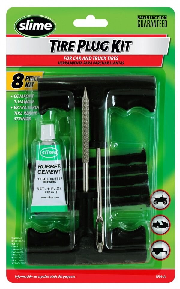

You are correct about MB making money on the tire replacement... The warranty is provided most likely by an outside vendor... So it definitely in MB's interest both financially and legally to fix simply replace it.
I've put about 110k miles between 3 GLs with 21 and now 22 inch tires... I've probably plugged them 7 times without issue.. $8 to plug a tire at the local gas station... I've also plugged tires on my motorcycles without issue.. Again, as long as it isn't on or at the sidewall. (And you didn't drive the tire flat for miles!)
Good luck.
I just noticed this kit is for lighter vehicles..(it was an easy screen grab). But other kits are for cars and trucks.
Good luck.
This was exactly what my dealer did when I had a nail stuck on my left rear of my new 550. Kinda feel like I wasted 21 bucks for them doing it since you can buy the patches.
