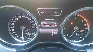

GL 350 CDI Gas Mileage / highway performance
For the first 3600km on my 2015 GL 350 CDI I got an average of 11.1 L/100km (aprox 25.2 Mpg), 70% Highway / 30% City.
Highway speeds are usually between 140 to 170 km/h (87 to 105 Mph) and "normal" driving in the city, meaning that I don't drive either too softly or too agressively.
Driving carefully, trying to keep speed constant at around 130 to 140 km/h (80 to 87 Mph) on the highway the car burns on average 9.0 L/100 km (31 Mpg).
This morning while driving to the office (aproximately 70km) I kept speeds between 160 to 205 km/h (100 to 130 Mph, it's quite impressive how this little engine on a car so big can pick up speed without pressing too much on the gas and if you are not carefull) and averaged 11.1 L/100 km (25 Mpg).
Top speed achieved so far (without instisting for too long, say around 30 sec from about 170 km/h) has been of 230 km/h on flat road and 238 km/h on a slight downslope.
Keep in mind that the Diesel versions we get here are unrestricted (no speed limiter) and due to the very high sulfur % on Diesel (500 ppm) there is no DPF filter on the exhaust system.
Take care,
Alessandro

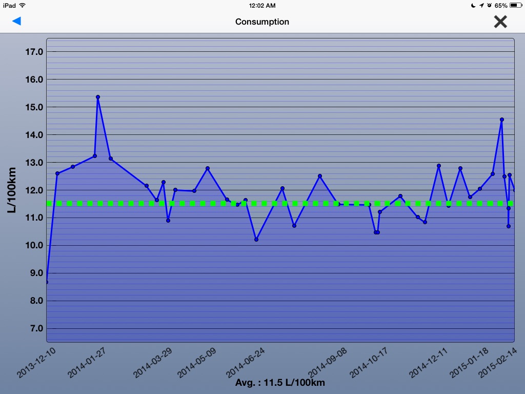

Here is the fuel consumption on my 2013 GL350. 50/50 hwy vs. city. Live in the Toronto area. 11.5L/100 km or 24.6 mpg. I'm pleased with this performance.
