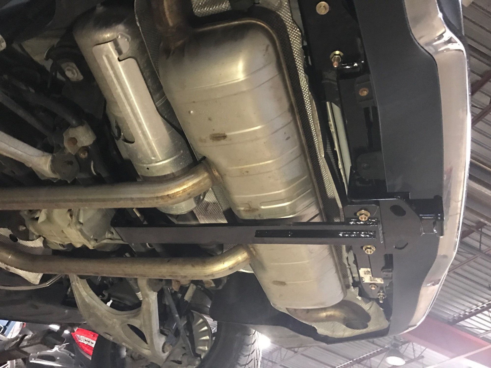

I just bought a 2013 GL450 in Canada ( but it's actually a US car)
Car has a 7500lbw towing capacity apparently. However for a 2013 all of the hitch manufacturers only make one hitch with 3500lb capacity. However for a 2014 GL450 they have a 7500 lb one. They are trying to tell me the body style changed in 2014 not 2013. I obviously disagreed.
So then I called Mercedes and asked them for hitch part number for both a 2013 and a 2014. It was the same part number.
My question is: regardless of what the hitch manufacturer says. Am I safe buying a hitch for a 2013 that the manufacturer says it's only for 14 and up?
Or is there really a difference back there between a 2013 and 2014 GL450?
If Mercedes has the same part number for both, can't see how there is?

Not worried about wiring. Trying to nail down the correct hitch as I need to tow 5000 lbs and curt shows only a 3500lb hitch for 2013 but a 7500lb hitch for 2014. They are telling me body styles are dif. Benz sells a 7500 lb hitch for crazy
Money and it's same part number for both years. So curious why the hitch from curt for a 2014 wouldn't fit on a 2013.

I spoke with curt. They were adamant 2013 was different.
Told them that makes no sense as body style came out in 2012.
Then I called Mercedes gave them my 2013 vin and a 2014 vin and they came up with the exact Mercedes part number. I ended up ordering the Curt hitch listed for a 2014 on Amazon. Will report back if it fits, with the part #.

Just want to report that the Curt 13190 does indeed fit a 2013 GL450 regardless of what the catalogues or Curt tells you. They have their information wrong. Attached is a pic of it installed on a 2013 GL450 although they say it doesnt fit on a 2013. Everything lines up as it should
