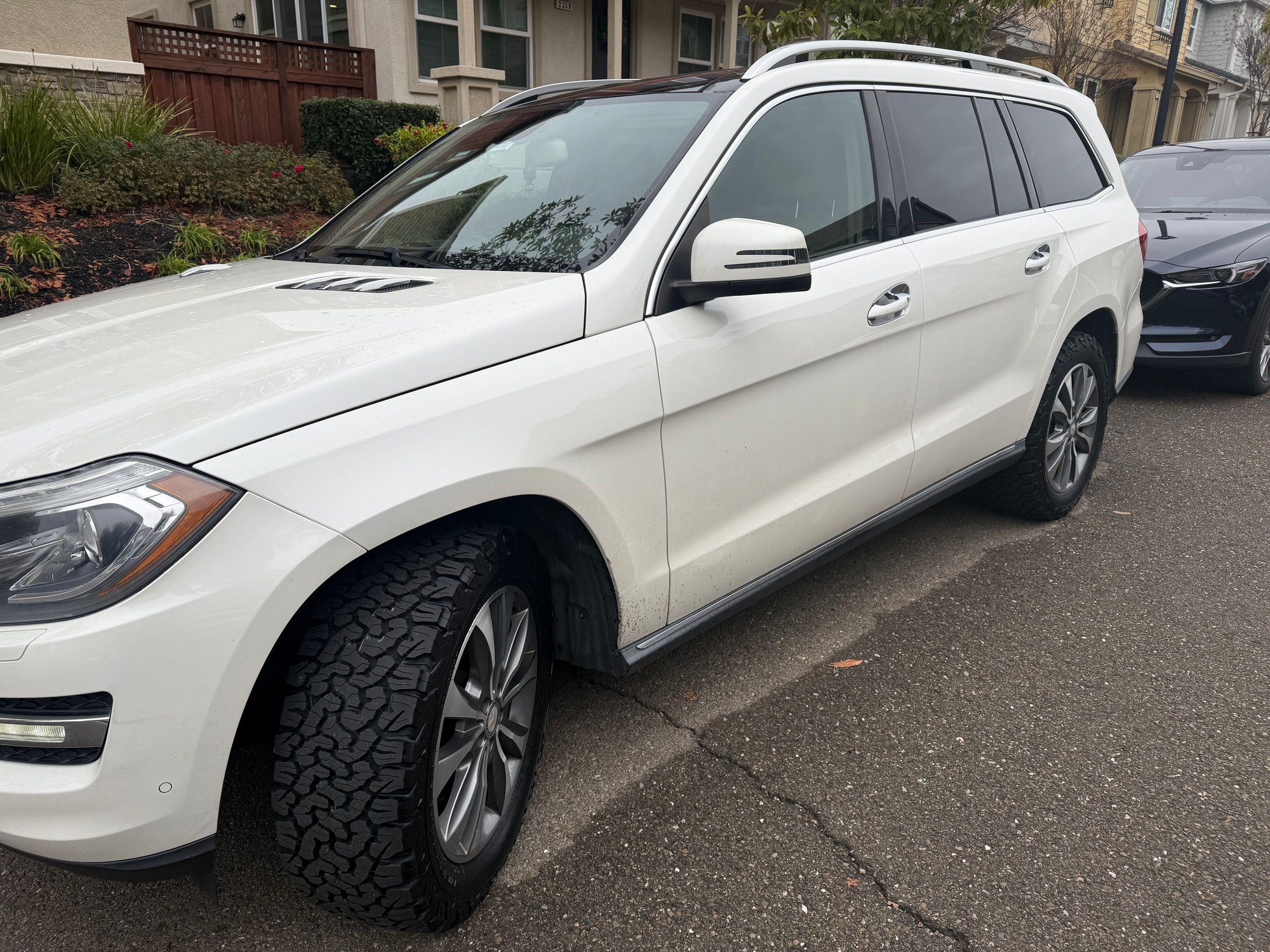

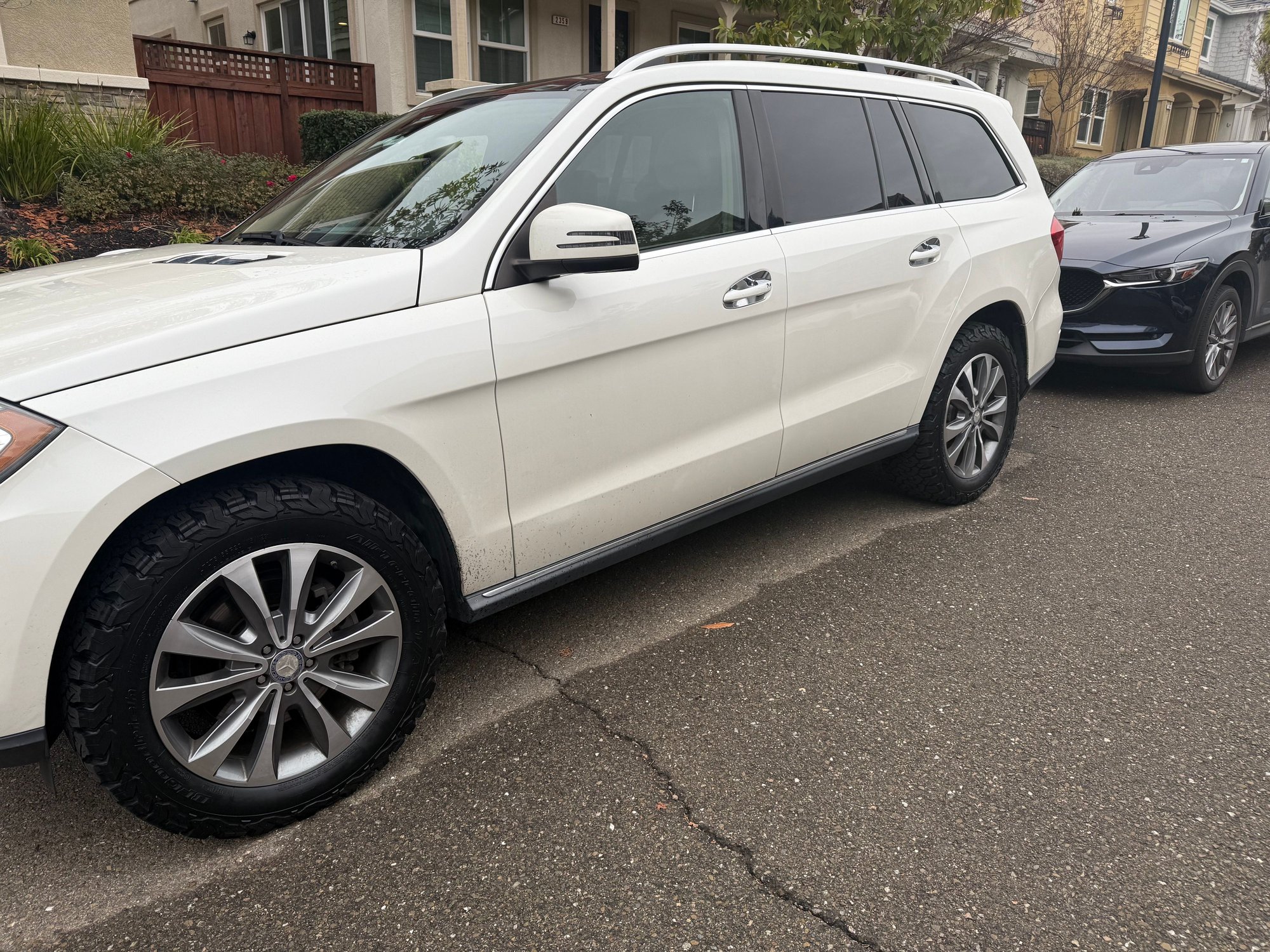

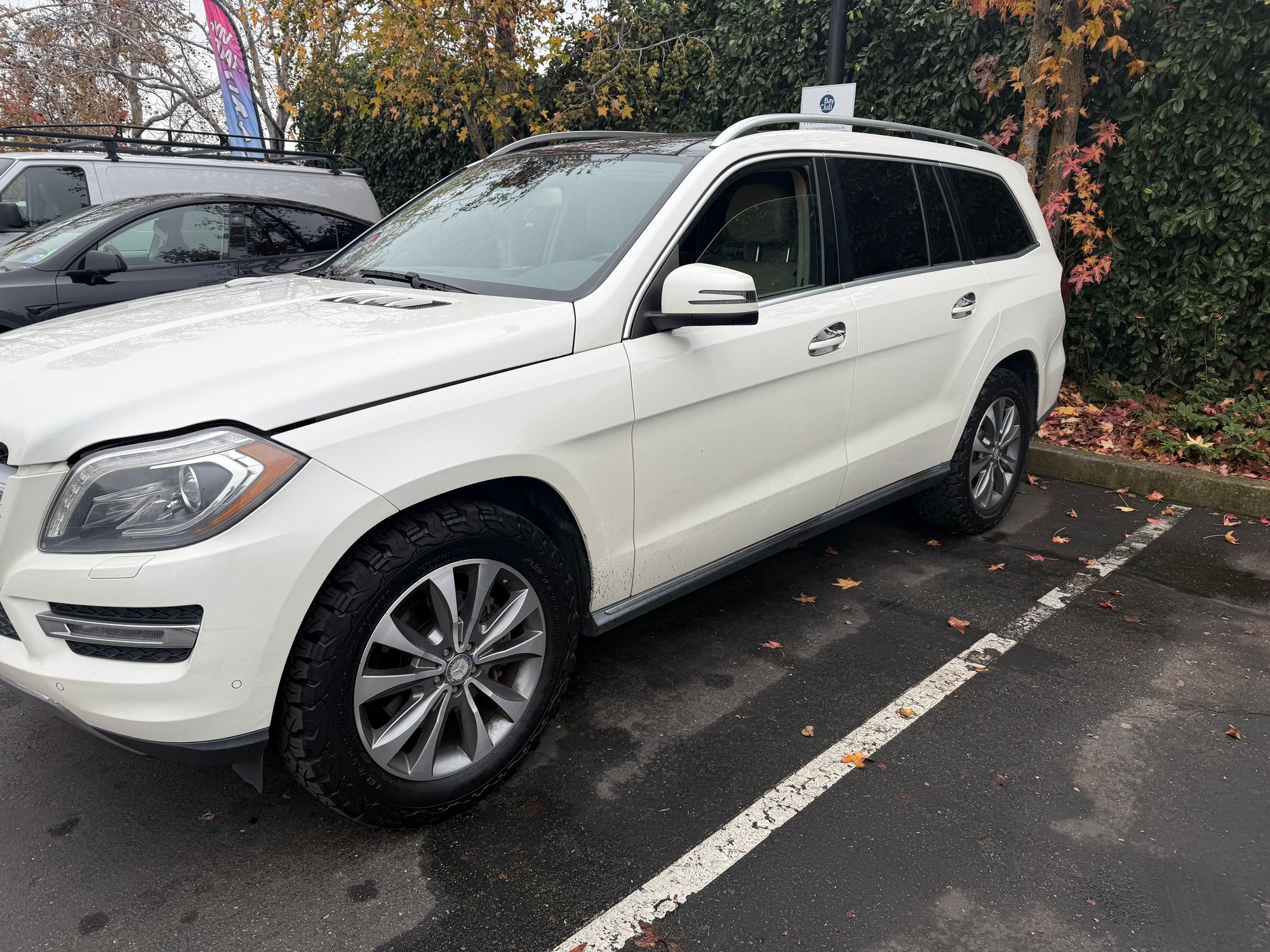

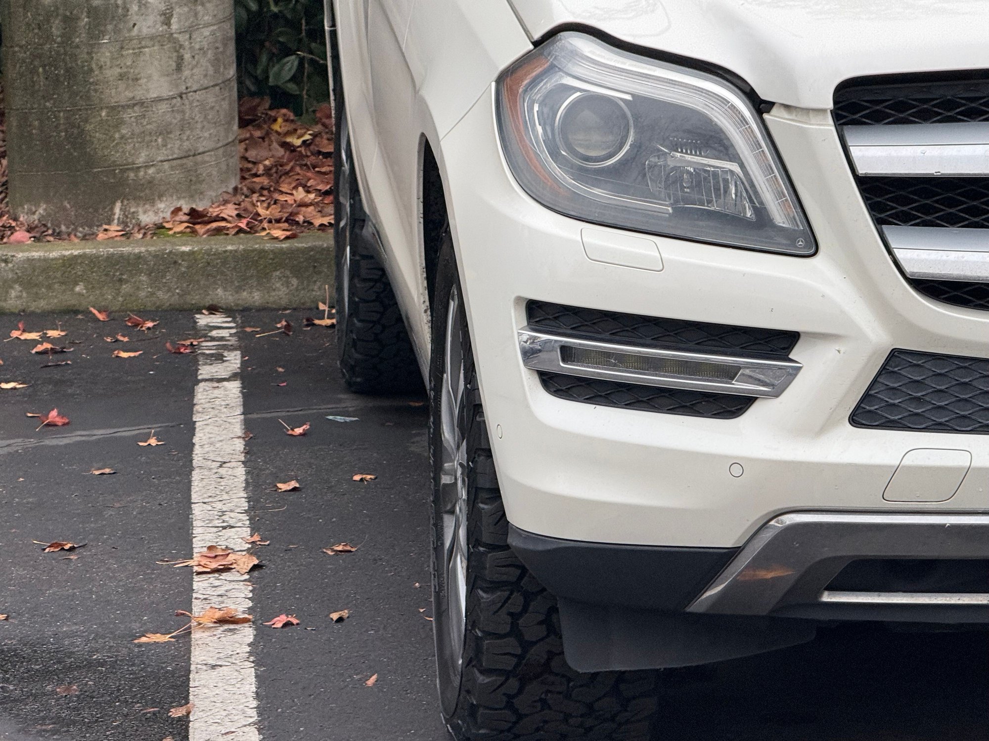

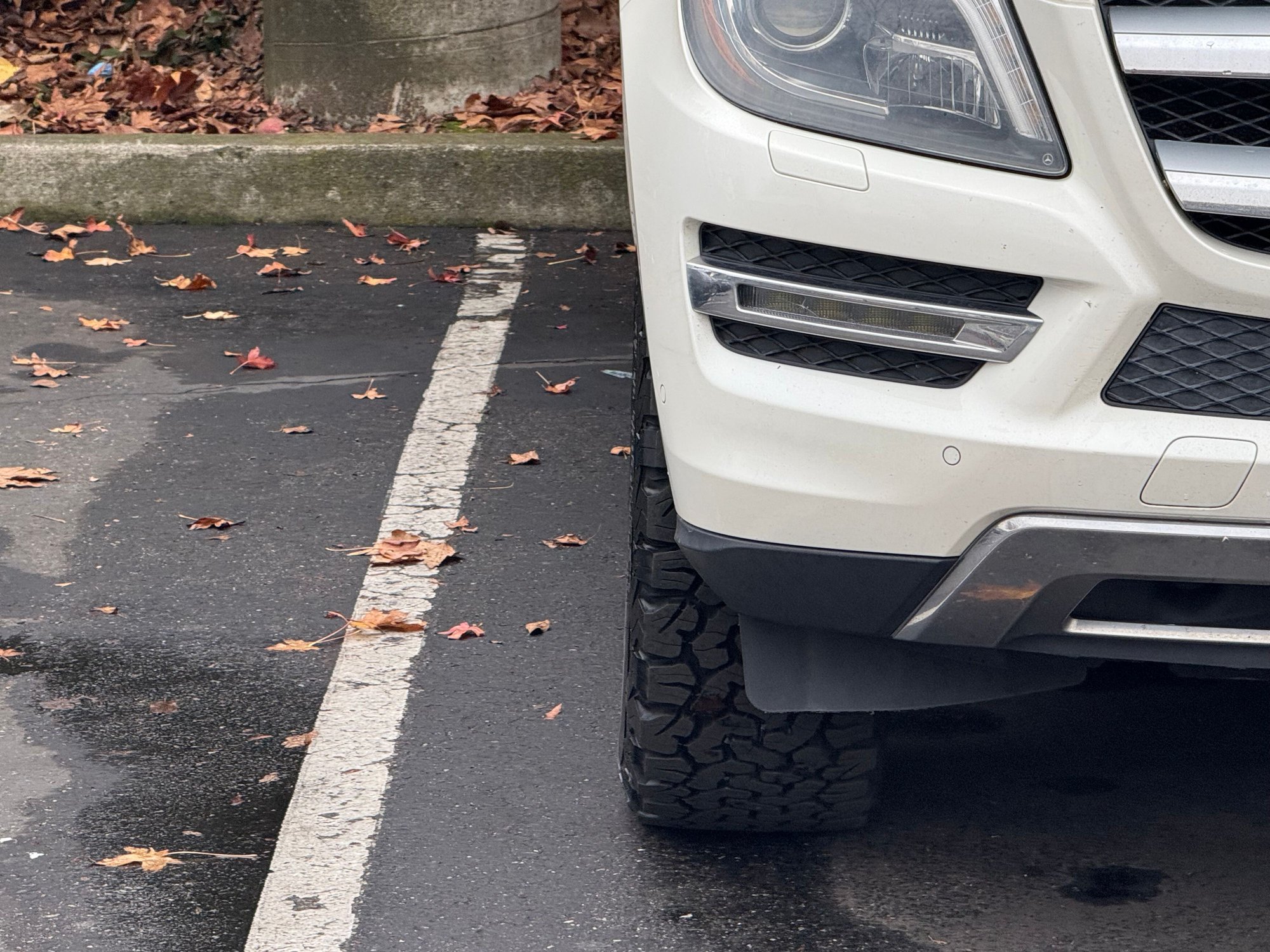

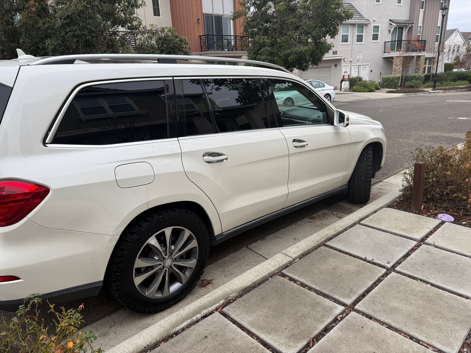

Just sharing as I learned a lot from the forum….
just replaced tires, got 275/55/20…I have 2013 GL350…. I was running 285/50/20 before….the new drive is so much better…please advise what’s the best air pressure settings?
When I was running those I believe I went slightly down from the stock recommended PSI. Google “tire pressure chalk test”. That’s the only way I know of to determine the correct tire pressure with tire sizes and load ratings outside of factory. I was lazy and never did it.
