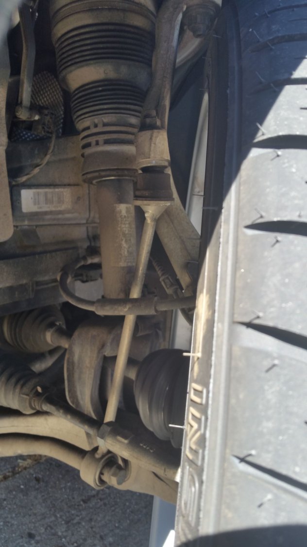

Do you mind turning your wheel while parked at full turn, then look inside the wheel well to see how much clearance you have?
I'm wondering if 295/35/24 will fit.

I'll take a pic and post it but I have to post it later today or tomorrow morning. The wife drives it and I'm not home.

No rub pretty close to splash guard.
295 width tire on my rims will rub on ball joint screw.
It all depends on offset.

Thanks! 295/35/24 would hit the suspension and the fender lining.
My offset is farther out so it won't hit the suspension for me, but it would hit the fender lining.
I will stick with 305/35/23 for now, thanks for helping me out.
