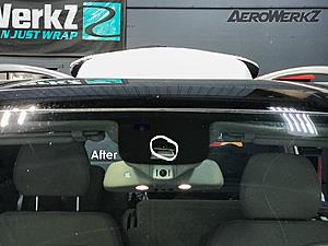

Sorry, I'm using the picture from that thread. I circled where that camera is.

I've the same camera there. And I don't have driver assistance package for active assist. I think that's the rain sensor. There are 2 sensors there. The smaller one looks like a light sensor. Hence I think this is the rain sensor. I could be wrong.
But if you have the ordinary 3D star in front, then you don't have driver assist and definitely not active assist.

Yeah, the smaller one is the rain sensor.
