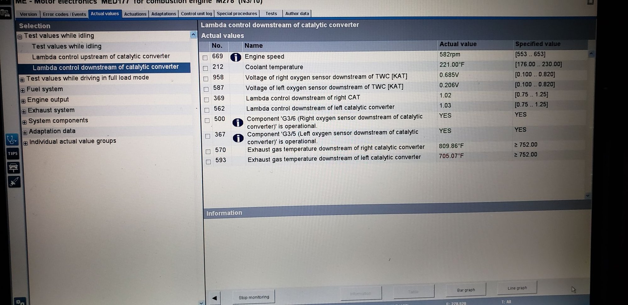

More info. So since the last post, the intercooler issue is resolved and now the IAT temp is proper. However, the car was still running rough and LTFT1/2 are still negative with LTFT2 very negative. Next I took the car to a well known Mercedes tuning and repair shop. They diagnosed and told me the injectors are probably fine and that spark plugs needed to be changed. I went ahead and did those as the car has 65K miles. No change in LTFT1/2. After doing a lot of research, I noticed that the left o2 sensor (downstream) values did not look right so I went ahead and changed that. This actually has made the car run a lot better, but still there is no change in the LTFT1/2 numbers. See the screenshots from Xentry. After changing the O2 sensor, the left downstream O2 sensor waveform (blue line in the image) has gone from being a flat line around 150-200mV to being this oscillating waveform (I thought it should be flat around 500mv). So the car is running better but this waveform does not look right. Also, the right O2 sensor waveform (pink line) is completely different from the blue line which does not seem right.
Also, if you see the lamda control screenshot, you see the exhaust gas temp downstream on the left side is out of the accepted range and not in line with the right side temperature. So even the car is working better, I think there is still something wrong here. Any ideas? Catalytic converter? Still an injector problem? One thing is that after replacing the O2 sensor on the left side, I did not pull the battery terminal to reset the LTFT values. Do you think I need to do that?

BLK GL550, Thanks for the post. I don't think there is oil contamination, because I did not see oil on the O2 downstream sensor that I replaced and I looked at the cam position sensors and did not see any oil around there either. But having said that, I did see green grime on the side of the transmission body near the left exhaust and CAT and that looked like it was from the coolant leak I had. I don't know if any of this got into my upstream O2 sensor, so I am thinking of replacing that.
Before I replace, I had a question: Does any one know what sensor reads the "exhaust gas temperature downstream of left CAT" that is shown in my picture above from Xentry? That is showing out of range and I am wondering what sensor would give me that data. Because I don't think there is an EGT sensor in a gasoline engine. Maybe it is that sensor and not the upstread O2 that is my problem?
