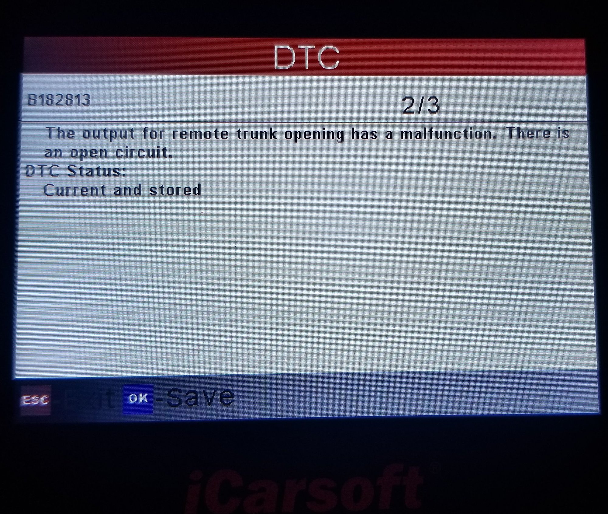

I ordered a icarsoft reader. It noted the below error code:

N121/1 liftgate control unit is mounted to the right rear side wall behind the right rear trim panel.

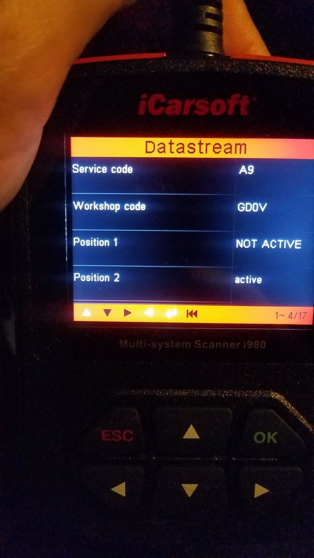

If I can jump on this thread, I have been dealing with the same issue. I put in a new small battery in the trunk, the fuses are good, etc. I got an Icarsoft I980 and have the below codes. I cleared them thinking it could just be a fluke. not that lucky.
What "close trunk lid" button do we think that is? The one in the drivers door, or the one in the rear compartment? Hopefully not the one in the trunk its self. if i push and pull on both buttons, the trunk will release but not actually open. I have to open and close it manually. It sounds I am manually moving the motor, gears when I do this.
Would the dealer software give better info?
Also, should the Icarsfot I980 be able to reset the service interval? I cleared the codes and I still have the A9 code showing on the dash. Is there a way to clear codes?
Finally, does anyone know what the Position 1,2,3,etc are on the Icarsoft?
Thanks for the help.

To find out which button is problematic, do multiple tests of opening/closing to narrow things down.
- key fob
- driver's door button
- button on inside of liftgate
- button outside of liftgate above license plate
The generic suggestion for diagnostic systems is to use Xentry/DAS. Other systems will work, partially.
