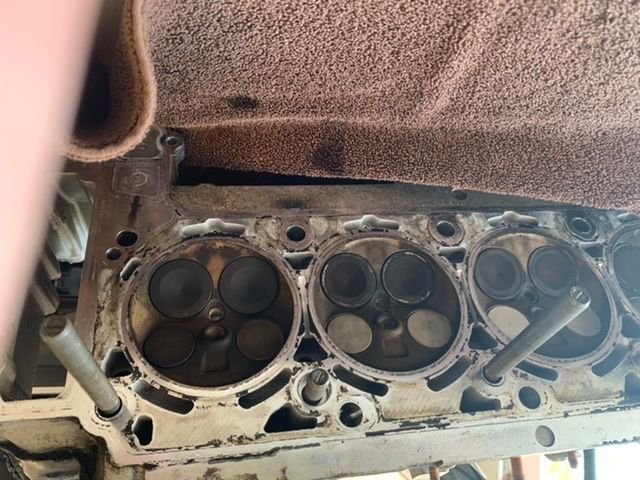

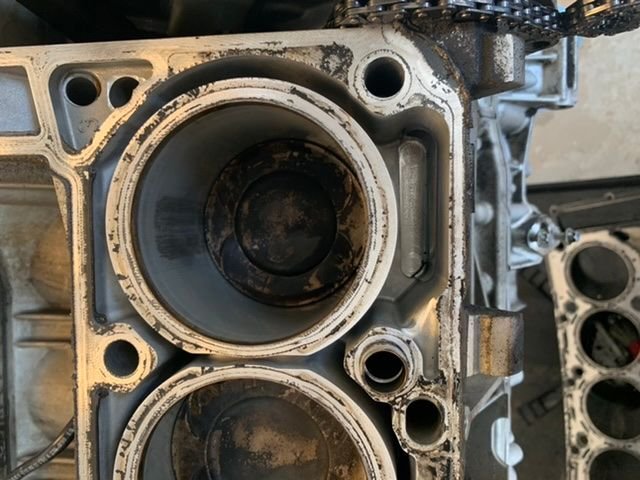

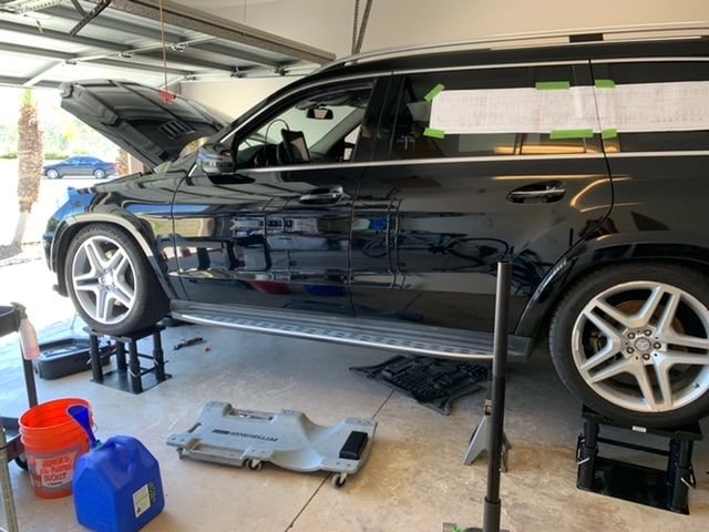

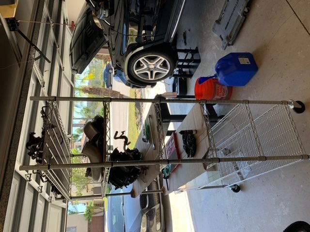

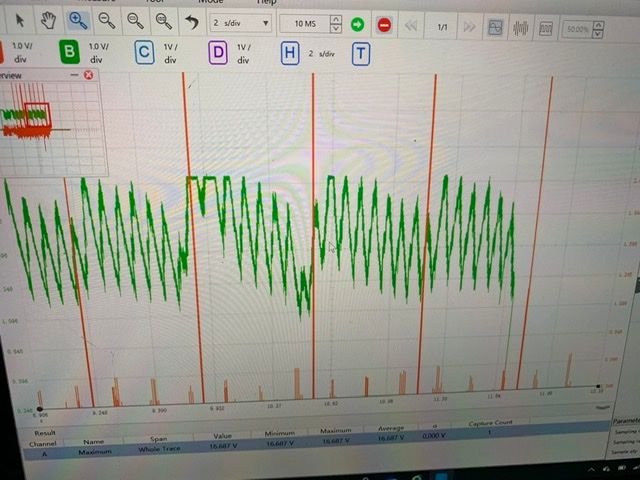

Hey y'all, thought I would share my build. It is a 2013 GL550 with 110,000 miles that developed a misfire on #1. After a relative compression test with an oscilloscope it was time to pull the engine. Pulled from the top, no bumper pull, no lift.

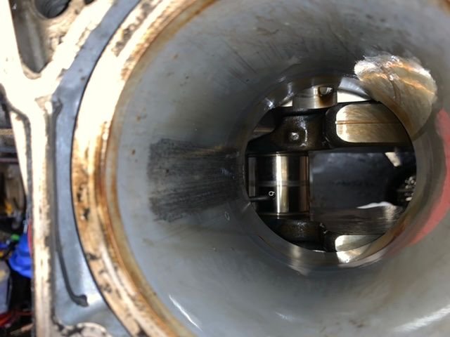

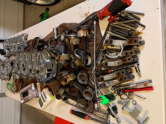

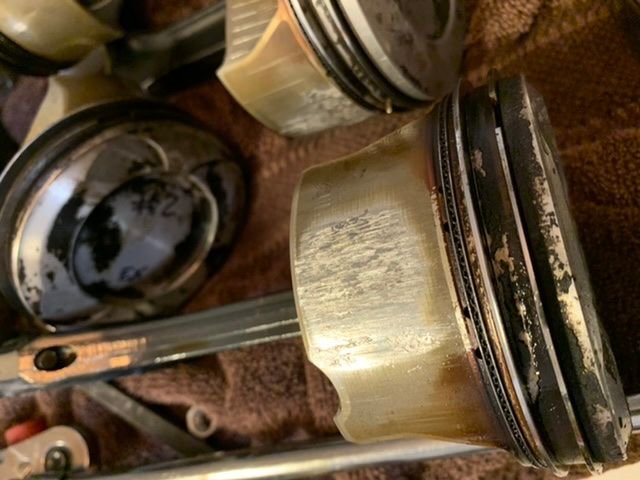

so upon tear down we see the ring seizure and oval piston.
so I decided to go with the Darton MID sleeves to close the deck and get better cooling with a wet sleeve. They only make it in the 98mm for M157. After research the M157 is almost identical to M278 with the exception of the bore and stroke, rods and pistons and head gaskets. A few of the pistons have oval shape so instead of the crappy stock rods I'm doing Italian rods and pistons with ARP bolts that are 10% stronger than 300M rods and 2618 double bridge forged pistons.
I'm working with Gulf Performance in UAE for the rods and pistons as they have done a ton of these 63amg rebuilds. This will be the first conversion of a 4.6 to 5.5 liter. If you want you can follow the build on my IG account rolleymotorsports.
