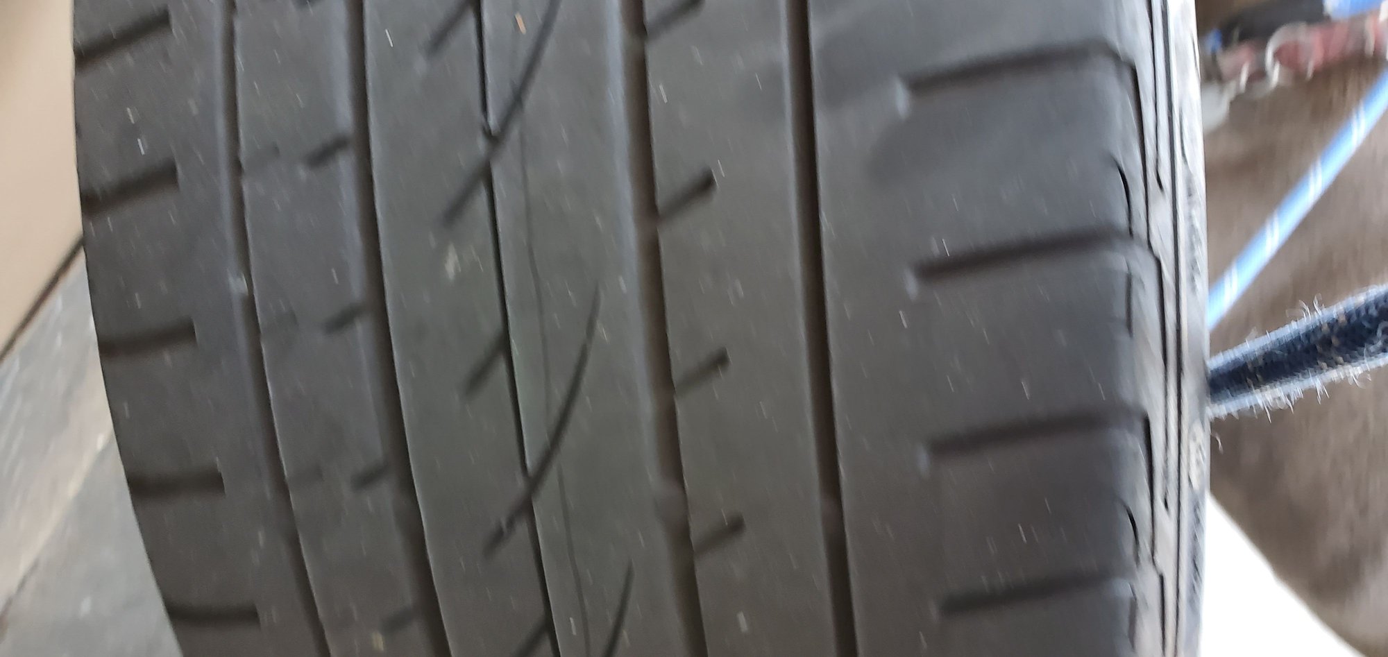

I do not understand? 2013 GL550 4Matic 128,143 miles.
Rear tires down to 3/32 tread only after 8,449 miles? Front tires are perfect normal wear.
The majority of my driving is highway at 65 to 75 mph.
Front air struts and rear airbags were all replaced prior to mounting these Continental tires and also a four wheel alignment and speed balance was done.
I'v beed told that no one can help me at Continental Tire or American.
Anyone else have issues like this?

I don't know. To me it looks like feathering in the tread pattern indicating an alignment problem. Did the previous tires wear as quickly?
