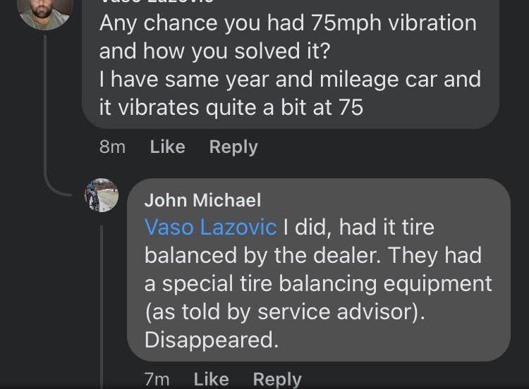

just seen this ad on facebook and asked the guy he has same car and same mileage so ill try this

this did solve my problem,very happy,key is in matching high and low spots on tire and wheel so called road force matching,
