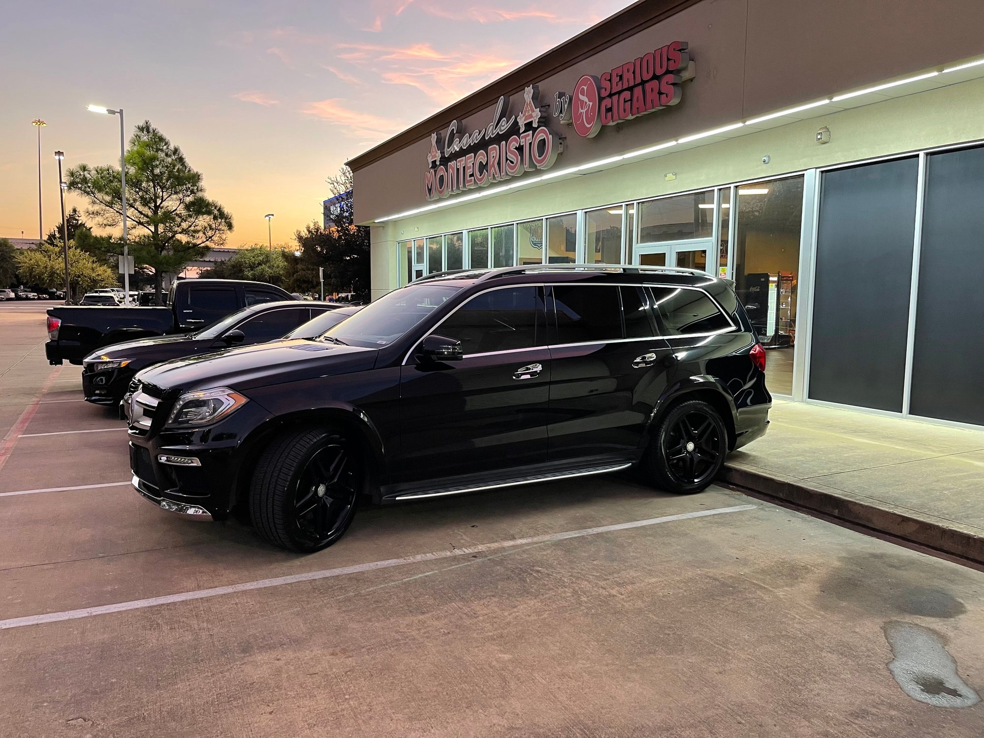

thank you for the reply.
here it is a pic.

Looks nice all black. If planning to keep for the long haul, definitely invest in getting ALL fluids replaced for piece of mind, as mentioned!!

Looks great!
