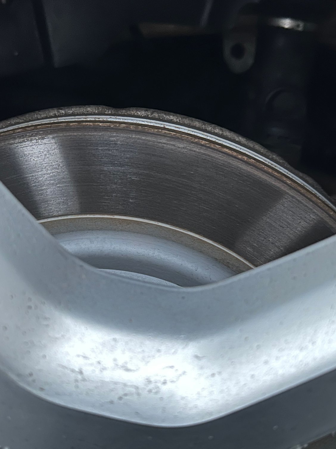

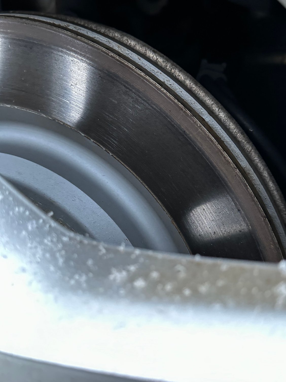

Okay, so I’m pretty sure we have the same spec’d or very similar spec’d GL’s. I just checked mine and the front rotors are indeed vented, and the back ones are plain, which just looks odd after finding this out. Never really took a good look at them before.
Now I’m wondering, can I order the vented rotors that you mentioned and replace the plain ones? They’re the same size 345mm.. don’t think there would be any issues.

In post #2 above, the rear part numbers provided are for the cross drilled rotors, which were optional on some early GL models with P31.
Non-AMG GL's rear rotors are 345x22, not 345x26. To fit 345x26 requires replacement of rear brakes, and while calipers are the same, pads must be specific to 63 (which are 2mm lower per pad to account for 4mm thicker rotor).
Also it needs to be said that replacing MB stock pads with any after market ceramic pads results not only in reduction of dust but also in (sometimes significant) reduction of initial braking byte (I will live with brake dust but would not give up initial biting force).

Got it. I’ll probably order the plain rotors for the back since it came that way from the dealer. Not sure yet since either will fit, 345x22.
How noticeable is the initial braking from other pads compared to ceramics? Akebono is pretty well known for their ceramic pads. Let’s say if we compare Brembos to Akebonos, not too sure which to go with now.

My recommendation is to stick with the plain rear rotors if that is what you currently have. Akebono pads are my recommendation as well.
