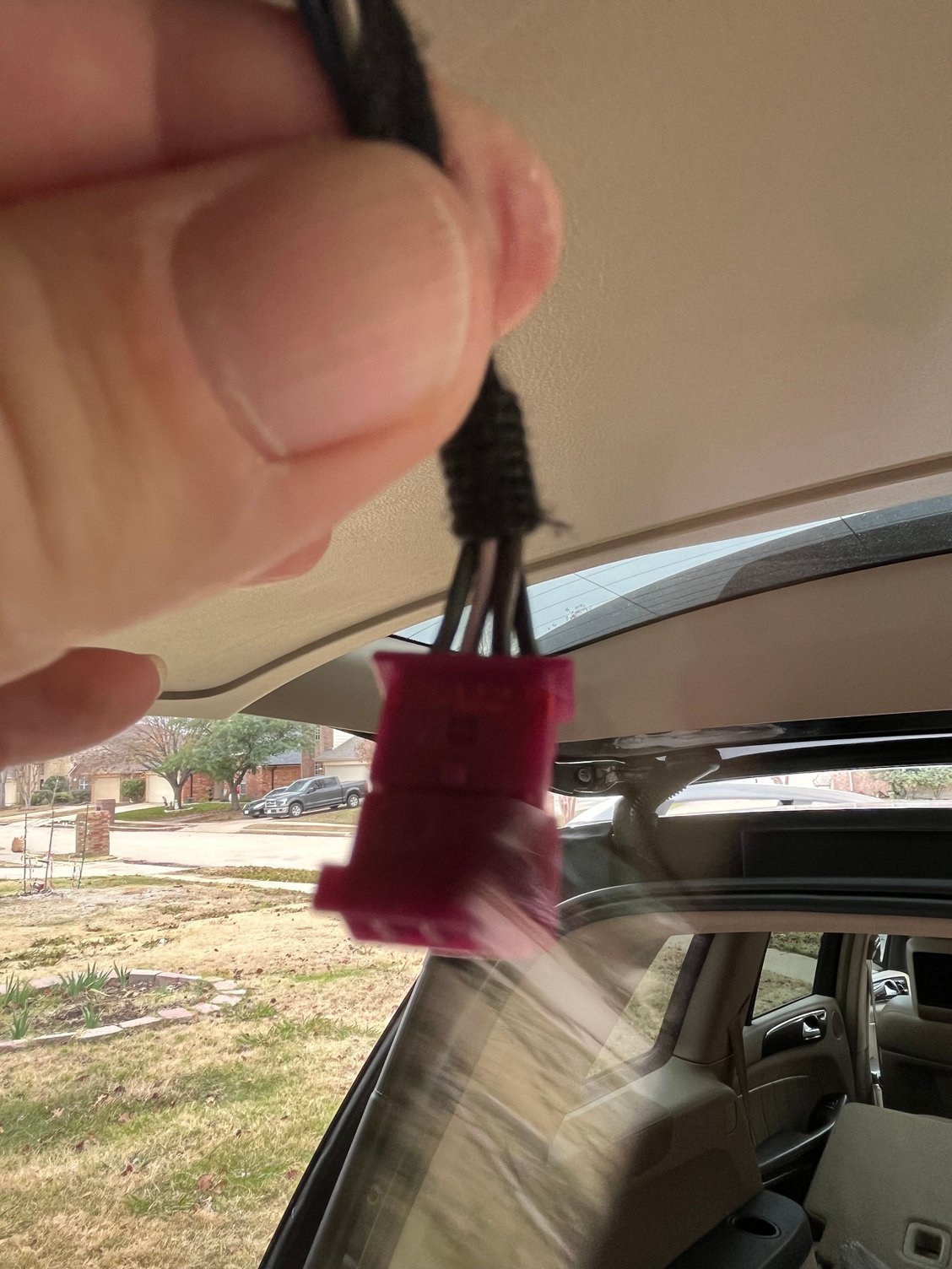

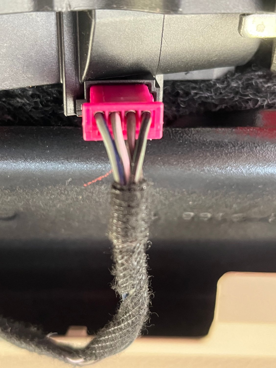

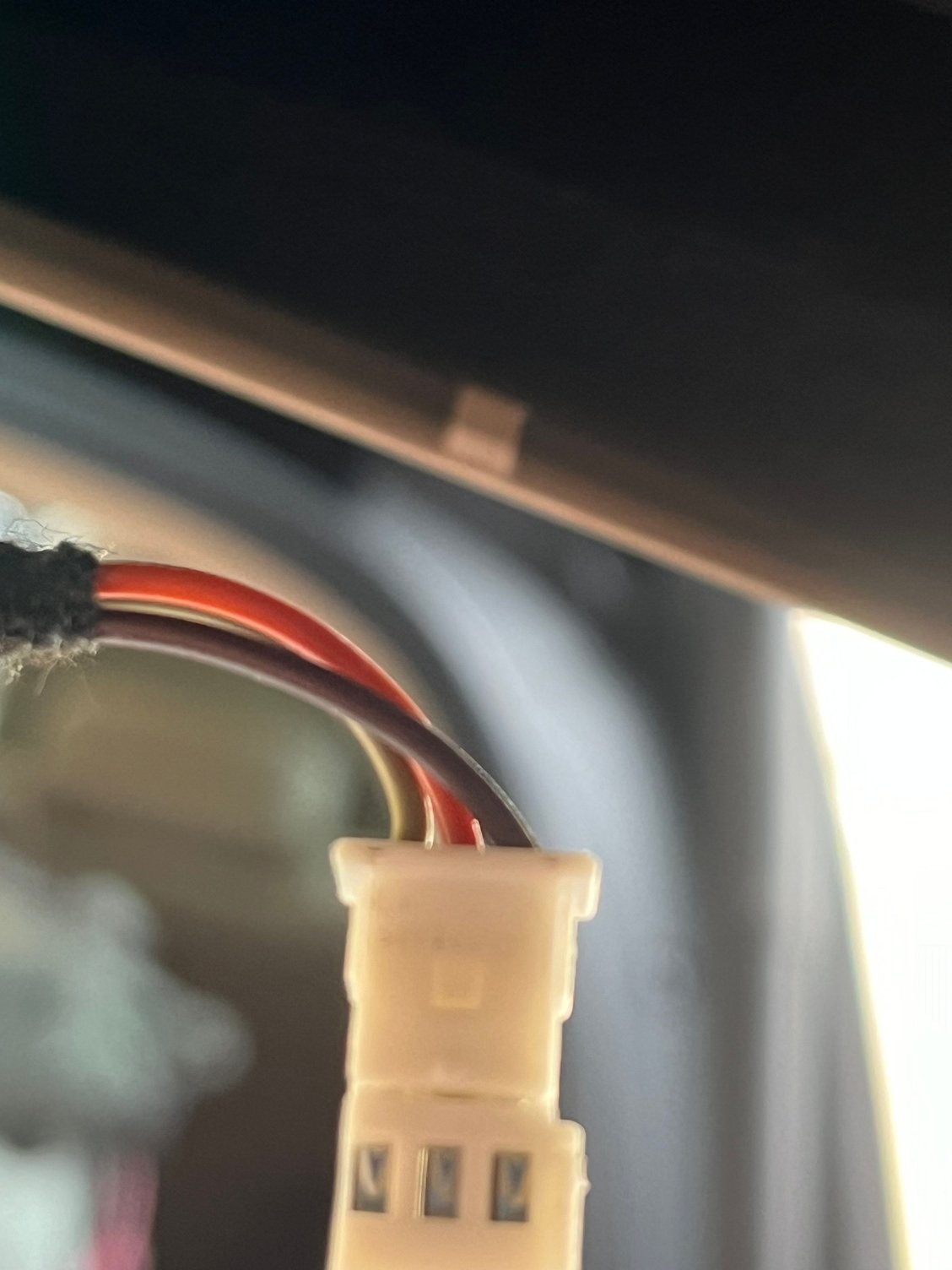

Glad I could help. Just a recommendation - be careful when unplugging the wiring harness connector from the button that lowers the liftgate (the button on the tailgate inside the car) - the connector on mine was brittle plastic and broke apart and now I've spent hours trying to figure out what part I need to repair that. My mechanic quoted me $450 to replace the entire wiring harness and I can't determine whether I can instead just buy the little plastic connector that likely costs $0.25. Actually now that I type that, could you please take a few pics of that connector and the wires (esp the order of the 3 wires that plug into the connector) and attach the pics here? And if you happen to gain any insight on where those wires go/what the larger part is without doing any extra work, that would be extremely helpful for me to know. I can't figure out with my searches online how to buy the little plastic connector itself or what the larger part is that the connector attaches to. Thanks and good luck with the lock actuator, I think you'll find it really easy to replace.
Gladly!!
Chad

Glad to hear the repair went well and your wife's liftgate works again. And thank you so much for the pictures, those are extremely helpful! I know what the white pin connector is since that's the part I'm trying to replace, is the red pin connector what's on the other end of those wires? So it looks like it really is just a wiring harness. And if so, any idea what the red pin connector plugs into (even a guess would be helpful)? I've literally spent hours trying to figure out what part I need to order and replace. Thanks again!
Edited to add: never mind on my last question, my mechanic was able to order the pin connector thanks to your pictures (it costs just a few bucks) and I'll assemble it next week. Thanks again for your pictures, they're a huge help!
