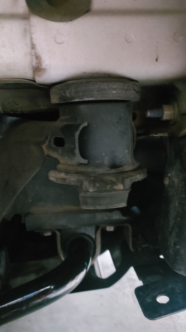

I chased terrible bouncy noises at the front-right corner for a while, very loud in the car. Re-replaced much of the front suspension, there were a few worn bushings. It got slightly better but the noises remained.
With nothing else remaining, I went to do a warranty strut replacement. Pulled away the fender liner and see an obvious gap on the front subframe bushing. Just to verify, jacked up the subframe and saw the gap close.
Preparing to replace these now. I think I can raise the air suspension with the car on ramps, suspend the motor from the top and unbolt the motor mounts, then drop the subframe slightly using a transmission jack to replace the bushings without having to disconnect brakes and steering.
Feels like a good plan, if any of you have done this job please comment with suggestions or tips. I'm mostly curious about how easily the bushings go in/out of the subframe? On my W211 I replaced the rears and it was a complicated process to press them in both directions.
WIS doesn't say to replace the bolts, which is a surprise, I'll probably replace them anyway.

I took more time and found the WIS document, they called it "replace front axle carrier bearing"
Top of the fronts has to be knocked off, the rest are pressed with special tools.
New tentative plan: buy used subframe, replace bushings with no rush, brief car downtime to swap subframes.

Possible to share WIS pdf? I too am preparing to replace all suspension parts on my 2014 GL550 - this is the first I’m reading or learning about “front axle carrier bushing.
possible to share photo(s) of this subframe bushing?
thank you.
Yep I'll post the PDFs later
Front passenger-side

I went under the car to "game-plan" the replacement, and just check the mount bolts to make sure they weren't slightly backed out or something (the engine had been dropped by MB for warranty repairs).
The subframe mounts have some cracks, but I also noticed that the motor mounts are completely collapsed, just a year after I replaced them. That is far more likely to be the source of the noise, so I'll swap these first and see how things are after that. I'll avoid working on the subframe unless it does present something worse than visual symptoms. But I'll still come back and bring some PDFs relevant to it.
