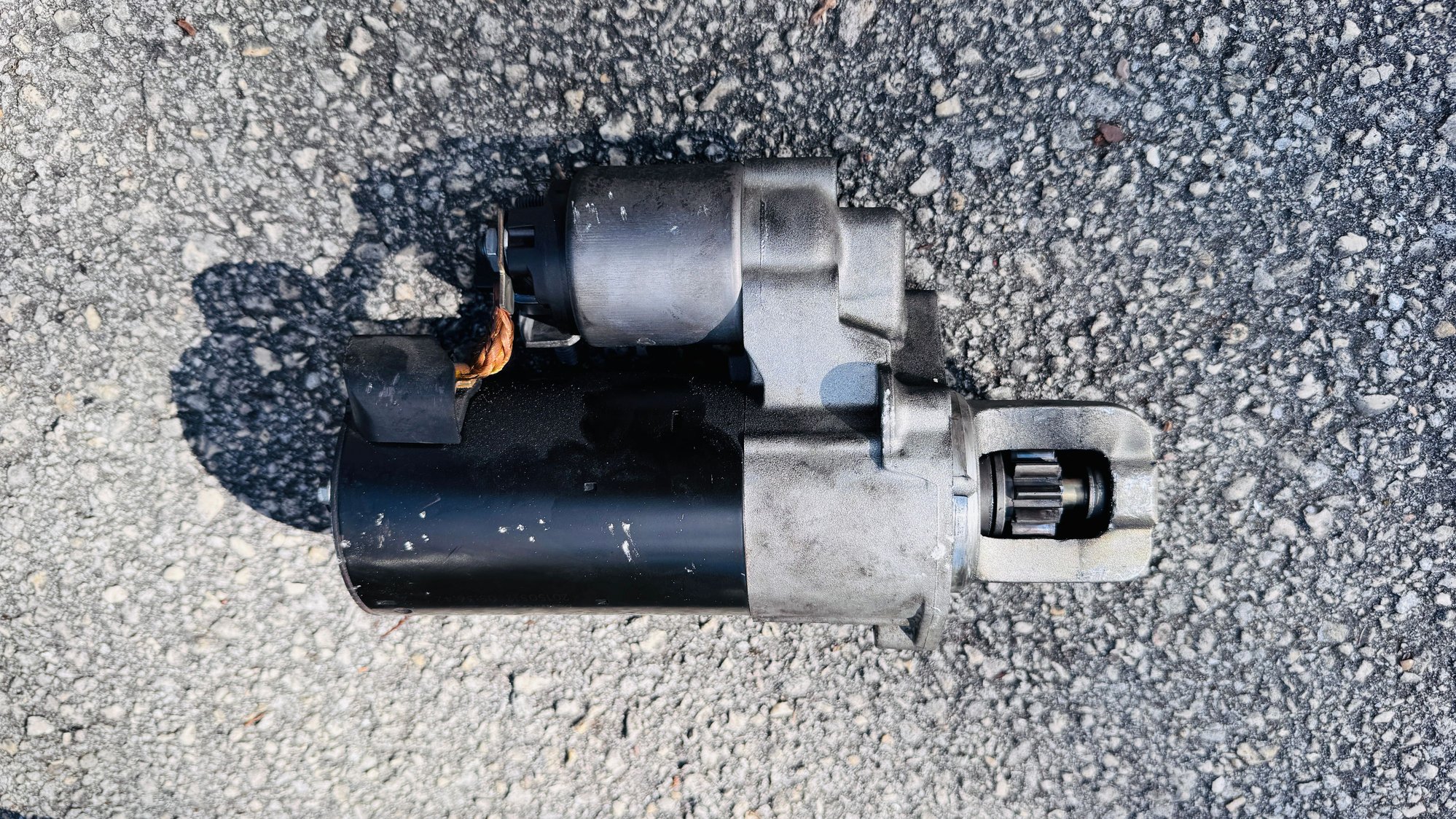

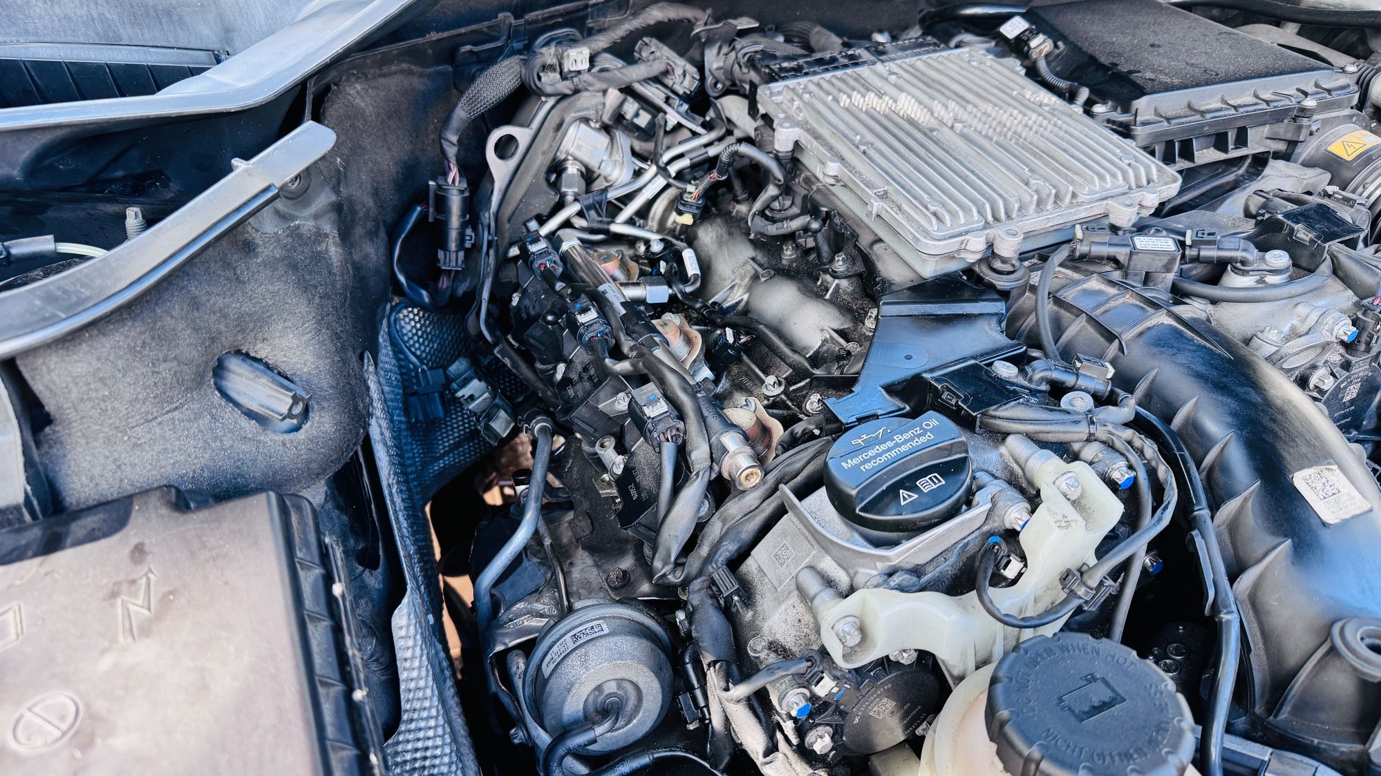

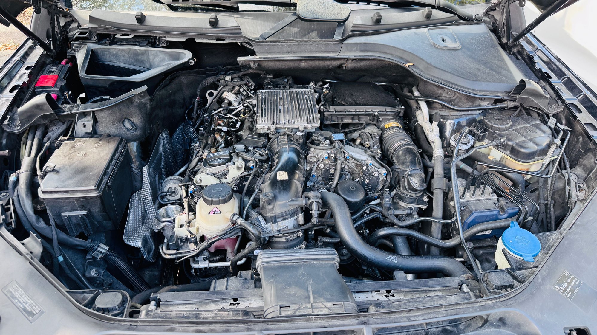

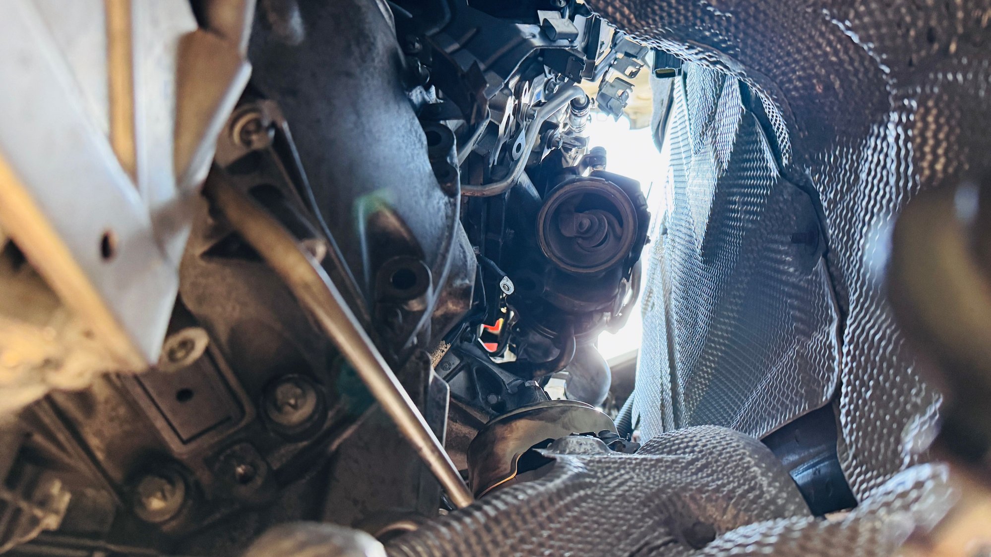

I'll post some pictures I took of how it look when everything is removed (including the starter). If any of the explanations are not clear please ask and I'll try my best to clarify. Good luck all!
