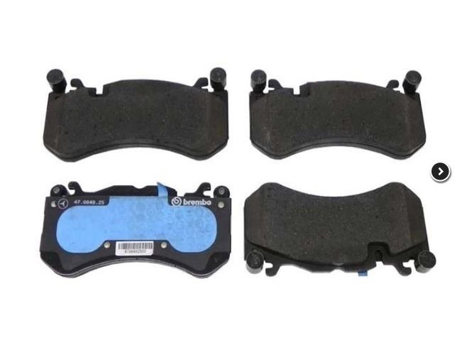

Looks like 008-420-20-20 has been superseded by 000-420-66-04.
https://www.benzparts.com
Below is the 000-420-66-04 stock photo. They have Brembo logo?

Yes Brembo stamp/logo on front pads is correct. Pads look identical to Brembo stamped 008-420-20-20.
Also, agree with your previous post regarding rear pads. AMG's compound has to be completely different hence the price. BTW, there's no "AMG" stamp on rear pads as was suggested earlier in the thread to justify the price. Just because GL/GLS non-63 rear pads fit (all GL/GLS use 345mm rear rotors, its the thickness of the rotors that is different), does not mean they should be used for GL/GLS 63.
