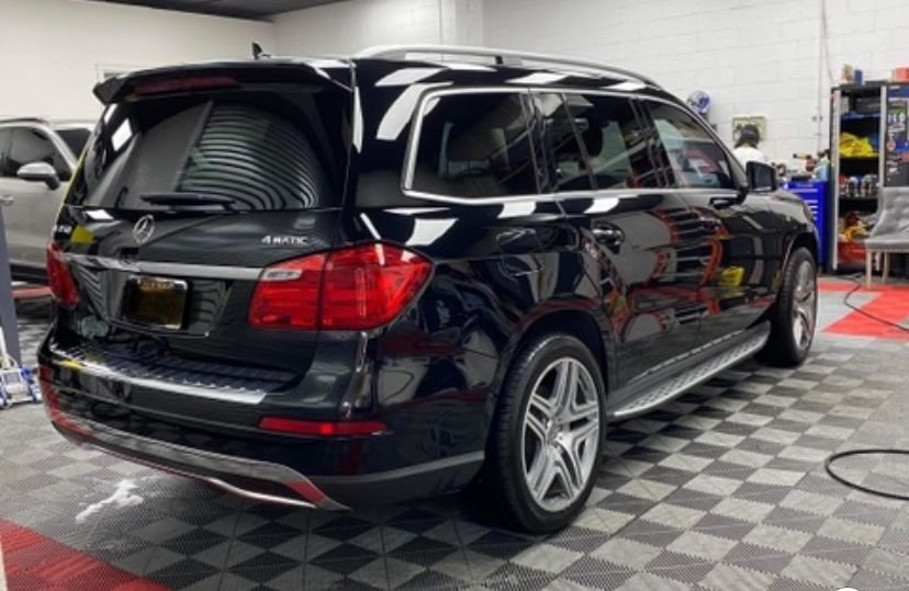

Should I just swap a GL63 into my 450? Or a 550 long block
I’ve had my truck give out at only 53,962 mi the engine went on it and has been sitting down since Oct and last driven in July mechanic gave me the run around and refuses to help me and only wants me to get rid of truck. I refuse to get rid of this truck as it has priceless value to me as it belonged to my belated Dad rest in Paradise. He loved this truck as it was renntech powered truck was a blast and used to take off like a rocket ship.
