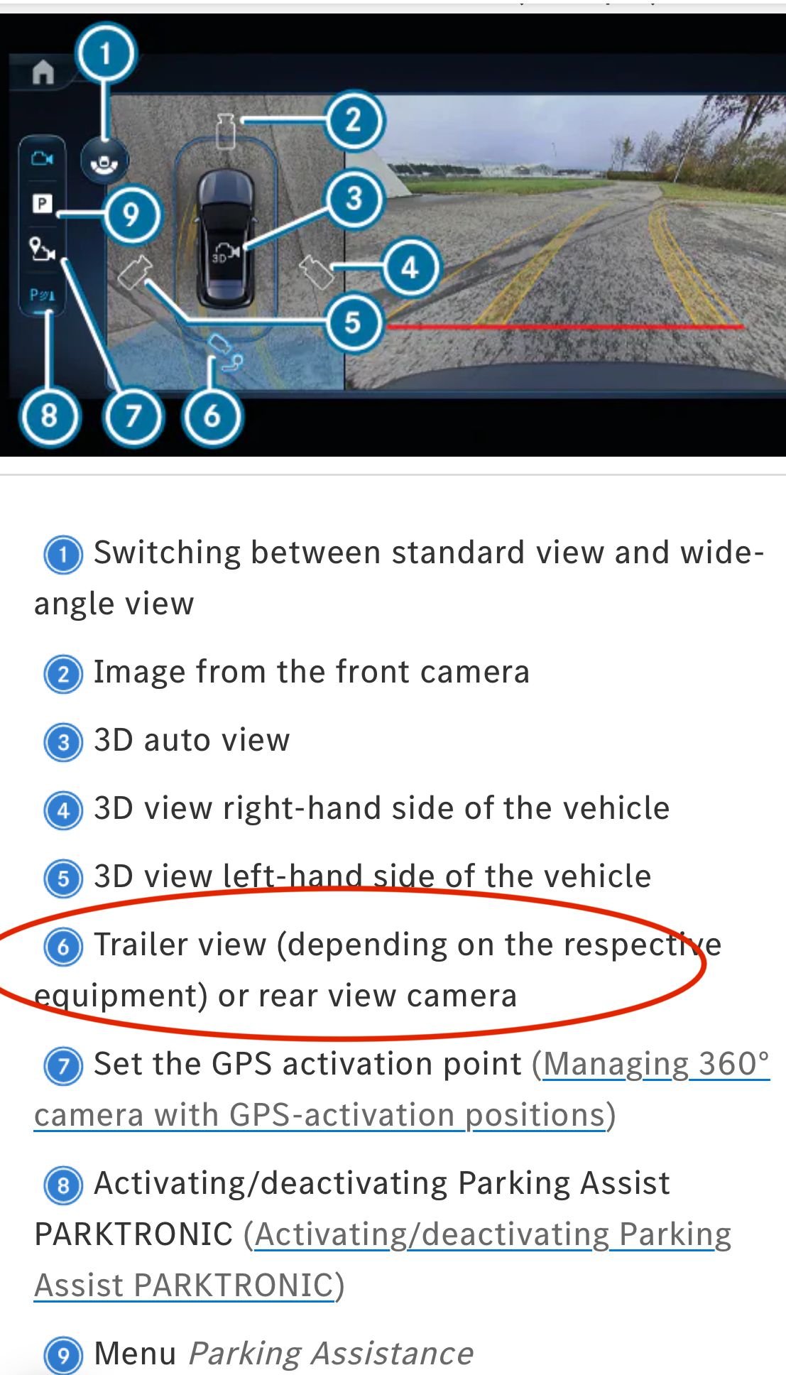

If you can access the vehicle, activate the 360 camera system. If there’s a rear view mode for towing, called trailer view, then you can be pretty much certain it has the OEM towing package.
