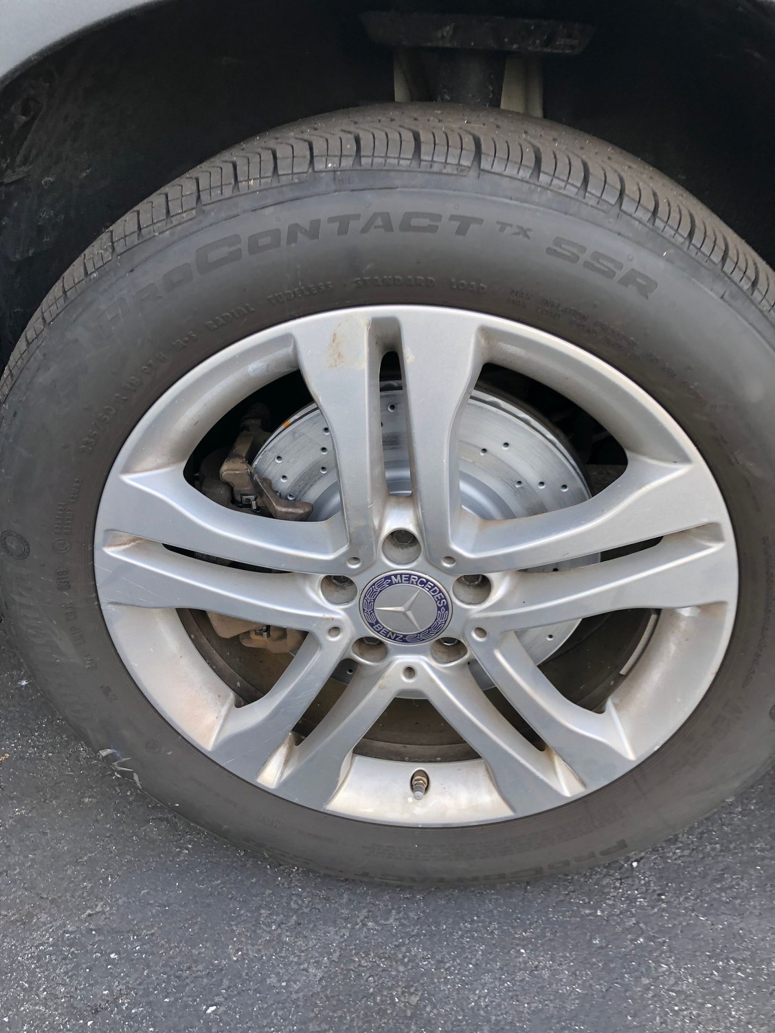

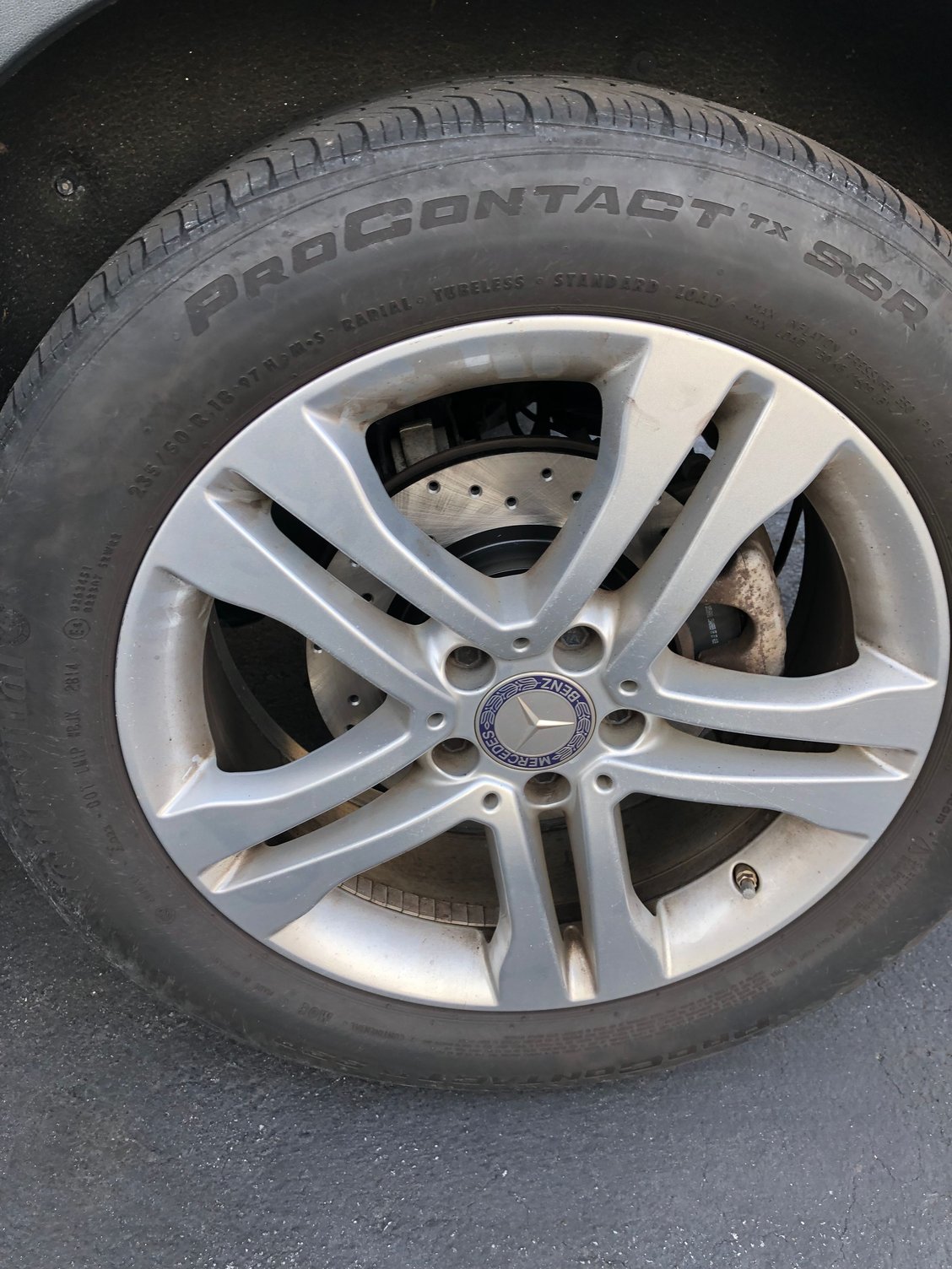

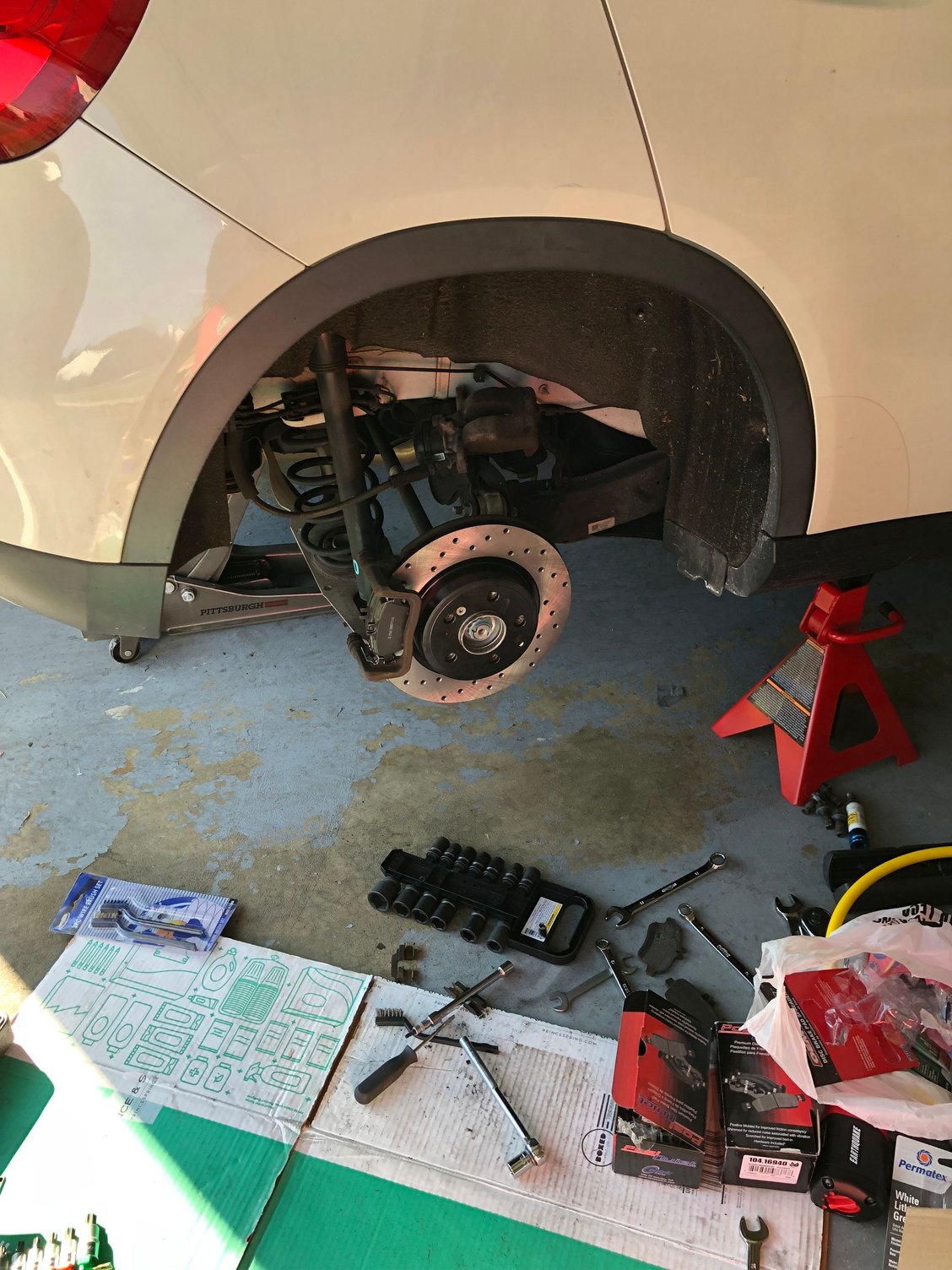

Finished was an easiest job ever took me 2 hours

I wanted to know if you needed to do anything for the Electronic Brake?
How did you do the rears with the electric parking brake?
I am only doing the rear rotors and pads....so no wear sensor wire for these i believe.

for the rear electronic brakes you have to do the trick
before press the park button keep pull the electronic brakes release then press park now you have the car in park without the electronic brakes on
everything else is really easy

How did you get the brake disk off after unscrew that set screw? dose it come off by itself?
Old Feb 4, 2019 | 05:35 PM
BlackieAMG's Avatar
Joined: Jul 2013
Posts: 90
2008 cl63 amg/2015 gla250 4matic
Yes mine just fell off by itself after unscrew it
