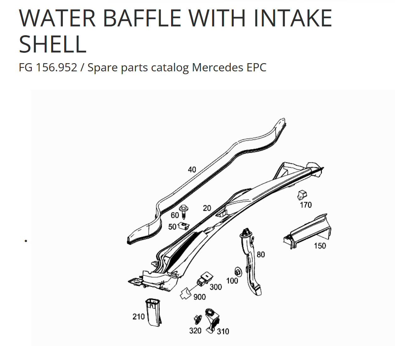

The second one (which is stage 1 of the filtration system) is usually where the battery is under the hood, the one you mentioned is stage 2 of the filtration system.
Old Jun 8, 2025 | 09:37 PM
ChuangTzu's Avatar
Joined: Mar 2024
Posts: 618
Likes: 241
From: Chicago
19 GLA45, 86 560SL, former: 14 E550 4Matic, 09 E350 4Matic, 83 240D manual, 78 450SLC, 81 500SLC
I don't think there is another one in that area... It seems to suck air from straight under the drip tray.
Apparently this fills with leaves and sticks and they get sucked into the fan and it pisses people off. Good thing I'm in the habit of vacuuming my car's external nooks and crannies.
