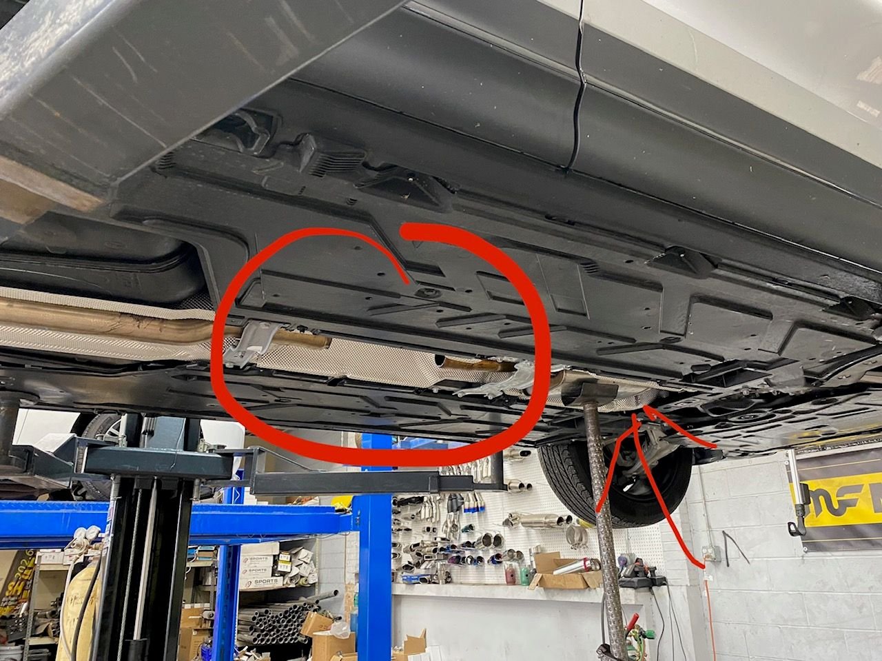

So I wasn't too impressed with the 35 exhaust sound. It is too quiet for my taste. Just got back from a reputable exhaust shop and got the resonator delete (red circle). The guy was telling me to also remove the secondary cat but I told him I want to hold off and see how the car sound first.
As you see from the photo, the arrow is the secondary cat. I think the car sounds much better as is now. No drone and more grunt at all RPM. Best $80 spent.

Also, are you sure the box at the back towards the rear axle is actually a secondary cat, and not actually a muffler? The shape of it to me looks like a muffler than a cat (which is usually cylindrical in shape)__PRESENT

Just bringing up this thread again - I modified my GLA35 exhaust (which is same exhaust system as the GLB35) and it sounds 100000000 times better. You can read up on it here and I've also included some videos.
Also the square box that the OP has an arrow pointing to is not a secondary cat, it's actually just a front muffler which for some reason, MB/AMG decided to throw on the GLA35/GLB35 exhaust system to really neuter the sound. Remove that and you should probably have some pops/bangs and a more aggressive tone.__PRESENT
