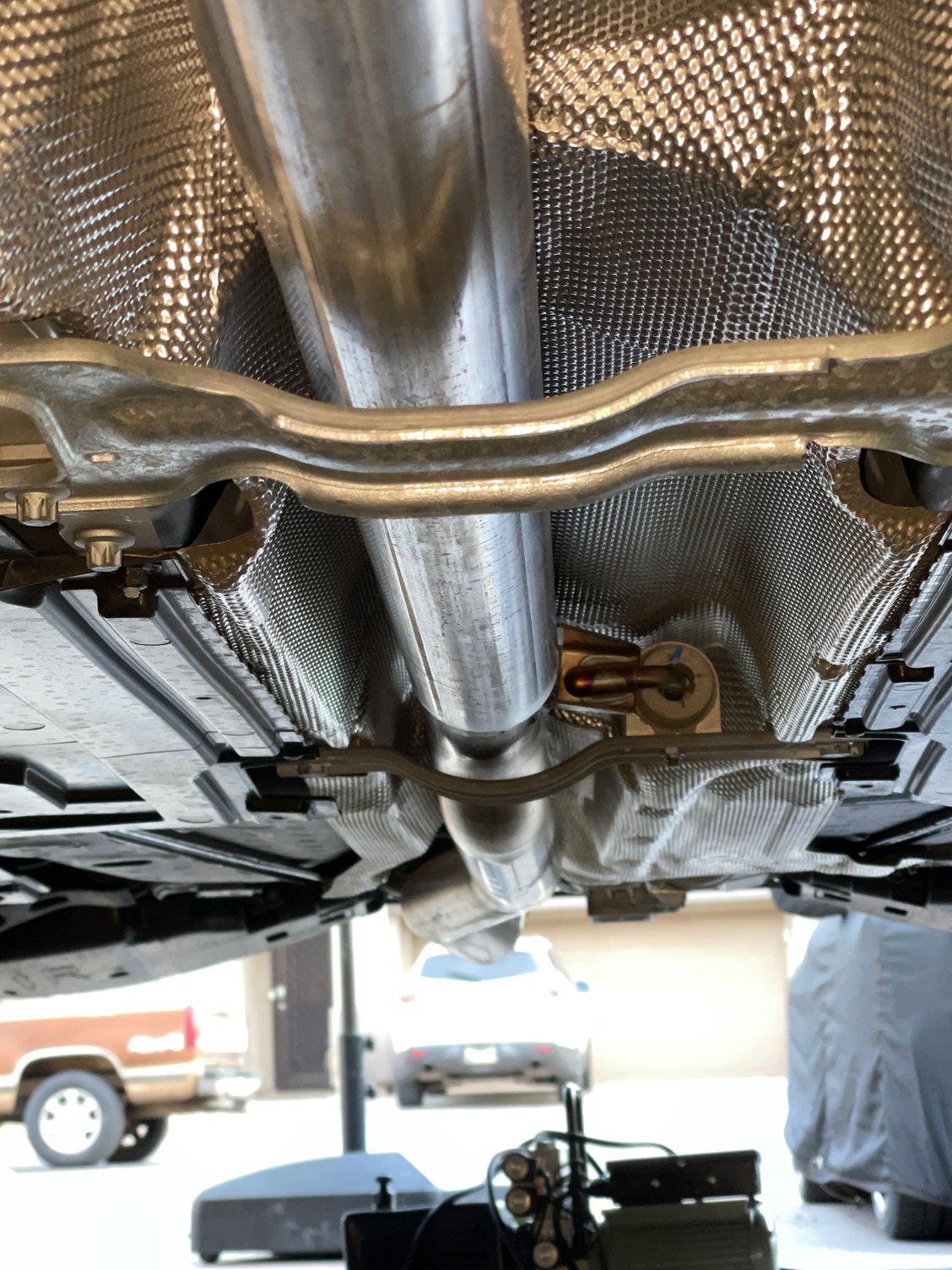

Glad I found your post here, new member/new car -- 2024 AMG GLB 35, purchased January 2025. Within days of making the purchase and having already found and saved your post here about the mods in Melbourne, I took my car to trusted local shop and immediately had the front (smaller) muffler and resonator removed (cat back). I figured I would try this before tackling the rear larger muffler (that thing's huge).
Three weeks later now and I am super happy with the sound, the pops/crackles, and the more visceral sound and attitude of the GLB 35. I have not noticed any droning or other unwanted sounds so I think (at least for now, for this year) I'm super happy. (Note too, for clarification, I also didn't do anything to the OEM valve motor / control unit.)
Again, thanks for the post and insight, photos, videos -- made me a believer.

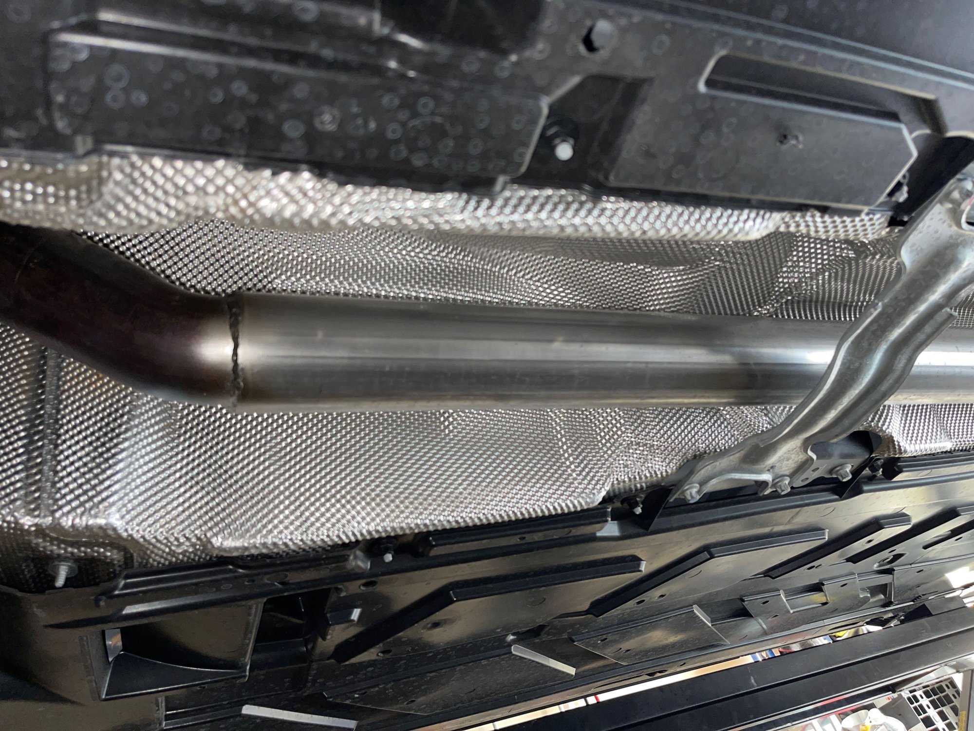

I've also had the mid box deleted on mine. Mine is an EU model so it has an OPF filter in the front, instead of a mid box and a resonator.
Deleting the mid box brought out some pops and bang on downshift (above 3500 rpm), but the overall volume didn't increase at all.
The OPF and the rear box are restrictive enough to kill most of the fun, not to mention that the valve stays closed when I'm under ~3000 rpm.
I will soon get a full cat back exhaust soon with aftermarket valves. There are plenty of well knowns exhaust brands making systems for the GLB but they are honestly ridiculously expensive. I will get a cheap system from China first (400 dollars + shipping), and if I'm not happy with it, then I'll get a Capristo of FI exhaust system, but I wouldn't really want to fork out 6000+ dollars for some basic tubes and two valves...
Huge OPF that kills most of the sound
Deleted mid box
