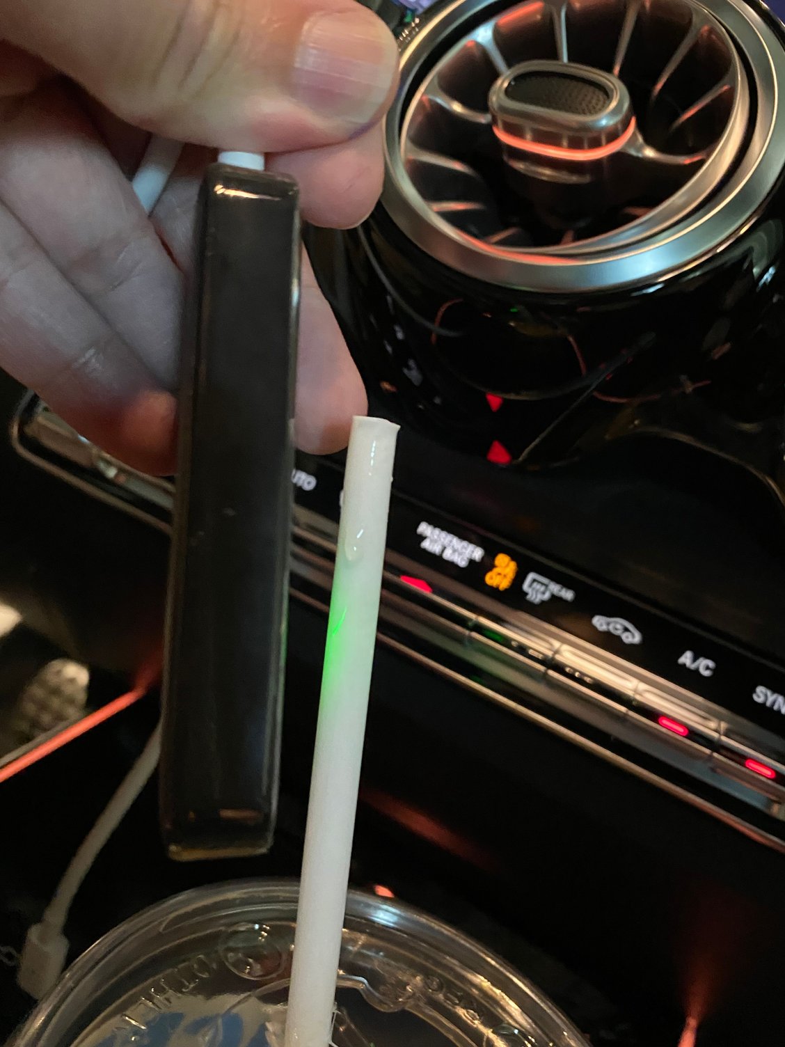

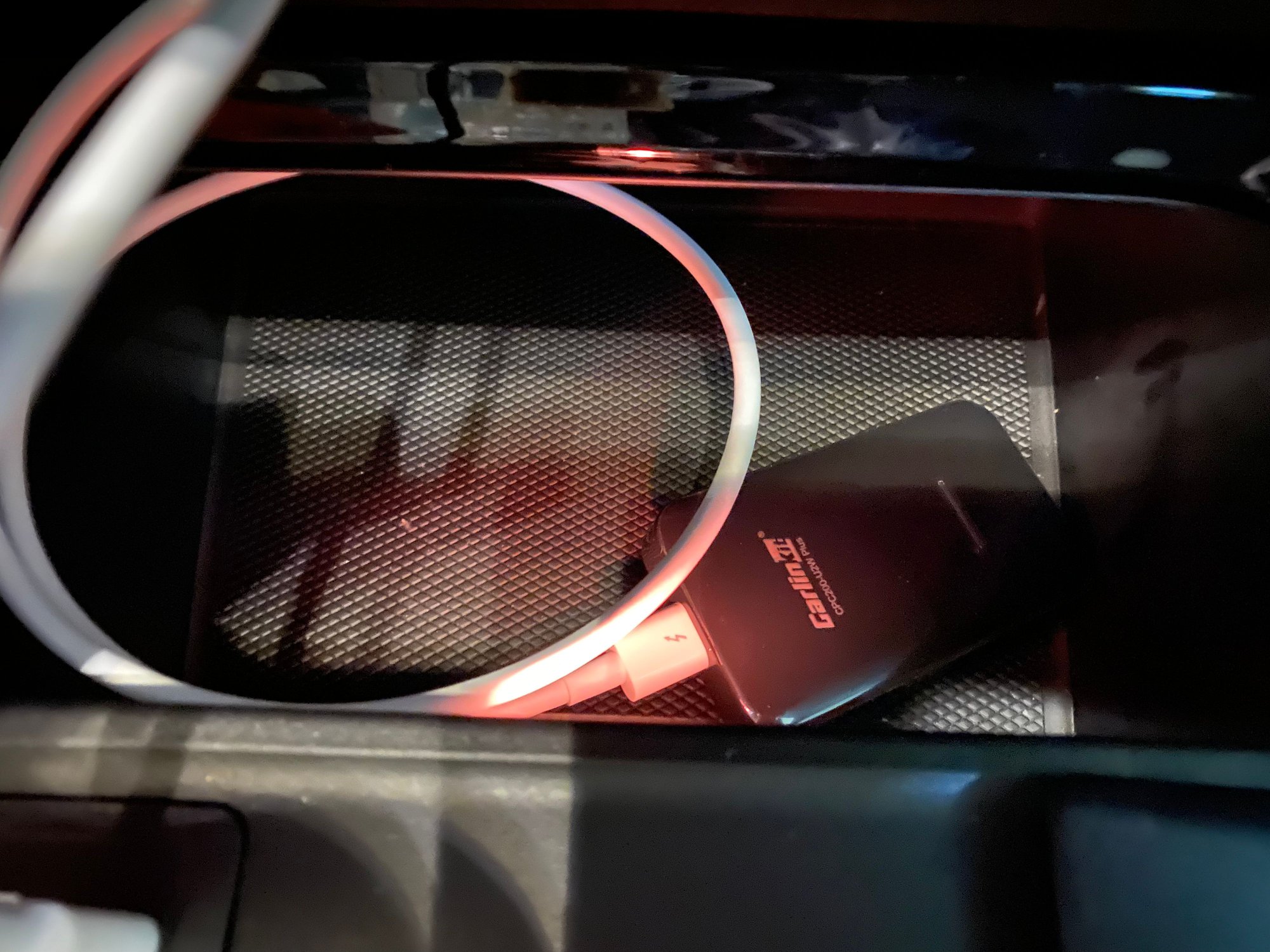

Hi everybody, I just got got my GLB35 and bought the Carlinkit 3.0 (2021-Present). It works fine, though it is slightly sluggish, but isn't a deal-breaker for me. I personally like it because my phone is untethered.
The unit itself is surprisingly small and with a bit of creativity, you could possibly hide it (maybe under a wireless charger?). I made no updates to the units and it worked right out of the box. Turning off the car and getting back in after running errands works fine too.
Notes
The USB-C port on the module is the one that goes to the USB port of the head unit. I'm unsure if anyone else has USB-C on their vehicles, but I would suggest investing in USB-C male-to-male wires. Moreover, a conventional "charging" wire won't cut it. A traditional charging cable lacks wires a sync or data cable has. Usually, your phone cables are both sync and charge. At the moment, I'm using a spare thunderbolt 3 cable (USB-C) to make the connection between the module to the head unit.
Moreover, the larger USB-A connector that's situated on the bottom of the module is used for connecting your phone to update the firmware. I'm unsure if WiFi is required as the instructions say to turn on WiFi after connection via Bluetooth.
Link for Product:
Amazon.com: 2021 CarlinKit Wireless CarPlay Dongle 3.0 Adapter U2W (Type C Design) for Factory Wired CarPlay Cars, Wireless CarPlay Adapter for iOS Version,Fit The Car from 2021 : Electronics Amazon.com: 2021 CarlinKit Wireless CarPlay Dongle 3.0 Adapter U2W (Type C Design) for Factory Wired CarPlay Cars, Wireless CarPlay Adapter for iOS Version,Fit The Car from 2021 : Electronics
P.S., I'll post pictures later, or if anyone requests it.

Old Oct 6, 2021 | 10:03 AM
NTR_Tags's Avatar
Joined: Oct 2021
Posts: 13
GLB 35
Yes, I have it sitting in the tray where the wireless charger would be if it came with the option.
I have some right angle USB C adapters so and a flat wire coming in so I could make it look cleaner.
My idea is to retrofit a wireless charger (any flat one) and 3D print a bracket that would fit snug in the tray with the Carlinkit module sitting below it. I think I should be able to snake the wire to the center console storage to supply power to the wireless charger. I’ll update once I find a solution.
In my head.. why have wireless car play when you’re going to charge with a wire anyway. So hopefully I can start taking measurements. If any, I’ll just use the cigarette lighter as a power source for the wireless charger.
Here are some pics of the product.
