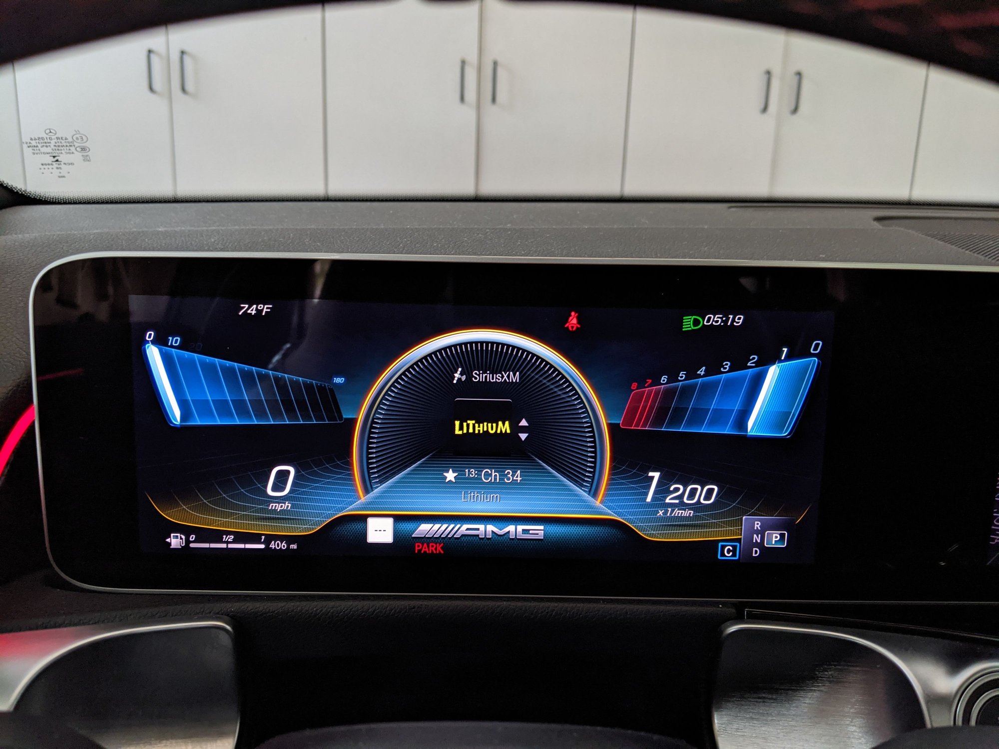

Hi All -
While looking at GLB35 youtube reviews, i realized the AMG logo was displayed on the lower center between the speedometer and rpms. I am wondering if your digital display is is showing the AMG logo in that area?
For some reason, mine is missing, so not sure if that is a option that is included in any packages, or maybe omitted since I don't have nav in the car?
Also, I noticed there as a "supersport" design for the instrument cluster. Upon selecting that design, the instrument cluster light up like a Christmas tree, and everything keeps blinking.
I am guessing the "supersport" will be reserved for the GLB45 at some point
Any feedback would be greatly appreciated.

Here's a pic of my dashboard. The AMG logo is there on the bottom.

Thank you! I actually took the car into the dealer today for the usual check engine light. (Car was left on during fueling for delivery) Apparently my car was shipped with the standard GLB250 software coding. They updated the file to the correct software and all fixed now!
