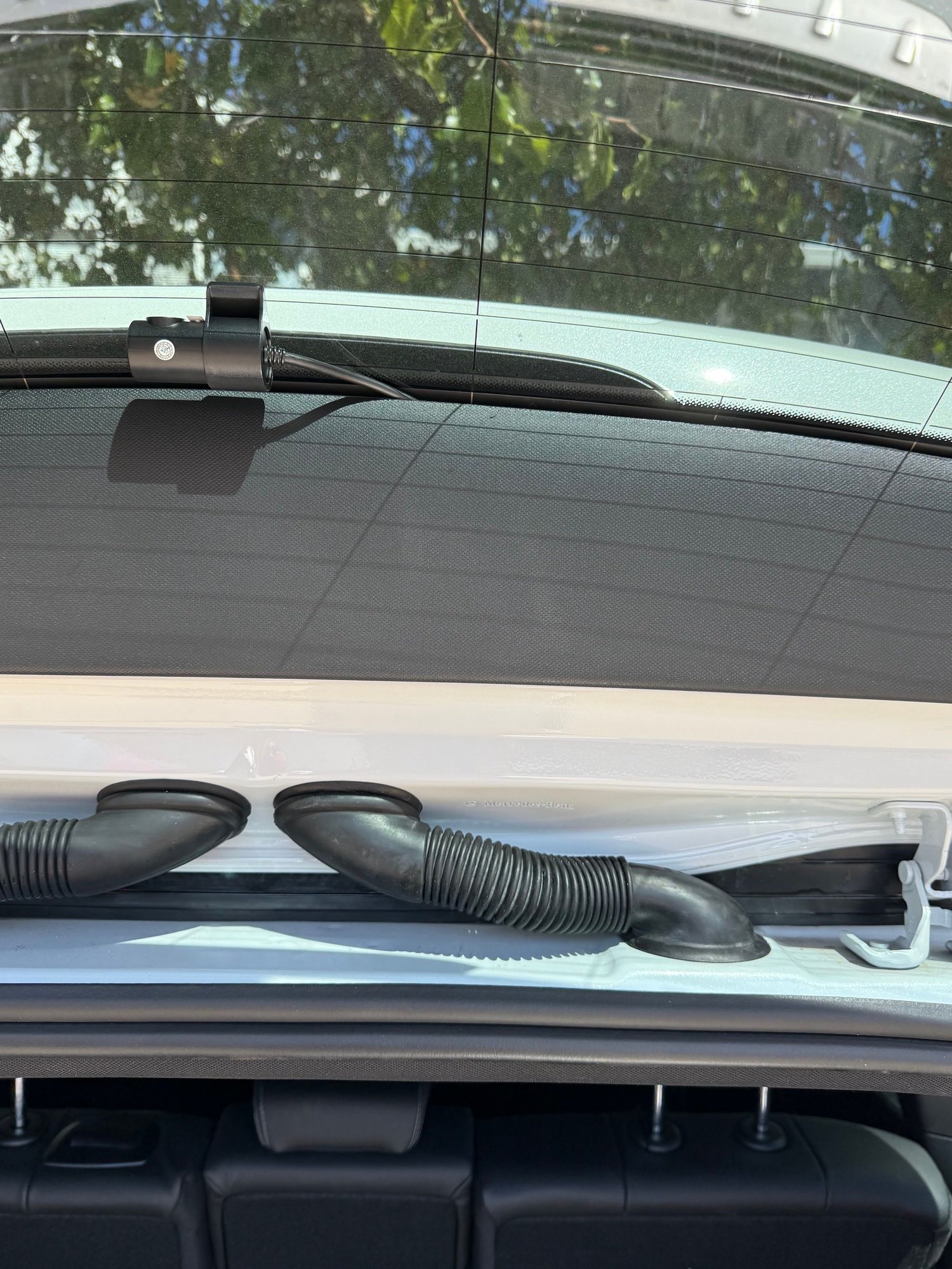

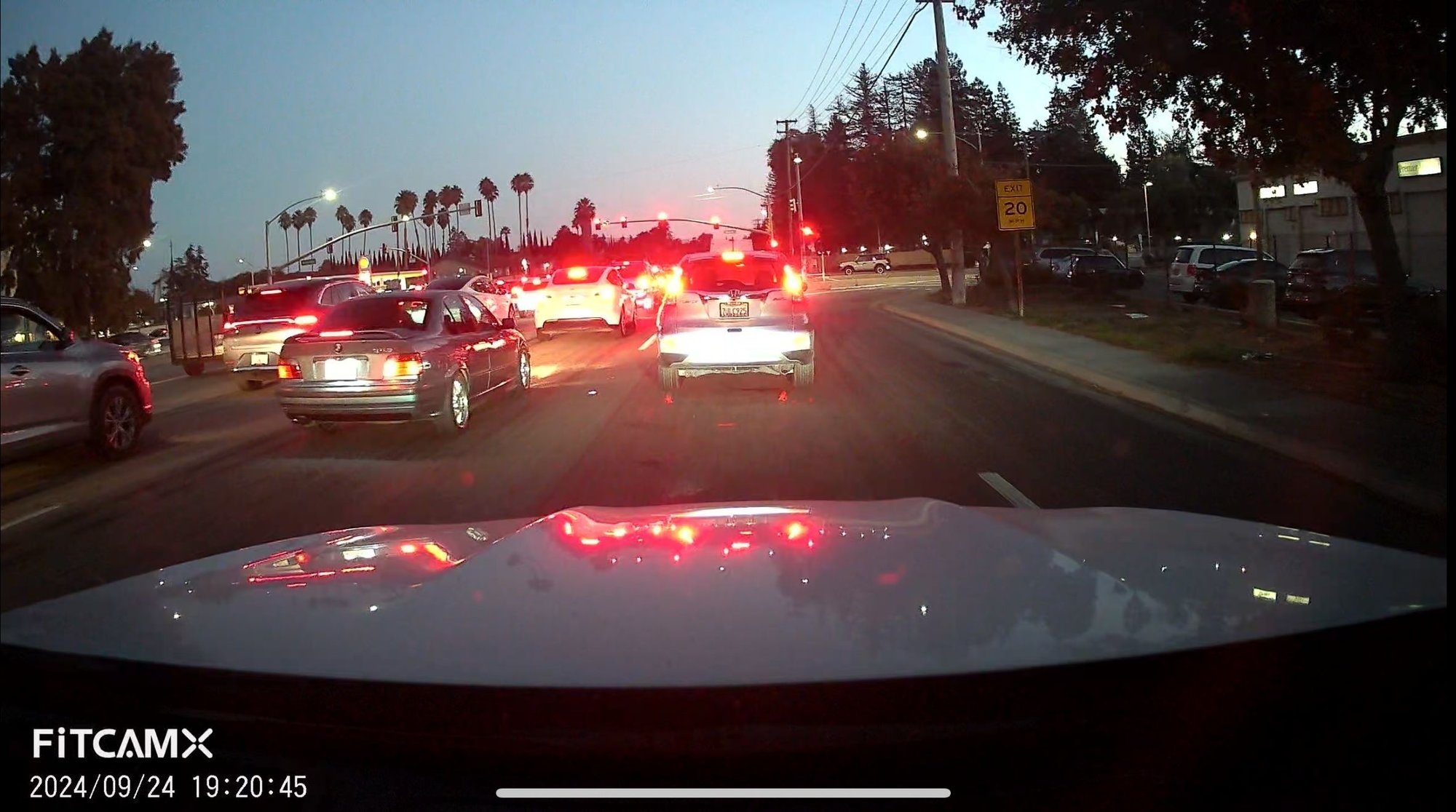

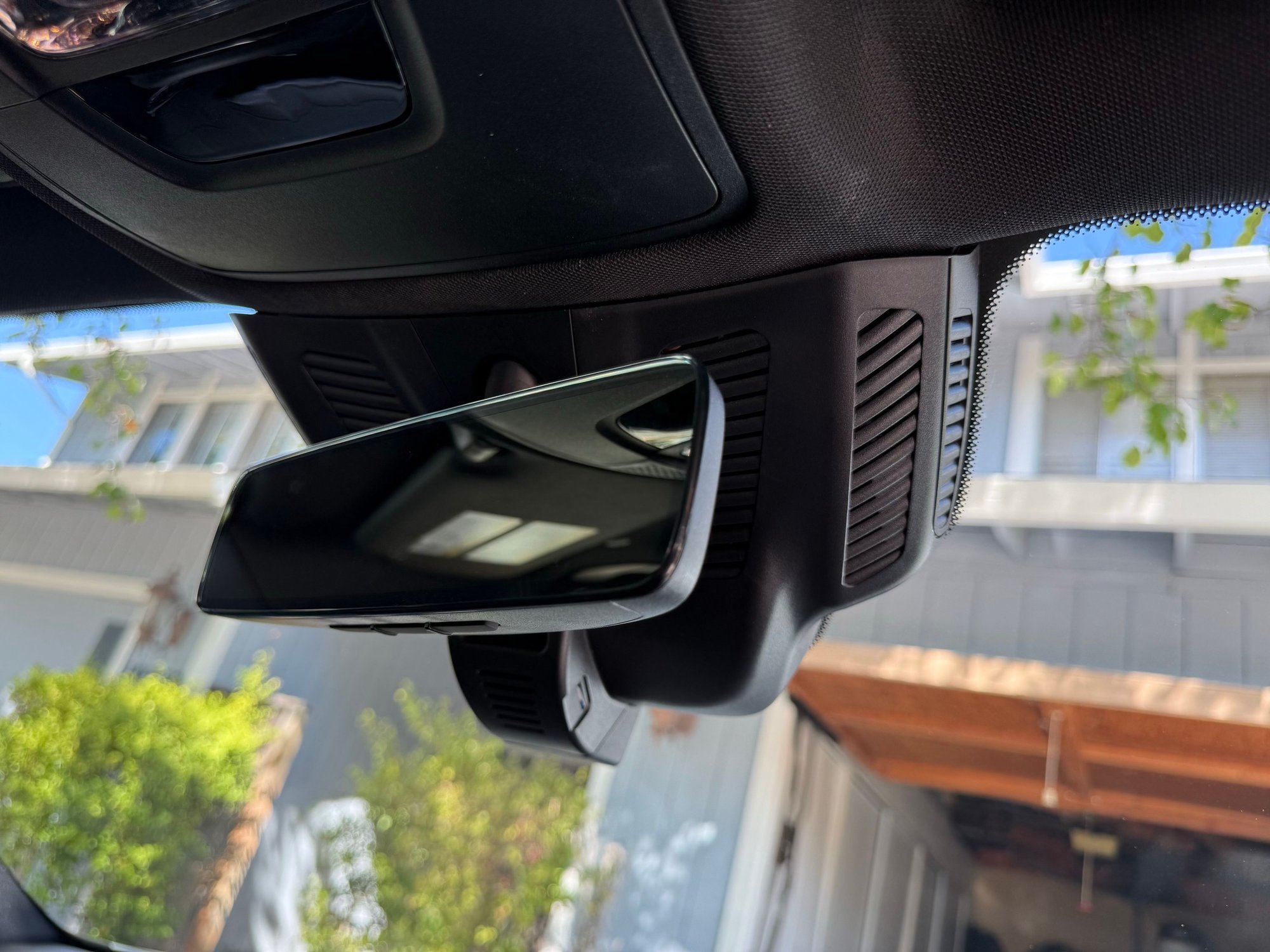

I also installed FitcamX on my 2024 GLB35. Installation was easy if you use a rain sensor in the rear view mirror compartment. To take advantage of a sudden recording(such as a car hitting you), you need to connect BAT+ and ACC from a fuse box.
After wiring, you'll need to pay attention to ugly wires attached to the front and the rear cam. I needed to open top and side panels to tuck them in. I hardly notice an additional cam nor wires exist right under the rear view mirror.
I found an issue that rear cam was not recording sometimes and contacted a support. After updating the latest firmware, everything was resolved. I recommend the product.
front at dusk
Rear cam wiring
Front cam wiring
