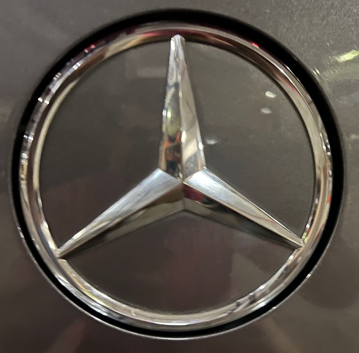

I went about doing a simple DIY fix. The first thing I noticed was that the cover with the MB Star logo was a little bit off center (pic below). So I thought it could be that when the cover opens, it may touch or foul with the housing or body and cause the noise.
Rear Camera cover with Star Logo

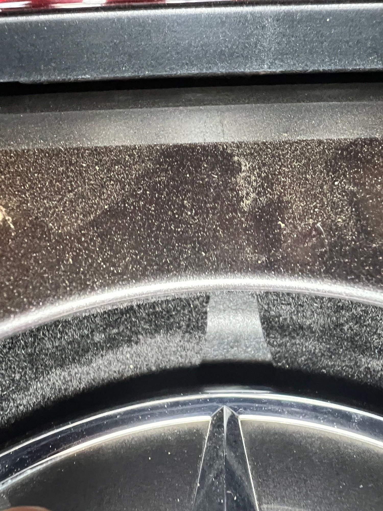

Then I tried to figure out the rear Camera operates. There is an internal plastic cover over the actual camera that is actuated by a motor, and when it opens, the internal plastic cover also pushes out the external camera cover. Seems pretty straightforward - see the first couple of seconds of this video:
Rear camera motor operation

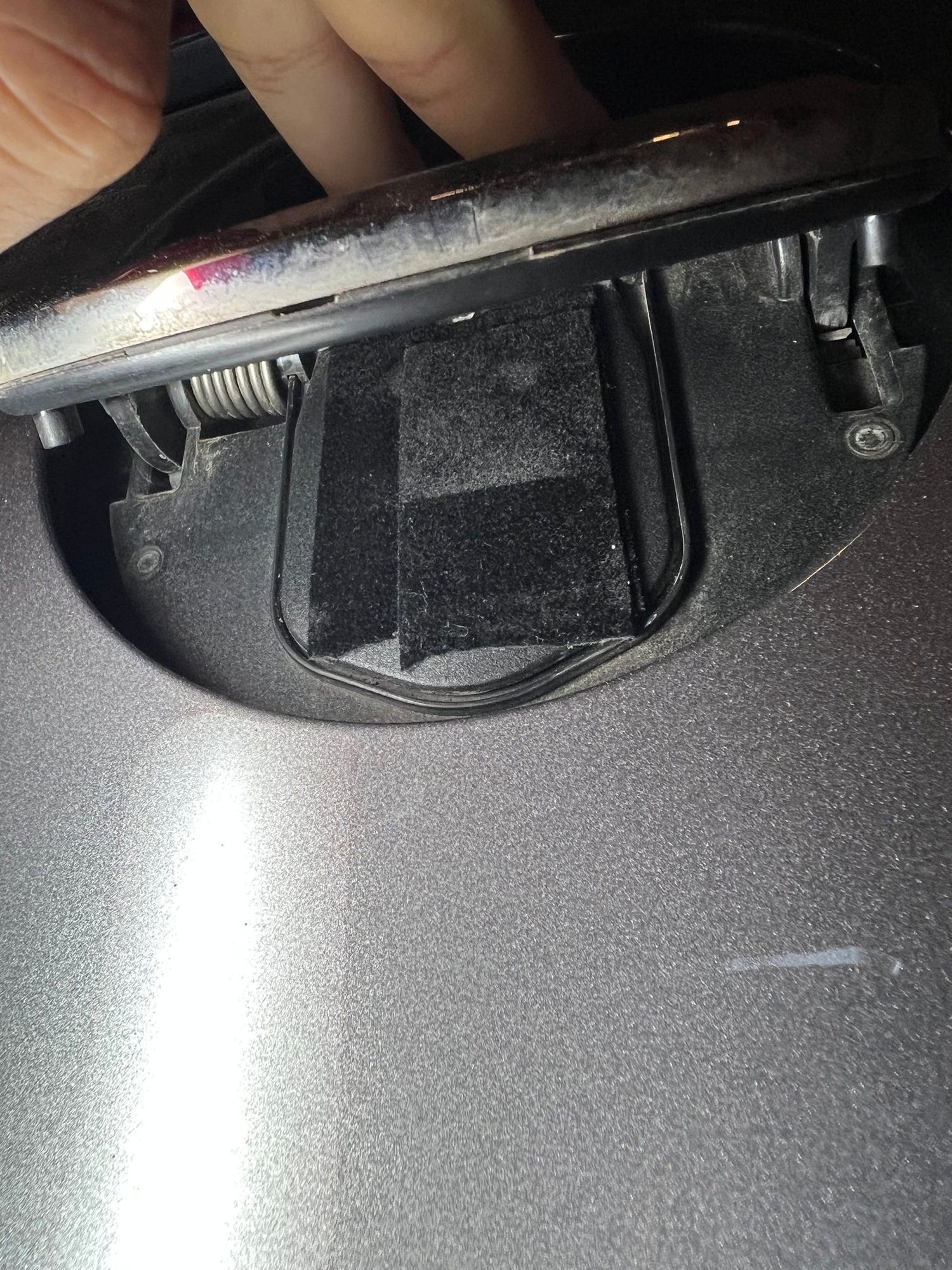

So I figured it could be that the internal camera cover fouls with the external camera cover and causes the noise, I had some felt lining lying around that I had picked up from Amazon
(no affiliation:
Felt Lining Felt Lining
) to line the bottle holder area and glovebox. I applied 2 layers to the internal camera cover. Be sure to not have the car keys on you when you push the boot opening cover so that the boot does not open as you go through with the repair.
Next I also found that the top of the external cover is very close to the internal housing where it is supposed to go in. So I also applied the felt lining on the top of the housing to cushion the impact in case the cover could hit the housing when the car body would flex. This requires a bit of patience as the felt lining is flimsy and won't go in easily inside the small gap. So I only took of part of the backing paper and used a thin spudger tool to push it inside before taking off the rest of the backing paper and pushing it against the top of the housing.
Took the car out for a drive. Was pleasantly surprised with the results and also that such a simple fix could eliminate most of the noise. You could still hear the noise sometimes over the larger bumps though. Here is my summary of the fix using a simple QnA. YMMV.

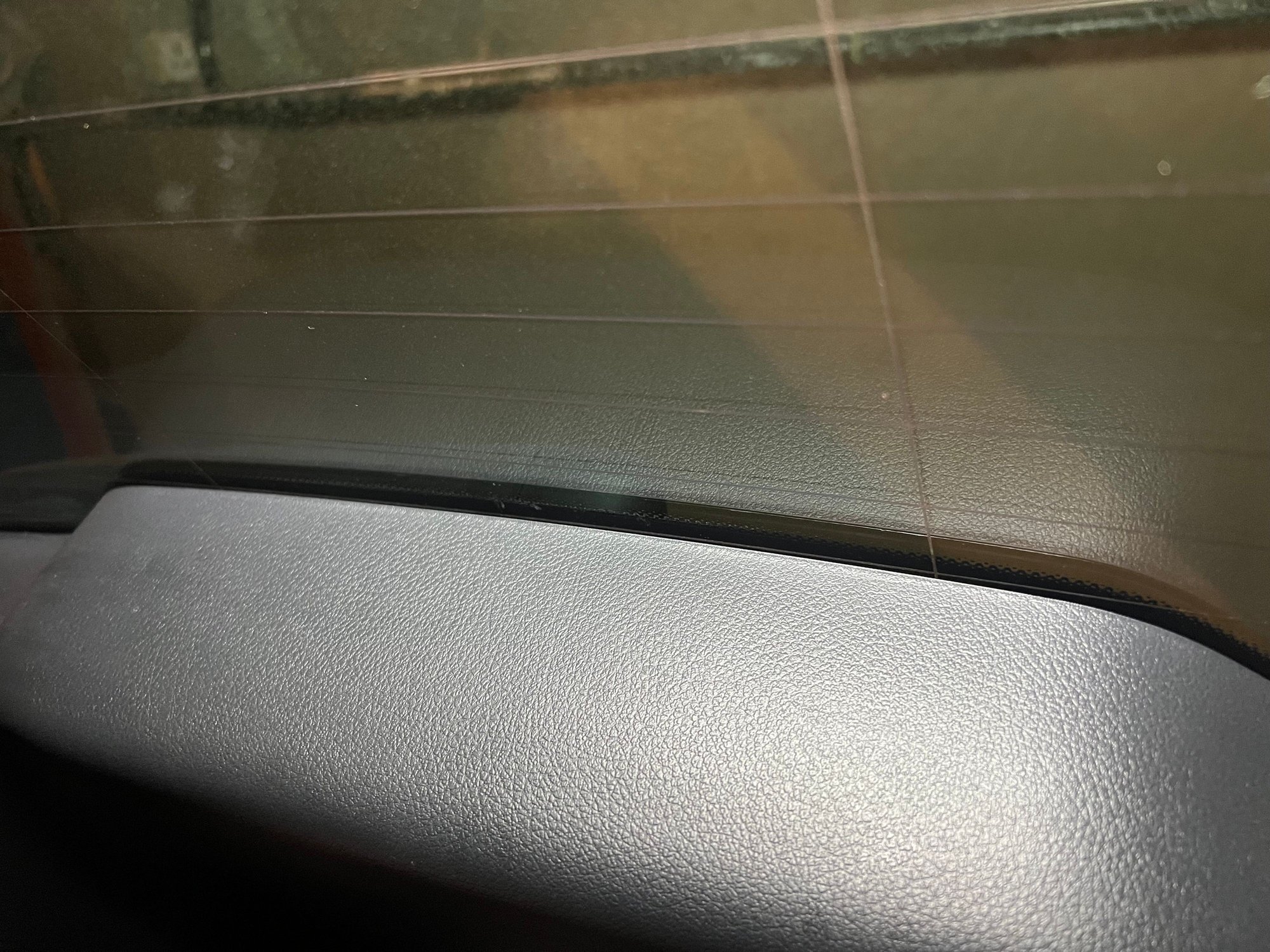

In my effort at eliminating the camera noise completely, I was trying to figure out how the camera flap opening noise is filtering inside the cabin, and I noticed that there is 4-5 mm gap between the top of trim panel (behind where the rear wiper is located) and the glass. You can just run your fingers along the trim and check this. Thats likely one of the areas from where the camera noise might be coming inside the cabin. Is this the same for all GLBs or only my car? If it is just mine, then I will try and get it rectified from the dealership.
