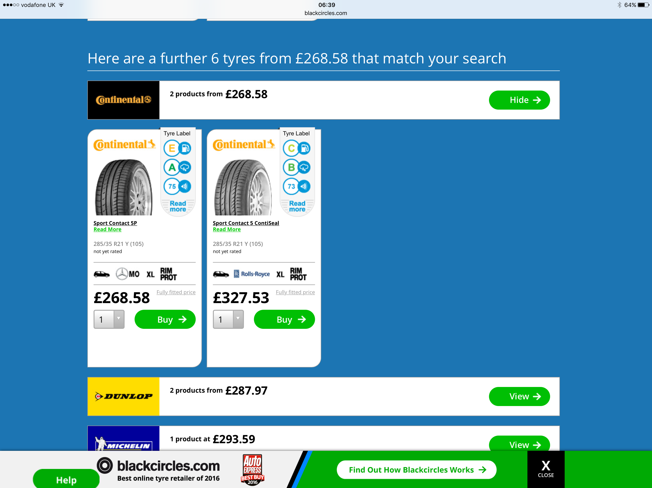

@Teckno - in this particular search the 'BMW' tyres showed up as Rolls Royce. You can see the label differences.
Attached Thumbnails Seeking advice on alternative tyres and wheels-img_0001.png

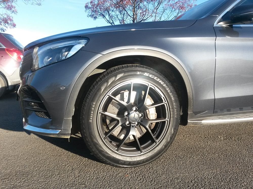

I made the trip up the Hume Highway to Tempe Tyres today, and came away with these 19" wheels and some Pirelli Scorpion Verde non-runflat tyres, for somewhat less that the price of just 4 OEM 20" tyres from my local MB dealer:
http://www.tempetyres.com.au/wheel-f...20Y463%20Black
Attached are some shots taken en route home. As you can see, they're badged for MB, and even come with a small AMG plate on the rim, which is a bit hard to see in these shots.
The initial impressions were good, other than they'd been inflated to around 40psi. Why do they do that? Speaking of which, do the same tyre recommendations hold for these 19" non-runflats as for the 20" runflats?
Now the puzzle. If you read that link for the wheels, you'll see that those wheels come in an ET35 and ET38 fitment. As the MB documentation shows, the 19" MB wheels are an ET38 fitment. So you can imagine my surprise when I glanced at the receipt on the seat next to me as I was driving away, and noticed that it said ET35. So I stopped at the next opportunity (not easy on the M5) and called. I was told that it's normal for after-market wheels to have a slightly smaller fitment. Who am I to argue? This is all new to me and these guys are the professionals. The wheels seem to fit and run ok.
But having driven 3+ hours home, I now can see that those wheels come in both fitments, and I can't help wondering whether I was given the wrong one in error. I'll call again in the morning, but I expect the same answer and it's a long way there and back again just to argue.

I like them, I think they look good!
+1
i like them too.

Thanks for the positive affirmation for my selection (I only had a choice of two), but the question remains ... why the 35 rather than the 38? I'm going to sleep on it.

I am a noob when it comes to tire and wheel offsets but I've read somewhere and it mentioned as long as it's within 5mm offset, then you're okay.
I would trust the the tire shop.

Great looking wheels - similar to GLC63.
On offset, I think 3 cm is not a big issue although why they didn't stick with ET38 is curious.
Suggest you do some full locks on the front just to check rubbing/clearances.
i think you meant "3mm"", as 3 cm is quite an offset.
