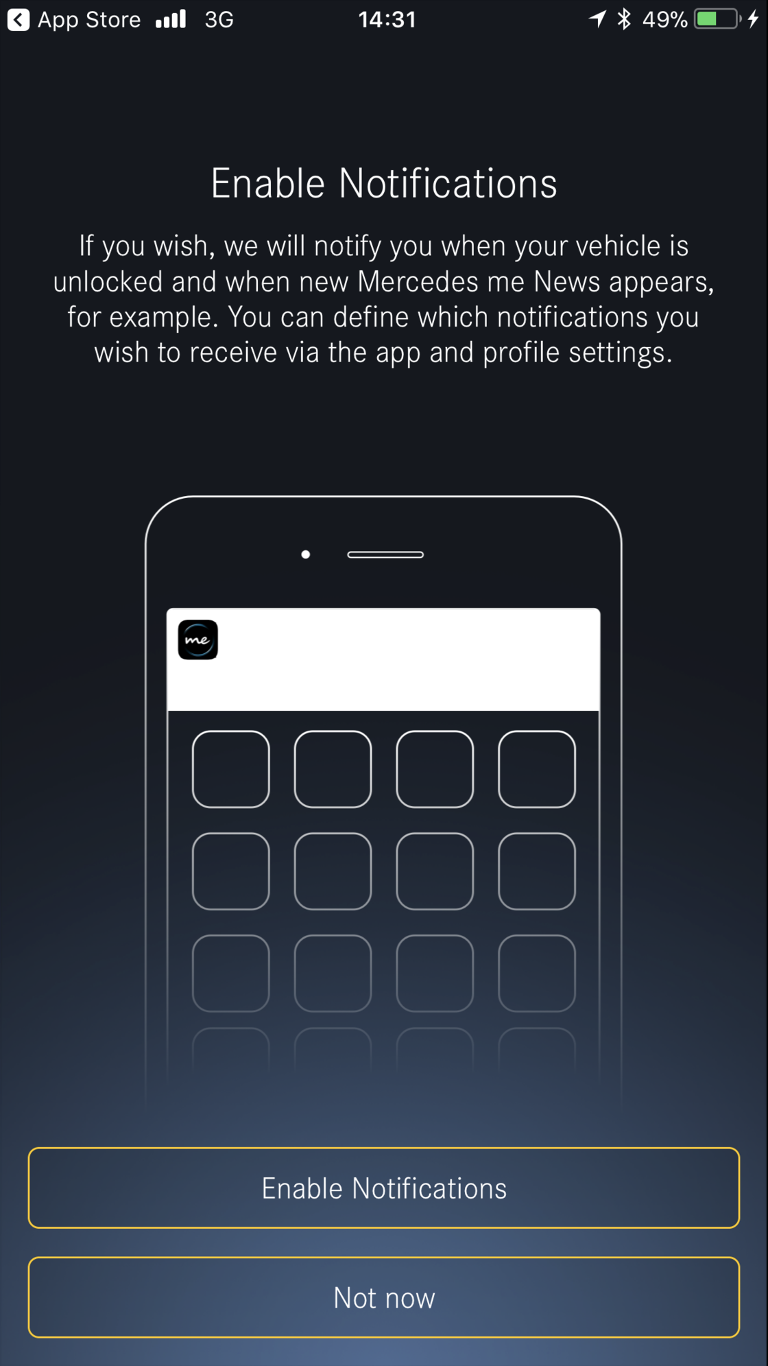

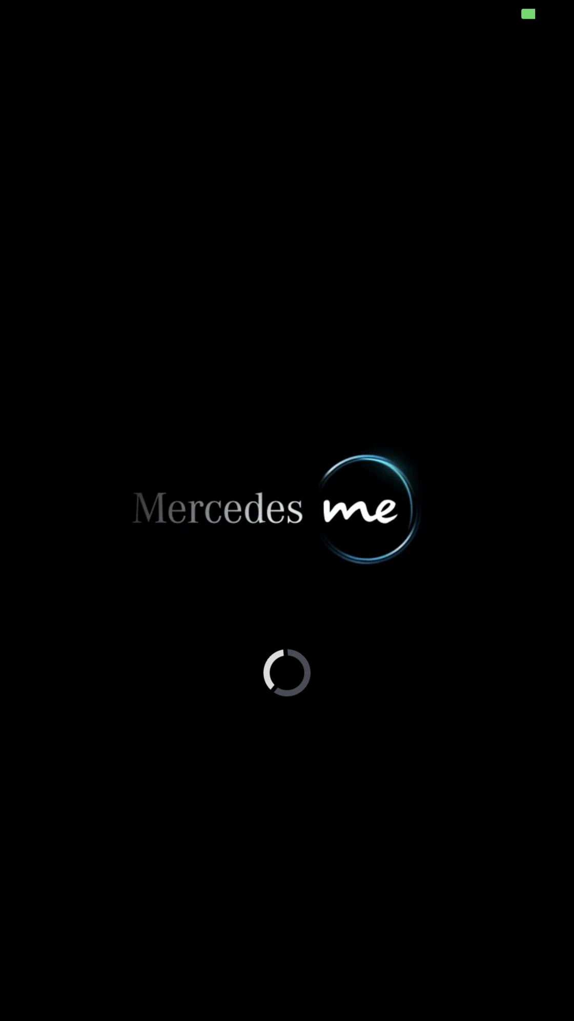

Mercedes me is driving me mad. It was working great until yesterday and now the app is appalling. I have deleted and reinstalled about 20 times and can get to log in but then it just won’t open. I have tried on 3 phones and it’s the same on all of them.
The portal is working on the laptop so it isn’t that. I have sent an email to mercedes but no reply yet. Is anyone else having trouble opening the app? I briefly managed to get it working last night and it asked to authorise the app on the comand screen which I have. When I open the app it sticks on the attached two screens. I have emailed Mercedes but not sure what help they can give really.
Frustrating isn’t the word.

Yep, mine does the same on my iphone 7...
You may have the same problem I had with MM on my iPhone SE. I was told to delete it so that my recent CPO purchase could "verify", and then reinstall it. Well, after deleting it, MM would not reinstall. I would get the blue circle which would eventually fill in all the way and then nothing. I discovered that the app hadn't actually deleted. The icon was gone, but the app still was on my phone. Go to Settings/General/Storage & iCloud Usage/Manage Storage and wait until all the apps load up. Scroll down to MM, tap on it to get the next screen. You should see the option to Delete App in red. Delete it, return to your home screen. I did a hard reset, after which I was able to download the app, successfully log in, and all worked well after that.
