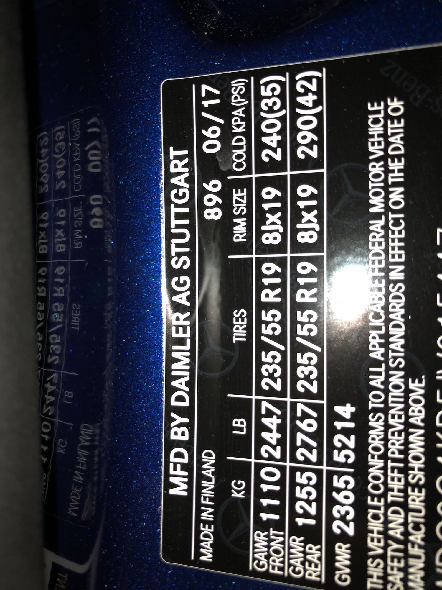

Originally Posted by Nicklause Wong
Hi thank you for you reply and insight, do you mind sharing what does your sticker say?
Above is the one on the door frame. I have 19s. Made in Finland!
Fuel door sticker. It shows the various wheel sizes available for the GLC along with regular load and maximum loads pressures for each. AMG will vary.

Originally Posted by zhenyaf
I inflated mine to the specs on the sticker that is on the driver door jab (20" wheels, 35psi front, 42psi rear)
Those are not normal duty recommended pressures. As described above, the door jamb placard shows only the "Maximum Load" pressures, which is what you should use only if driving with a full load of passengers and cargo. The ride quality will be poor if you use those pressures in day-to-day driving, especially in hot weather. The recommended pressures for your vehicle are 32 all around. From what I've seen on this forum, most drivers run 32 or slightly higher.
