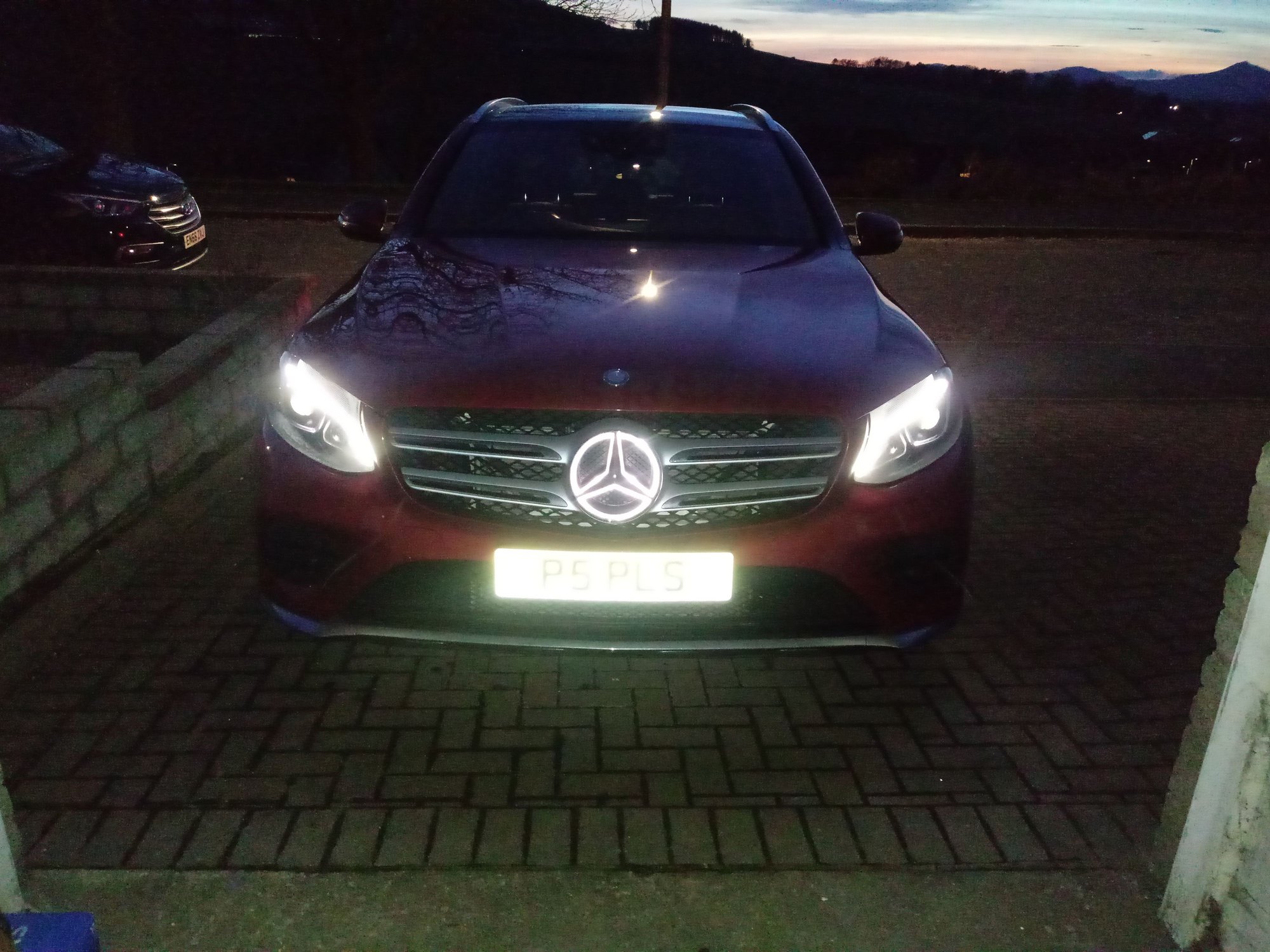

Old Jan 2, 2020 | 06:09 AM
Bomber 209's Avatar
Joined: Jul 2019
Posts: 17
GLC 250d AMG Line X253
linus69, Thanks for your post with Illuminated Star fitting ideas.I got one for Christmas, and is now fitted and lit with ignition 'ON' Really looks the part.
