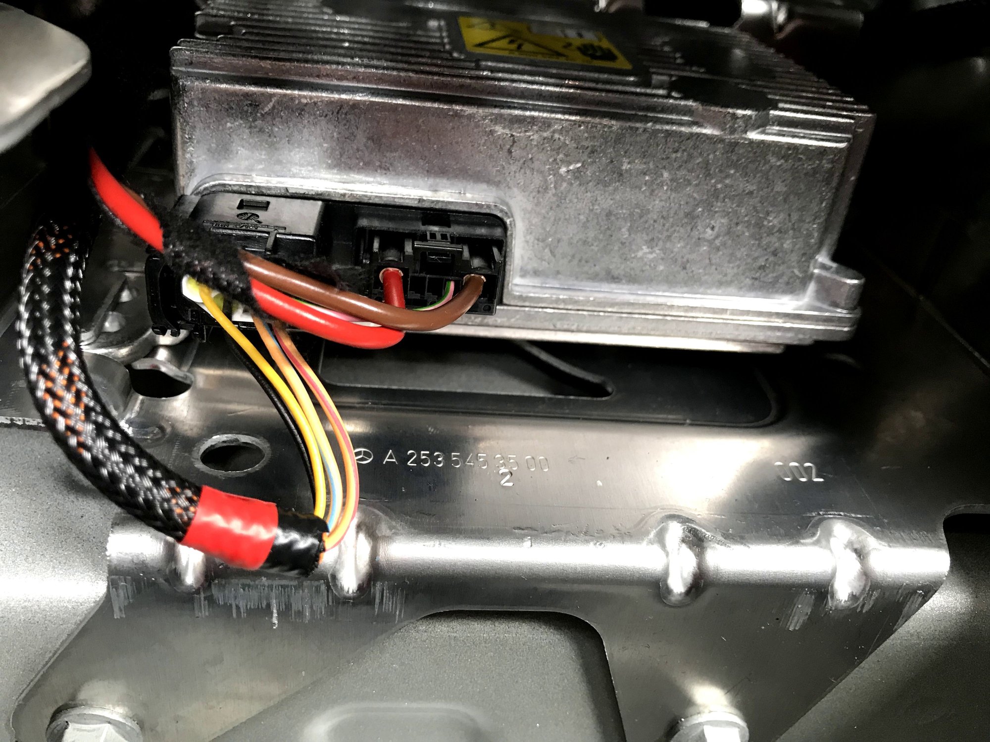

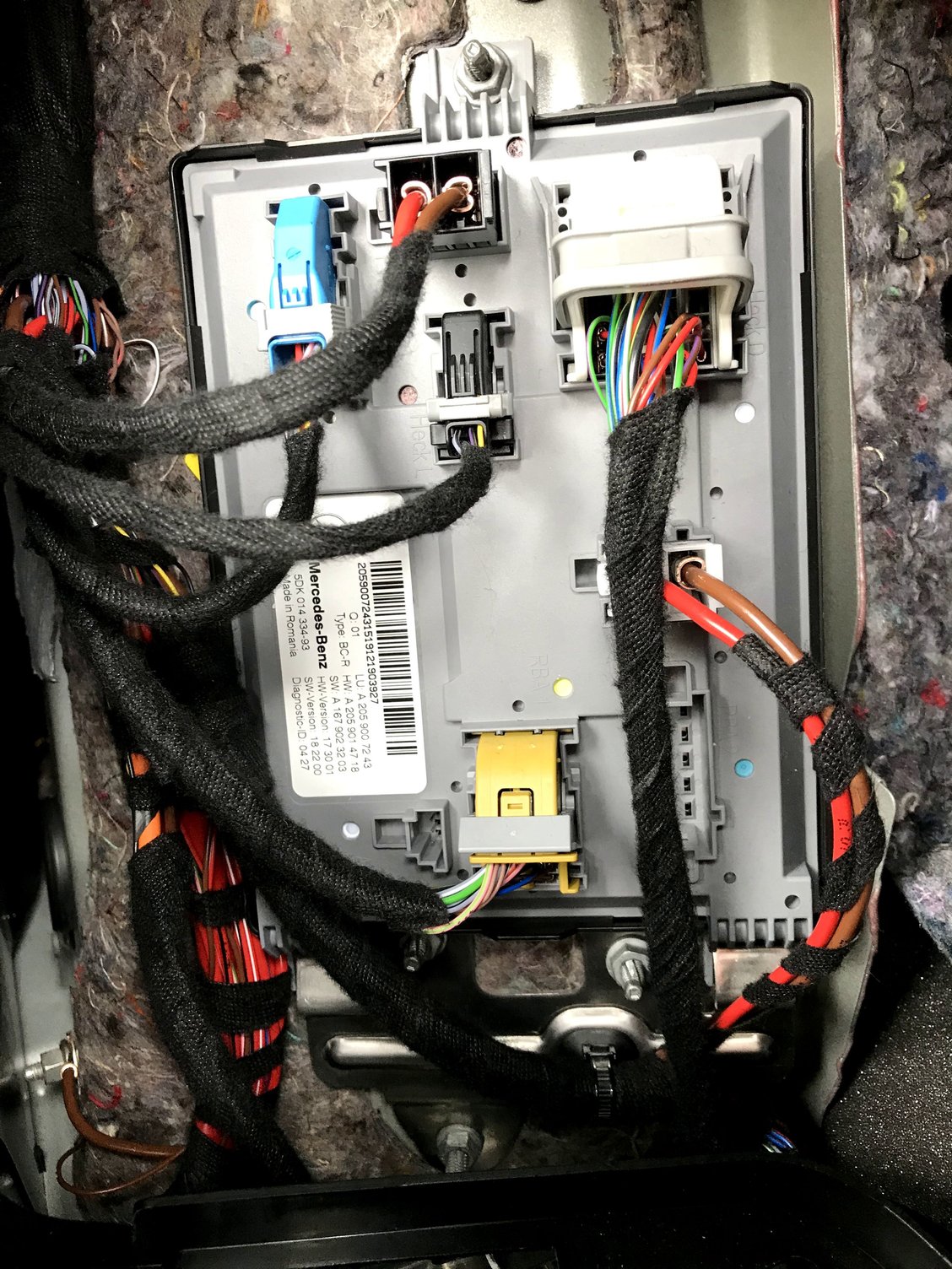

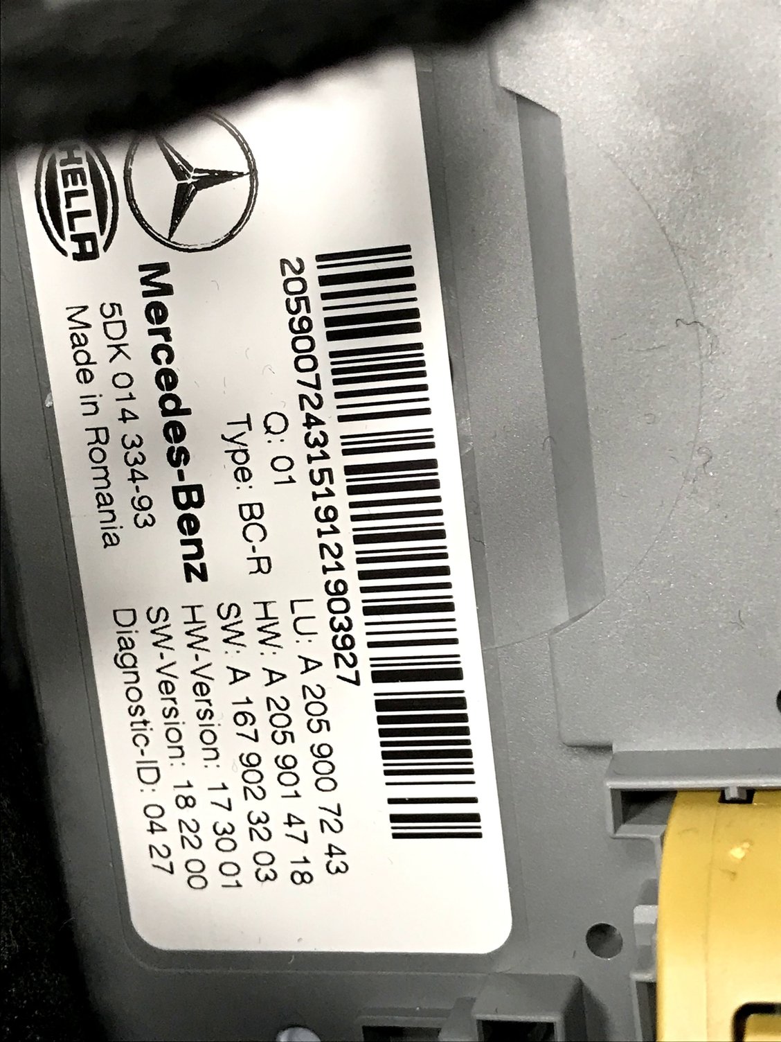

Thanks. I've attached 4 pdf files of photos I took. You can see 1726 which is a close up of the label on 1728. Photo 1728 shows the board on the side where stuff plugs in. There is at least 1 unused jack down to the left by the yellow connector. 1729 is a close up of the part number for the metal frame holding the amp, and the open space below the amp as shown in 1730. That's where I'm assuming the SDAR unit would go. But if you have satellite, you'll be the one to know. Thanks for your help.
Wiring harness panel in passenger side rear well.
