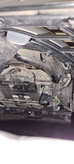

been there, done all and frustrated that nothing worked to budge it. finally i came to conclusion that the star is stuck with a sensor box (Check the attached) that u need to remove the whole grill to reach and remove the star. that sensor box is related to cruise control and active brake assist (so even if you dont have distronic u still have the sensor box). this has changed from previous models who had these sensors in bumber or under the front windshield mirror.
hope this helps and let me know once u remove as i want to remove myself and install the illuminated star. so far, everyone is saying cannot be done without affecting the sensors.

that is 100% right. ive been there as well and snapped several pics of the sensor box, wanted to install an illuminated star and all is saying it will affect the sensors.

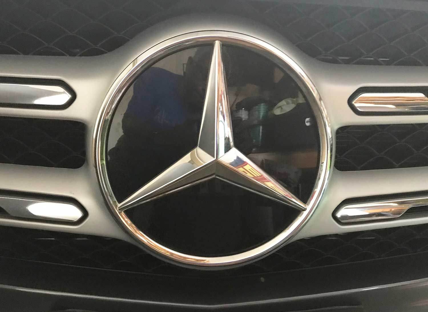

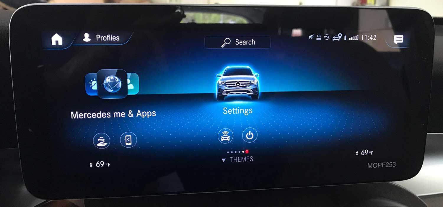

I believe that wesram is correct. In my 2021 GLC-300, the specified sensor box is in an assembly that is part of the MB star whose background is a glass surface, see Figure 1. My car does not have the Driver Assistance Package, but it does have "Active Brake Assist with Autonomous Emergency Braking and Rear Cross Traffic Alert". You can verify that you have this by going into the car's "Settings/Assistance" menu as shown in attached Figures 2 and 3. My guess is that these sensors need to be able to "see" thru the star, hence the use of the "Glass Star".

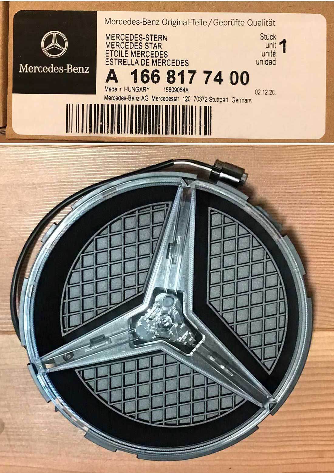

The "Illuminated Star" (PN 166-817-74-00) as shown in Figure 4 has a solid plastic background surface. As such, I would doubt that you can replace the "Glass Star" with the "Illuminated Star" and not completely mess up the functionality behind these sensors.
